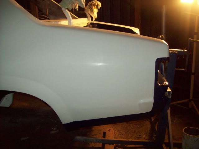

Did a car restoration course at TAFE at night, and shite, part of it was oxy welding. Turned out when shown how I was quite good at it, so went and did a Welding and Thermal Cutting Course after that!!! That Car Restoration course was the best course I ever did. First part is a bit obscure (hub cap and wheel chock from sheet metal), but next bit is good (repairing chisel gashes to doors, patch panels to corners of doors, and panel preparation for paint).
You can do shite like this (was ready for the tip):
You'll also need some more tools: plenishing hammer, dolly, speedfile, bodyfile, mallet as starters.
Good luck with it.
