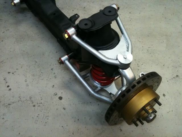

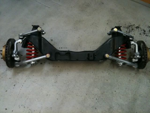

Hi guys a quick hi and thought i would share with you the new double wishbone tubular front end ive developed for LC-LJ Torries
Can be supplied with standard spring and shock, or coilover, or airbag, runs standard rack and any brake package
Hope you guys like it,
cheers Matt

Thanks mate, we put a heap of work and research into this and are wrapped with the results, we have 2 LC's in the shop right now getting these front ends and can als do them for any early holden, available in stainless too, Matt

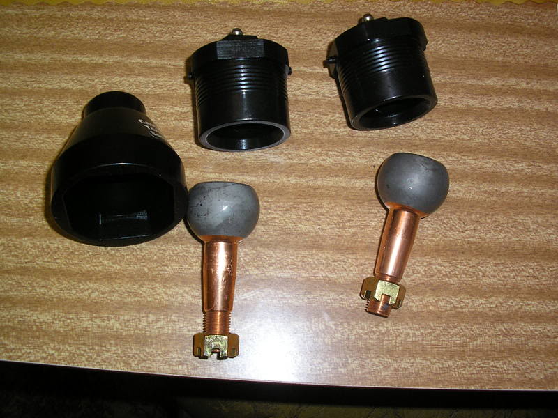

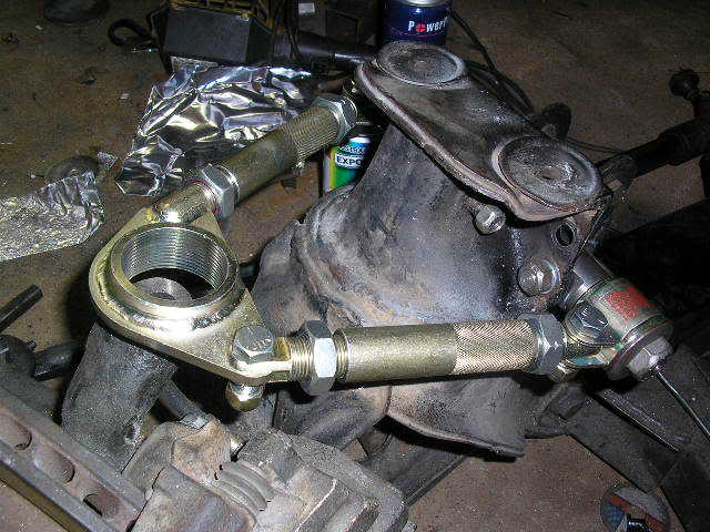

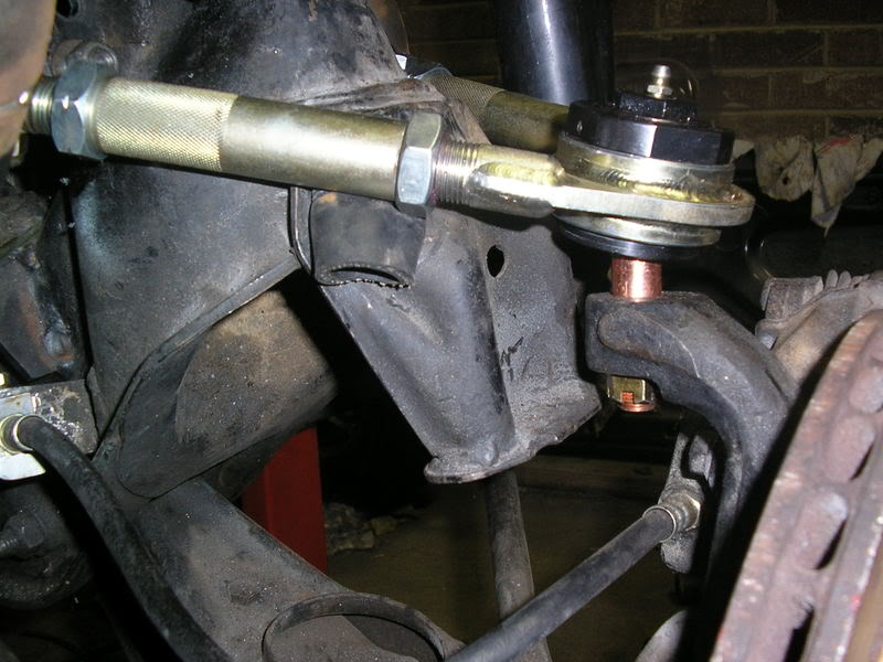

That looks great, with these top arms i reckon would be better.
Adjustable Chrysler screw in ball joints.

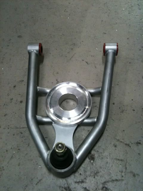

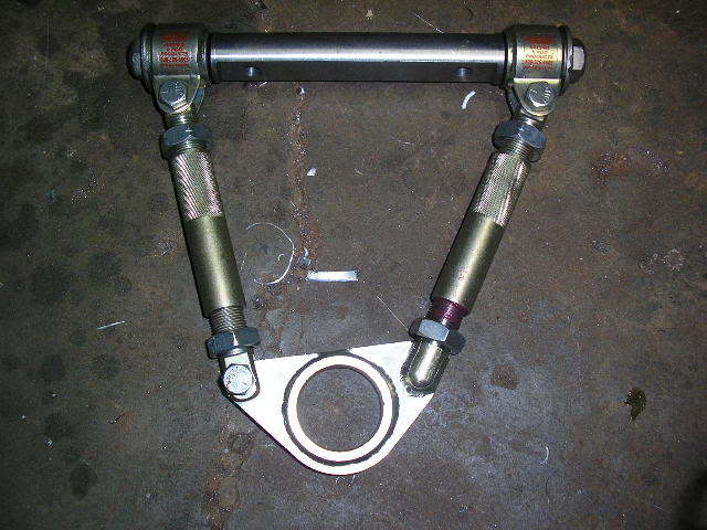

Nice looking arms, would not really match the bottoms though, also comes down to cost, my arms can be produced all in house and and well priced, utilising gemini ball joint, so cheap to replace, my bottom arms utilise HQ balljoint, would like to look into a high end arm though, i could make them, also comes down to what engineer would say, would be interesting to see the breaking point of them. cheers
Dont know about the breaking point, but they are designed for the big old US tanks, Chevs, Pontiacs, Camaro's etc

We are getting them tested at the minute, all looking good. They have great strength and design. They will require that you send me your crossmember, or I can source if required.
Alternatively we can fabricate a all new crossmember also, however I like retaining the original crossmember
Thanks Matt

Price will depend on end requirement.
Can you supply crossmember
Do you want Torana or HQ stub axles
What brake package, can run any size rotor and any caliper combo from Stock or Hq to 355 mm HSV
Mild steel or stainless arms
Spring or coil over.
At an indication the one pictured is around the $1500 mark with customer supplying crossmember, stubs, springs
Cheers Matt

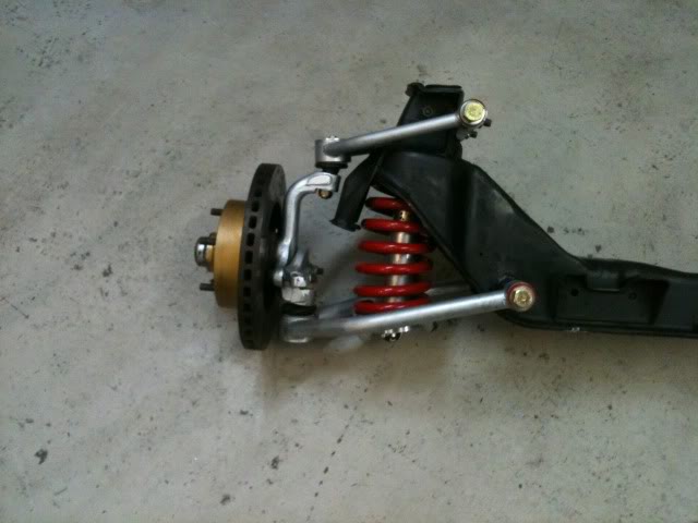

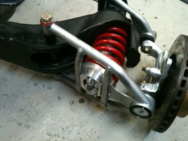

Just wondering if the caster rod is still used in this setup?

No caster rods used in this setup. That's the beauty of it. Frees up all that room too. Front end is secured with 4 19mm grade8 bolts, or can even be welded in

I would say the lowers would have less binding and better geometry since the caster rod is eliminated. And the arm it self would be stiffer under load.
