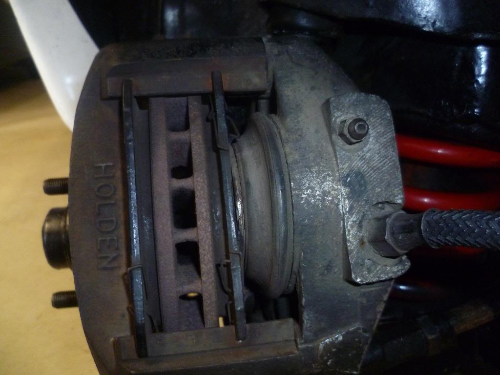

Ok This is Posted Imagewhat I have at Posted ImagePosted Imagethe moment.Posted Image
#22 _col_
_col_
Posted 16 July 2010 - 08:52 PM
Its the first time I have posted pics.I couldn't get the text Right but its a start.Are the calipers HQ?

Yes HX/HZ calipers, basically same as HQ. Also its hard to tell from the pics but it looks like the steering arms might already have a considerable amount of drop, might be worth identifying them before proceeding? Normally this type of caliper is used with the UC slide pin which has a recessed bolt head for better clearance (some of the UCs had the same caliper with a narrower pad carrier for the thinner solid Torana rotors). How closely does the tie rod follow the angle of the lower control arm?
The front mount sway bar is common to allow better clearance for extractors/exhaust which would normally foul on the standard rear mount one. Looks like the brackets to the lower arm have been installed upside down (note the angle of the link pin and bushes).

Thats a Torana caliper body (the alloy part) with a cast iron bracket from a HX
Very common conversion
Looks like HQ-WB stubs and discs too
Old style Kmac bar ?
Seen them a few times... though not a fan of the mounts
