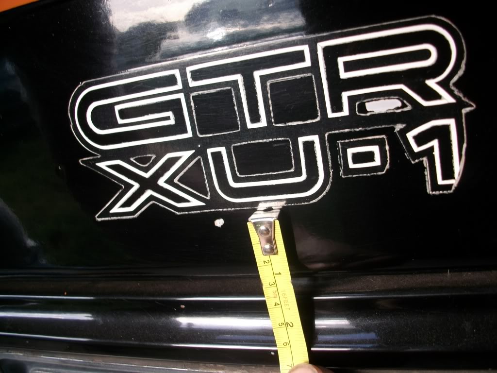

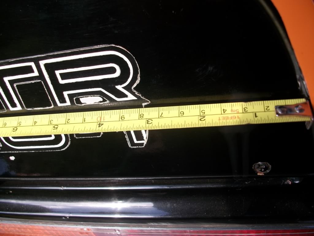

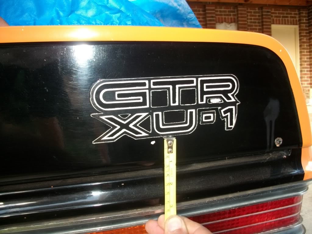

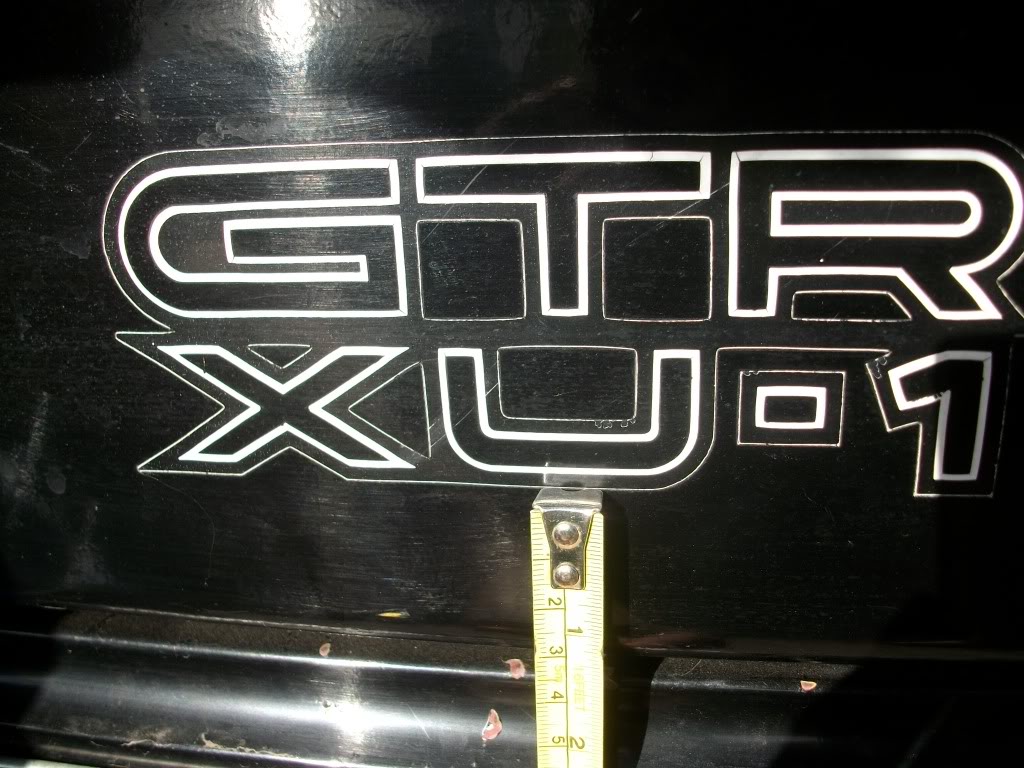

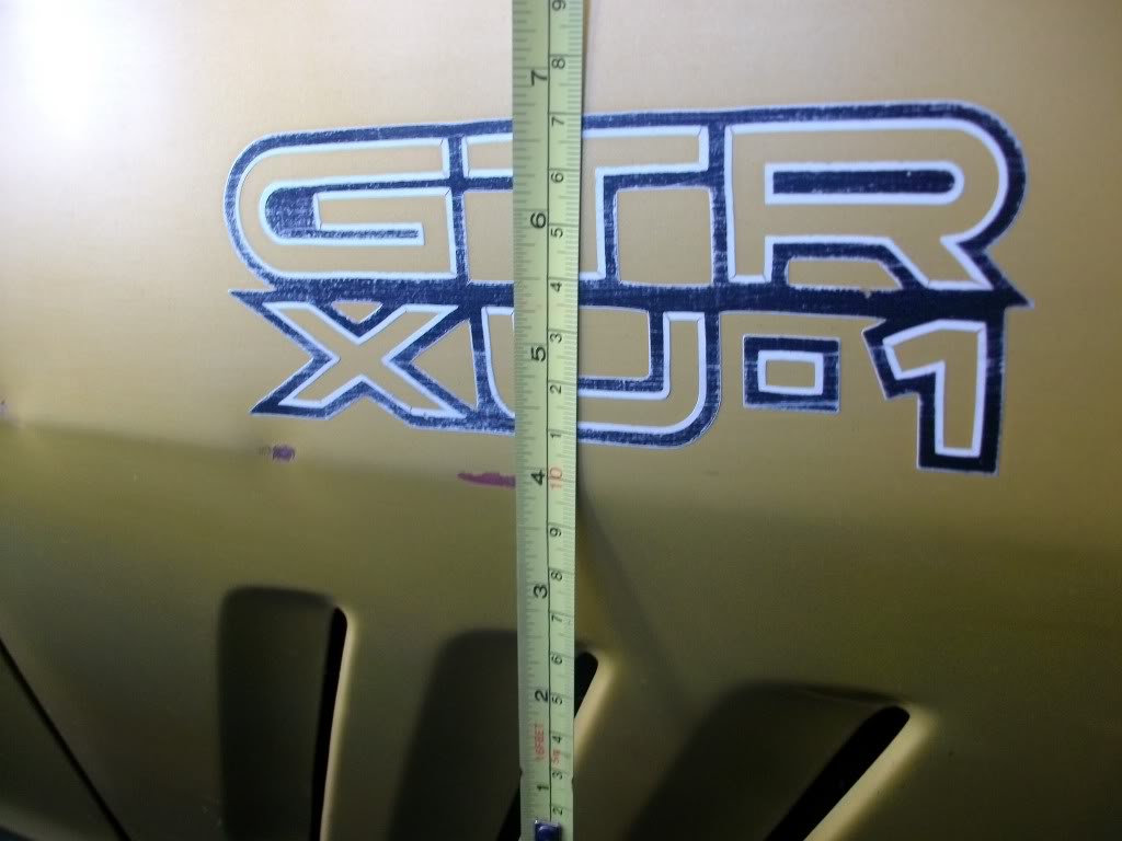

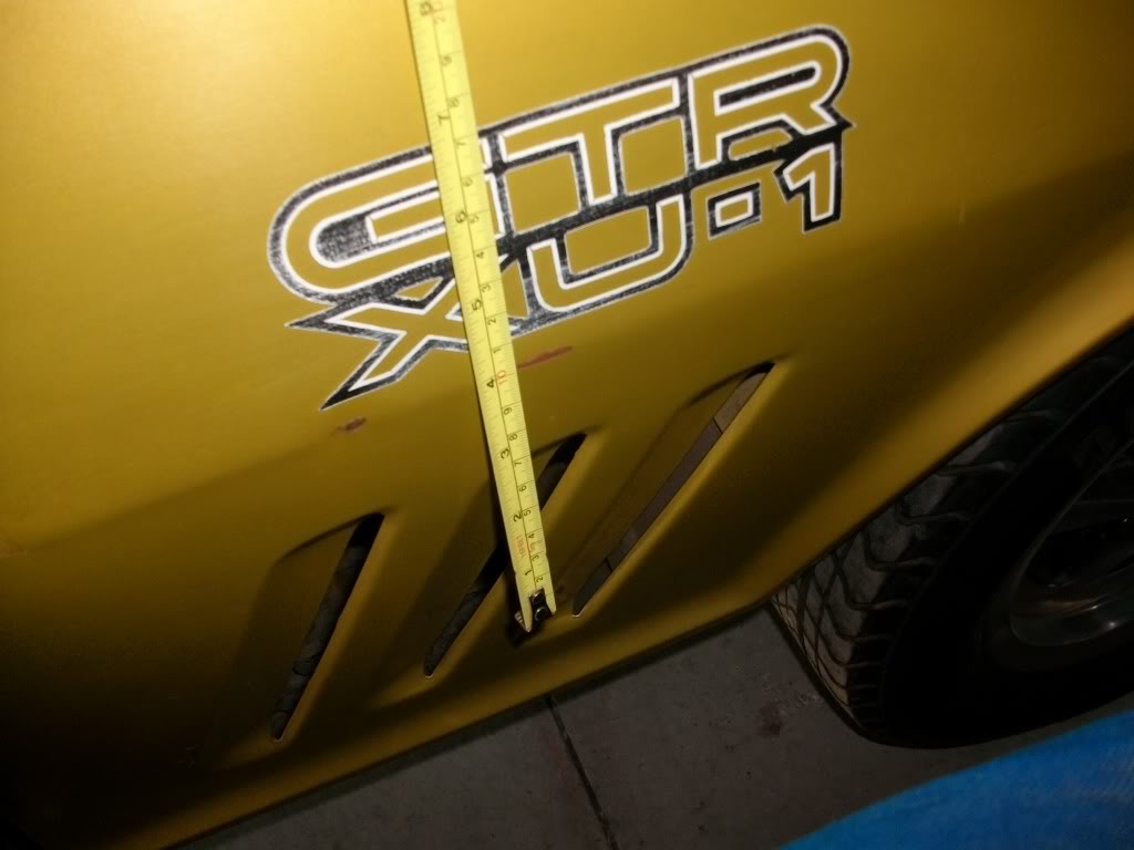

#20 _1973bathxu1_
_1973bathxu1_
Posted 25 October 2010 - 07:13 PM
Hi sorry about not getting the photos up yesterday as the camera leed got lost, so i picked a new memory card today,
these are the 2 unrestored xu1s, the photo of the lone o ranger is the LC bathurst 9/71 and the photo of the sunburst is the LJ 5/73 as u can see
i have put a tape measure so u can see for your self. even the rear bob tail sticker is placed differently from LC to LJ if you cant read the measurements
i will print them up for you,
Regards Aldo
#21 _Ozzie Picker_
_Ozzie Picker_
Posted 25 October 2010 - 07:21 PM
thanks aldo ,for taking the time to do this for us.
there is quiet a bit of difference between the 2 models,and i will be able to check mine now.
cheers craig.
