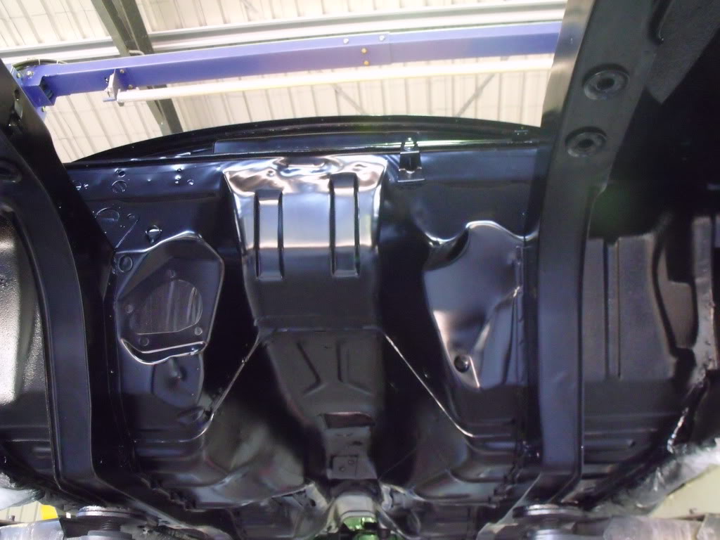

i must disagee 1 would be but joining them, i dont know if these pics of my 71 bathurst floor replacement will help, i have used a 73 full front floor, but it looks orsum
first of i bolted the new floor down then cut about 5mm inside it useing a 1mm cutting disc, then i hard butted them tak welded and the give em heaps of weld, just remember when you do your clean up, no one can see under your carpet so it dont matter if its alittle ruff but under your car you will need to do some grinding and prep work.
i hope these help.
mate i have got cars before that had the pans replaced the way you are talking of doing them and near always there is heaps of rust comming back.
cheers gong

Bathurst-32D, that last image of yours, the underside looks like a new car would (well better actually) is that the same LJ? Looks like a lot of work has gone into that. How much of it is new floor?
i hope these help.
cheers gong
Agree, that is amazing.
Three weeks seems worth it when the finish is like that.
