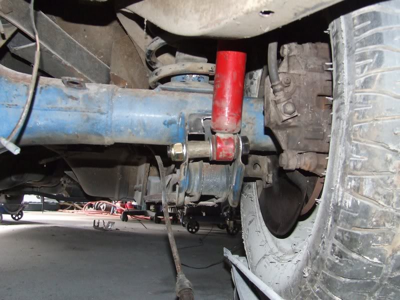

Dear Torana friends,
my new custom made 2 way adjustable coil over shocks arrived.

I hope you are doing custom rear shock mounts as that is a bad idea to use the original ones in single shear mode with the full spring weight on them.
There was some pics on here tha someone posted where they had modified the shock mount to a double shear arrangement - can't remember who did it to thie car.

Looks sweet but I too would be concerned about the lower mounts on the car, especially the front.

that is sort of what I meant - someone did it much better than that where it mounted up on top of the lower control arm mount rather than butcher the hell out of it like that. That one looks a bit backyard to me.

Personally I think moving the shock inboard could cause clearance issues between the shock and the body.

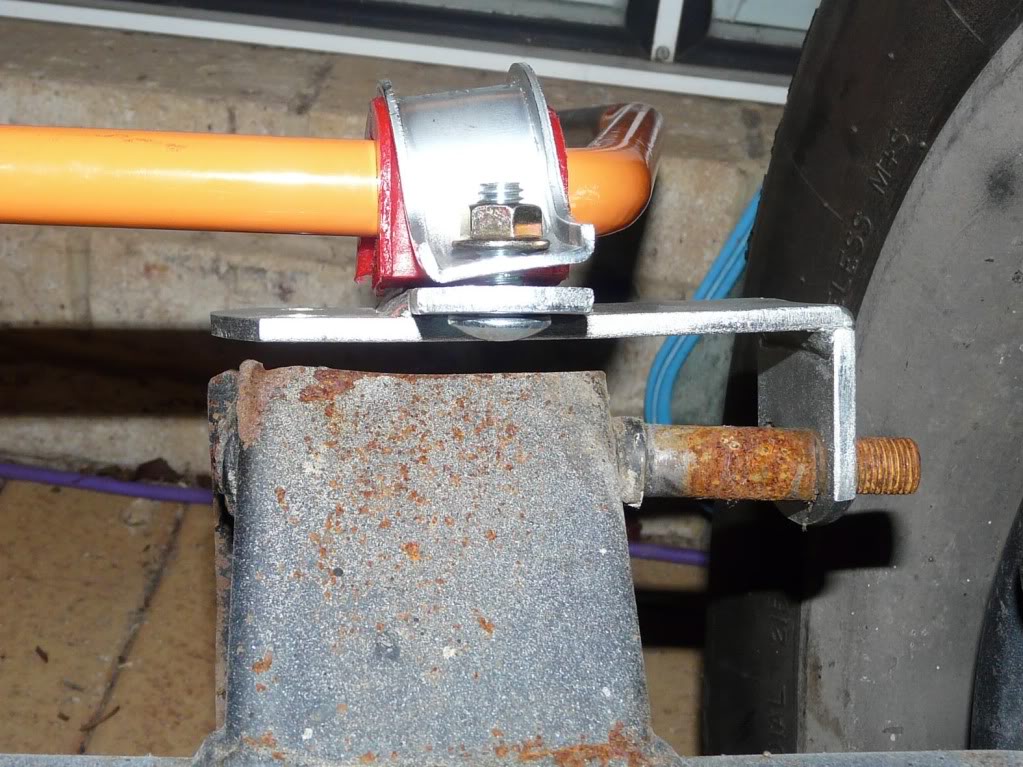

Maybe something based on the K-MAC swaybar mount design.
I had a plate welded on instead of using the K-MAC u-bolts.

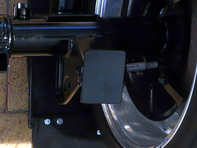

Yeah, that diff with the black shocks is the one I was thinking of. Much better - bolt nice and square too. Whos car doe that belong to?
Clearnace wise - one would have to check it out - hard to tell without trying it. Hopefully the top shock mount is also strong enough.

The BW diff with the Commodore style shock mount is youngy_11 from this thread.
