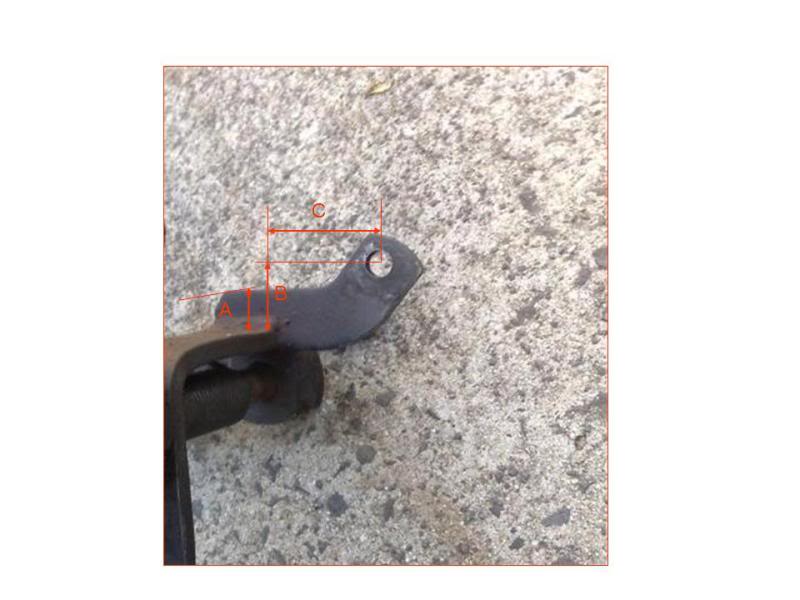

I need to convert a 6 cylinder clutch pedal to a V8 cable type clutch pedal (std V8 cable type). I am seeking help in identifing measurements I will need to manufacture the cable attachment bracket that it attached to the top of the clutch pedal assembly.
A - Measurement from the top of the pedal to the top edge of cable attachment bracket
B - Measurement from the top of the pedal to the centre of hole for clevis pin
C - Measurement from the centre of hole for clevis pin to leading edge of the top of the pedal

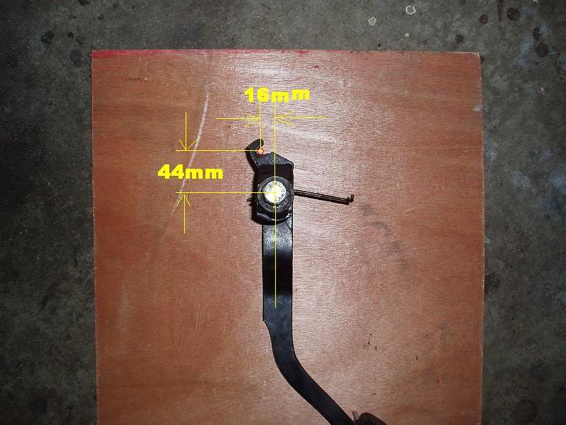

Posted 30 December 2010 - 04:58 PM
This is UC 6cyl with Aussie.

Use rodomo's picture & measurements & add 25mm to the hook height.
The offset is the same as the V8 pedal & please please do not cut up a genuine V8 pedal for the conversion !!

Hi John, I am going through this myself at present, I traced the arm off a genuine LH slr5000 to convert a 6 cylinder pedal, measurements as follows A 15mm, B 25mm, C 40mm I do not have the clevis dimensions nor access to them as this car had a hydraulic conversion and original cable and clevis long gone as was the relay assy on bellhousing,I am attempting to fabricate relay assy and clevises myself so any info or pics that people have would be great. Regards Pete.
Thanks Pete. Can I ask you for two more measurements?
1. The measurement for A again but this time from the top edge of the bracket that is parallel with the top of the pedal to the bottom edge of the bracket. Or the measurement from edge to edge of the bracket, passing through centre of the clevis pin hole. That will tell me depth of the bracket.
2. Position of the bracket when welded to pedal. Can I have a measurement from the centre of the bracket to an edge face of the pedal where the bolt goes through?

Hi John, Dimension A again but this time to bottom of bracket is 24.5mm and from the inside face of the actuating bracket to the outside face of the arm with the roller/bumpstop is 29mm,by the way thickness of bracket is 0.250 of an inch but 6mm will do.,if you pm me details I can post my template if you like. Regards Pete
Thanks Pete. I appreciate if you can email me the template. I have sent you a message with my email address. John

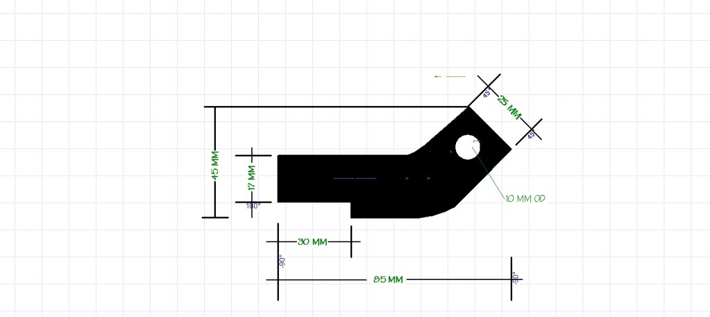

Here ya go
Sorry been a bit busy lately, Death in the family..

Many thanks, fabricating now.

Was just going to find a suitable bit of metal, but got it all done.
Thank you for posting the info.
Was going to try keep the six cylinder bit in case somebody accuses me of wrecking a rare six cylinder pedal in the future, but it fouls with the V8 bracket.

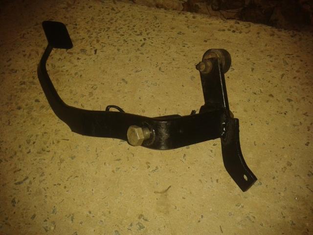

Sorry for bringing up and old thread but it makes it easier than reinventing the post.  In the pic by Toranavicta 9/11 the "L" shaped clutch linkage to push rod appears to be around the wrong way when comparing to the pics in the Parts Manual (page 57).  Or am I looking at it incorrectly? Can someone confirm or otherwise as I'm about to measure up for a new clutch.  Cheers Ron
Sorry, that should be post 9/1/11.  Oops

Correct. The L shaped bracket should be bolted on with the short leg pointing away from the cable.
An image search of:'torana v8 clutch mechanism' will bring up a few other images and the parts manual image.
Supply of a sturdier version of these components was available via forum member Dustings.
