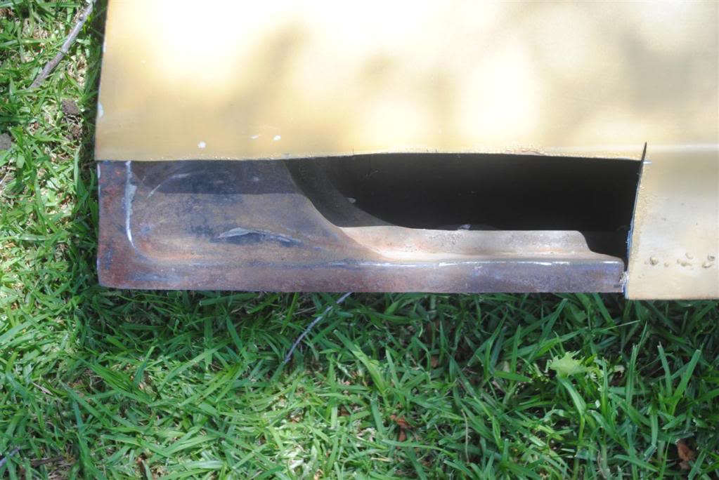

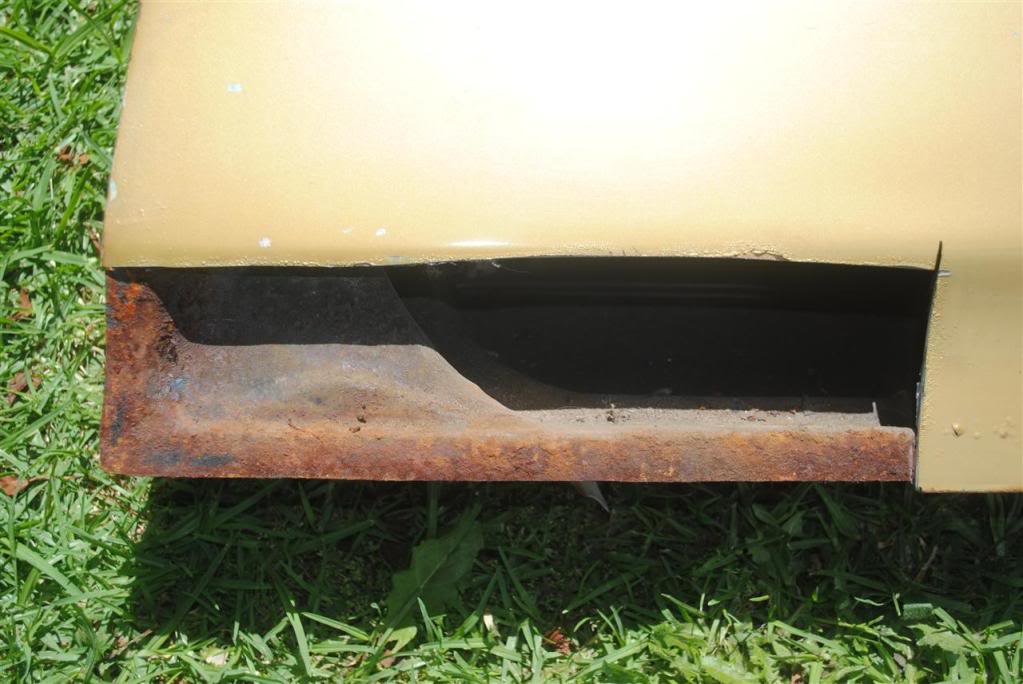

I've been playing with my housemate's Gas MIG a little over the last few months, just welding crap together but wanted to try something a bit closer to a car so I thought a car door was a good start so for $5 from evilbay I scored this:
XB Falcon door (Fords are good for something, practise :stirpot: ) with a fair amount of rust.
I had no trouble ripping into the door skin with the grinder and a cut off disc, and then unfolding the bottom of the doorskin, leaving the frame untouched.
Rust treated the door frame
Then set about making a replacement piece from some galvanised steel sheet dad got from his sheetmetal bloke.
I had complicated it by cutting along the bend. Which made getting the replacement piece to fit nicely a pain in the bum.
Wasn't happy with the curve in that so had to grind the tacks off and beat the panel some more.

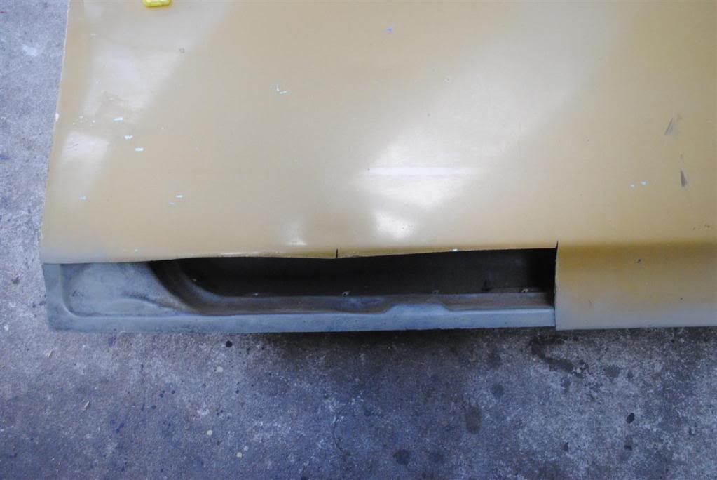

Yeah a bit messy and a few holes but after playing with the settings a little on the MIG it was welding ok
Shape is not great but ok.
After first grind.
And thats where i am up too. I have been back and tacked up a few holes but still need to grind that down and fold the sheet over.
Any suggestons or tips? with the rust hole at the front of the door i am gonna make sure i cut a lot lower down to avoid having to 'shape' the patch piece. Was a nightmare using dollys and hammers and pipe and its still not quite right.
Thanks
Steve

Grind the paint off further back and also the gal? (looks like zinc annealed?) grind it off to bare shiney metal.
Mig doesn't tolerate crap too much.

If that was Galvanised iron do your self a favour and use Zincanneal, a lot easier to weld, use .8mm or 1.0mm, and try doing a series of spot welds rather than a continuous weld to start off.

Start by tacking your patch in as you have done and keep moving about to minimise heat build up. Aim to have a spot tack at least every 1" or so. Then you can start to join the tacks up by welding a couple of inches at a time, again moving around the panel. You should also grind the welds down as you go to allow hammer and dolly to stretch the weld as you go. Don't use a flat disc to grind but try and use the edge of a cut off wheel to get the weld bead down to the surrounding steel. The aim is to reduce the weld bead without without grinding and heating the surrounding material. I'd also have folded the door edges to at least 90 degrees before welding the patch in. Getting a even straight line at the bottom and rear of the door would be easier if you had bent the patch over a solid edge (bench, angle iron etc)rather than having to bend against the door frame. You could try easing the edge over with vice grips a bit at a time. Practice, practice, practice.

I have ground the galvanised back with the grinder and also the paint. The advantage of the galvanised is it doesn't rust (I've had that sheet for about 2 or 3 years now) so all you have to do is grind it off. I think i need to grind more off as i set the paint alight a few times with the welder, through it was welding ok. :lol:
I'm pretty sure the sheet is Galvainsed Steel, not iron in 0.9mm I think. (its somewhere around 1.0mm anyways) ;)
I should have taken a few more pictures. I did do tacks every few inches along the door when I put the patch in the second time (like you can see in the first picture) and then joined it up.
Thanks for the tip with the cut off wheel, it must have taken me 40 minutes to grind that lot down (blunt disc maybe?) so will give the cut off disc a go with the last lot of welds i have done.
I'm not sure if it has warped or not, looks ok at the moment.
Also i've started folding the sheet with a massive shifter, but i see your point, getting the fold straight is gonna be fun.
Thanks for the comments guys. Will try and get a bit more done and updated later in the week.

Mmm, yeah, I would have stayed a bit further away from the fold line. I know it is only a practice panel, but your overlaps are not right, and should have been folded back at least through 90 degrees prior to placing the panel. In addition, the corner needs to be cut back at 45degrees so you can fold it over the frame, and only have a single thickness of metal at the corner.
I would have done it in reverse. Scribe out the corner of the door onto the sheet metal, measure out 13mm for the overlap (depending on how big the current overlap is +3mm for the fold around the frame, cut and shape the panel, then scribe the repair panel back onto the door to cut it out.
Other than that, a pretty good effort.
