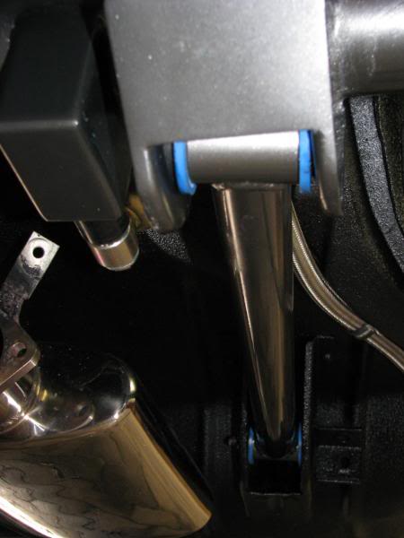

here is a couple of mine, basically the same as above using the original top spring housing
and here are the bottom mounts i made up for the diff

Any chance of pictures showing how the shock is mounted into the spring tower?
What shocks and lb springs did you use?

basically i just had two discs laser cut, then welded the two mounting plates to each one, they then bolt through the old spring seat into the boot area, springs are king springs and are 150lb, and shocks are gaz,

Thanks for the info. That is how I was thinking would be simplest way to fit the shock mount.
Did you remove the bump stop/spring locater from the middle of the spring seat?
yeas they had to be cut out

How much travel does your setup have?

it has about 3 inches of travel

The QA1 setup I am considering has 3 7/8" of travel.

yeah if i wind mine up a bit more it would have more travel, but so far it has never bottomed out even with a full car
