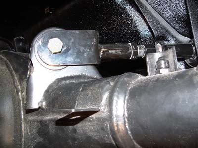

Out back, I fully boxed the lower arms with new bushes, used Edelbrock adjustable uppers (Chevelle ones)
Did the upper arms bolt straight in? To suit which year Chevelle?
#19 _LS1 Hatch_
_LS1 Hatch_
Posted 09 February 2011 - 07:35 AM
Yep, they went right in. The Chevelle arm was about 1/4" or 3/8" difference in length originally from memory, but since I used adjustable ones, it was piece of cake!
I can't remember off hand if I used early ('64 - 7) or the '68-on arms..there was a length difference in them... Have to look up what I bought and can let you know though!

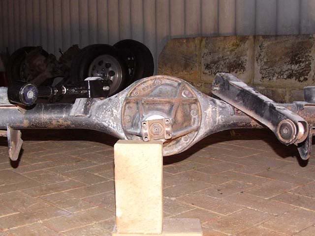

#22 ls2lxhatch
  • 5,335 posts
Posted 09 February 2011 - 10:59 AM
Welby (a9x) did have a set for sale if anyone is interested send him a pm. I suspect they will not fit if you have the Torana upper diff mounts on the BW78 or 9". Similar problem with the McDonald Bros arms.
Edited by ls2lxhatch, 09 February 2011 - 11:06 AM.
#23 _LS1 Hatch_
_LS1 Hatch_
Posted 09 February 2011 - 11:08 AM
Mine fit on the 9" fine though ?
Oh, I see now where they would have a clearance issue. The upper mounts on my diff housing went straight down in the front more so, so did not have that issue like you have shown..
