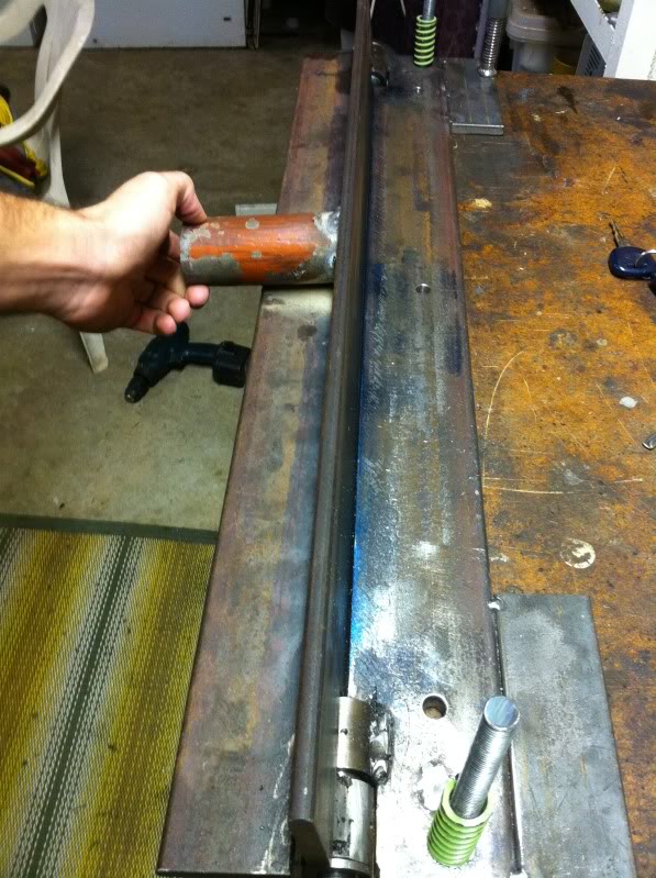

I have been spending a little bit of time on a side project (for my Toranas of course), I have always wanted a panbrake, but paying $1200 for one that I would only use a handful of times doesn't attract me. That and having it only bend 1.5mm mild steel or something.
So I decided to make my own.
This only cost me about $50 in materials and I had a few things lying around, as did my dad.

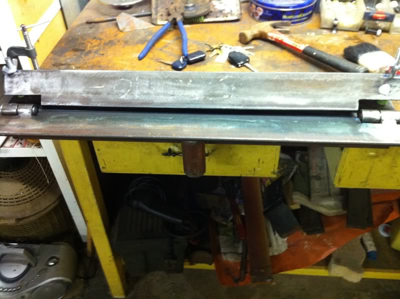

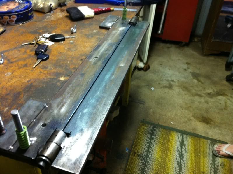

This is basically as it sits without the top clamping piece. It's two lengths of 10mm (i think) angle iron, they have been notched out for clearances (where the hinges are) and two hinges made (using a pin and a sleeve). 1 half of the hinge is welded to one bit, and the other to the other bit of angle.

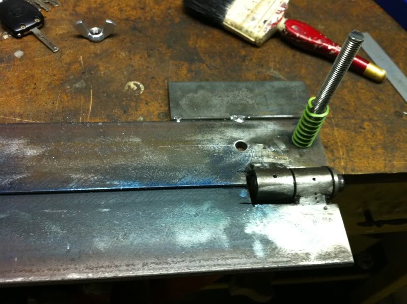

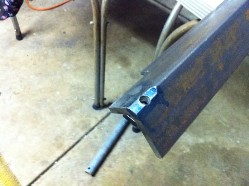

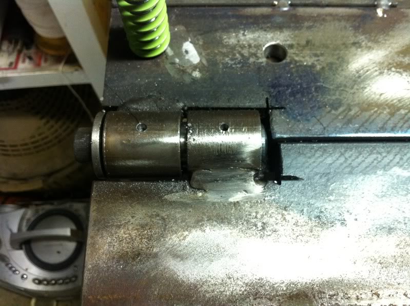

This is a closer look at the hinges. You would also notice the long threaded bolt with the spring. The top bit of angle that clamps onto the sheet metal is drilled out so it can slide up and down the threaded bolt. The spring is there to help you lift it back up once you undo the wingnuts.

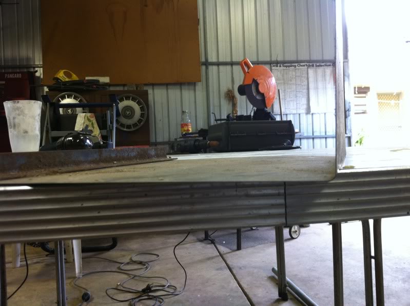

As you can see, the part that isn't bolted onto the edge of the table can easily be lifted up and can bend over 90 degrees.
Another look at the hinge. The holes are just a lubricating access point or something haha

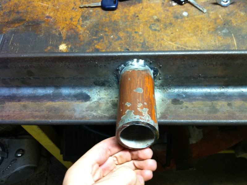

This is where a pole can slide into the sleeve so you can get as much leverage as you like (the longer the pole the better leverage obviously)

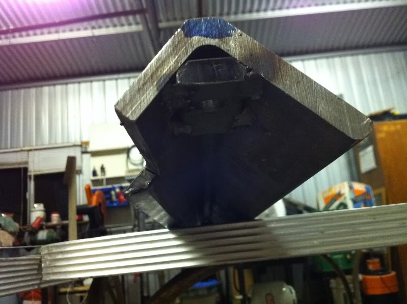

This is the top clamping piece of the brake. The top edge was grinded flat so a hole can be drilled so the threaded bolt can go through.
The edge on the left was grounded flat for more crisper bends
You can see where a little bit of steel was welded in there for the spring to sit straight
There is basically the whole unit. Spring holds it up, slide sheet metal in...

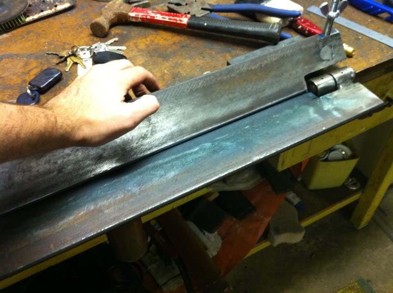

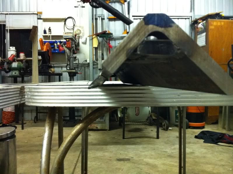

This is me pushing the clamping section down, screw the wingnuts down for a nice clamping effect. (much better than using g clamps)

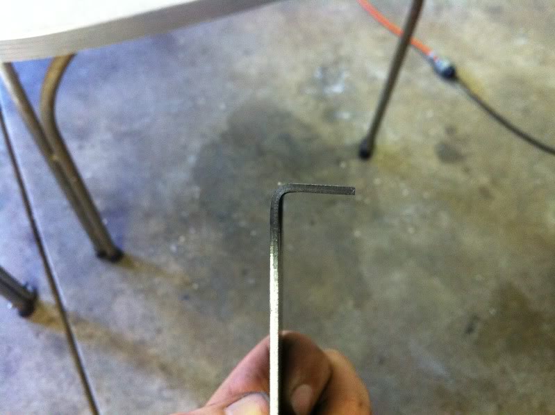

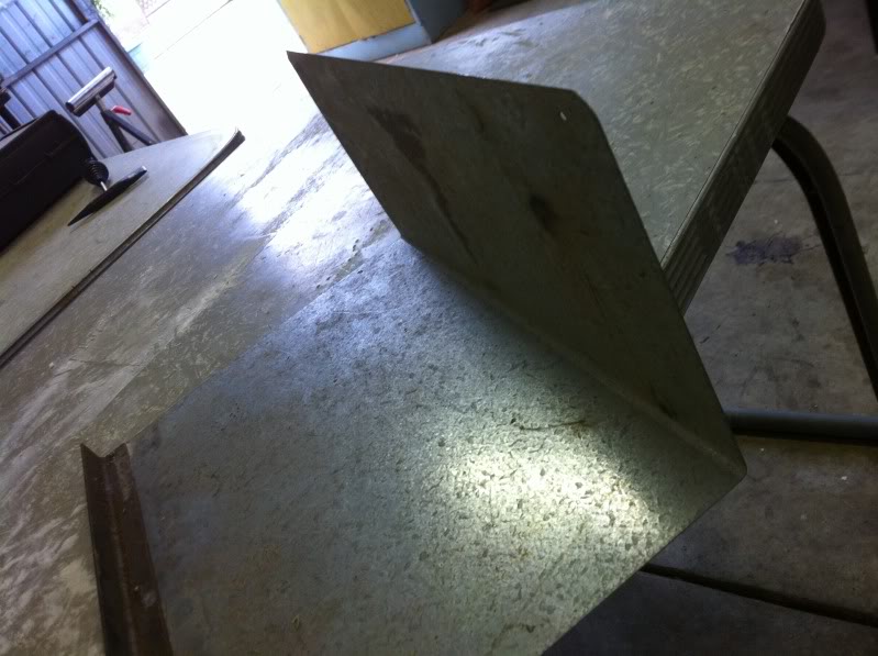

Trial bend with some galv
and this is after I bent some 2.5 mm steel
Look for how much it cost, and the time it took to make, it does what I want for a smidgen of the price. only 99% complete, I just have to bolt it to my bench give it a lick of paint or something.
Thanks for letting me share

mate that has come up perfect and for 50 clams you cant go wrong as saves bending sh*t in the vice and breaking it ( like i did :dontknow: ) in the pic where you have bent the 2.5 it looks like it has gone past the 90 degree point or is it just the angle the pic was taken? not that i would be complaining. very handy to have it in the shed :buttrock:

Thanks for the feedback nial8r, yeah it did bend past 90 degrees but I didnt use a square or anything. Just trialled a thick bend to see if it'll work!
and it did! :)

That's really inspiring. I wouldn't have thought it would work so well. How long a piece have you tried bending? When you bend long lengths, the clamp section may distort, giving you an uneven fold. The upper blade/clamp on factory folders is extremely large for this reason.
This is something many of us could probably use: a cheap folder for those occasional jobs. It would be great to know its limits.
BTW, what sized bend radius did you get? If you wanted to get fancy, you could have an adjustable folding blade to suit different thickness sheets, or to vary the radius.

Hey Steve, i've only bent about 400mm. I made the unit around 700mm, I didn't want it too long as I would have to bend past 90 degrees so the middle would bend properly (then bend the edges out) - I didn't want that.
Originally I made it so the top piece angle iron actually sat upside down which allowed it to be moved back or closer to the bending edge. But you'd had to clamp it down using G clamps. But that way you can make a few different sizes for whatever you needed to bend.

One thing i would probably do personally is put a A type frame ontop of the top clamp section with a threaded adjuster in the middle like the big proper type ones, that will stop the top clamp section from flexing and give you some form of adjustment as it gets warped over the years.
Like on the top of that.

I would also have suggested the "A-Frame" support. Mounted on a 45-degree angle would help both center clamping and the problem of the blade being forced backward. But if you only bend small lengths it probably won't matter. I'm sure in time you will find its limitations, perhaps modify it some more, but as it stands, it's a good, cheap bender.

But surely a piece of 10 mm angle iron is not going to warp over a distance of 450 mm??

That big one you posted, yes I could see that as needing bracing, seeing as it is a stretch of well over 1500mm. But 10 mm angle will not substantially flex over 450 mm. Not even if you were bending 2.5 mm.
From my experience anyway.

But stell is malleable, thats quiet a nice design so why not spend an extra half hour adding a bit of strengthening to it so instead of working for 100 bends it keeps working fine for 1000 bends???

Yeah definitely some good arguments there guys. It's not too late for me to put handles on it - the A frame, to be honest I never thought of it. Great idea though.
I was going to incorporate a way so the top clamping piece could slide forward or backwards but I had to stop myself too much extra work and design that I didn't want to do, and honestly I won't be bending anything thicker than 1.6mm. I could of made the whole unit bigger also, but 700 mm was probably more than enough - better than using a hammer and the edge of a bench haha!
This does suit what I need, and as for the English wheel - hmm I had that idea. Although I'm not a sheet metal extraordinaire and wouldn't know how to use one anyone - not like i'm building hot rods!
