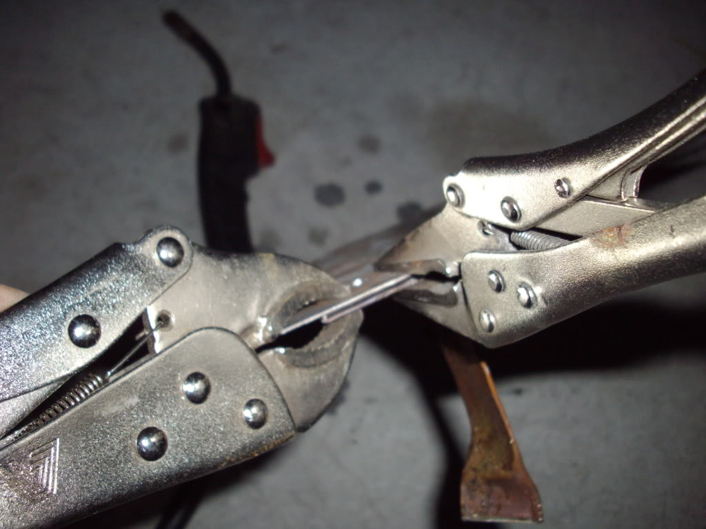

I've got one of these actually:
Came in real handy a bunch of times having the magnet on it, incase it's for a spot hard to reach while welding at the same time. (the magnet it uses is super strong as well)
They also have all sorts of other hand held copper backers for welding against.

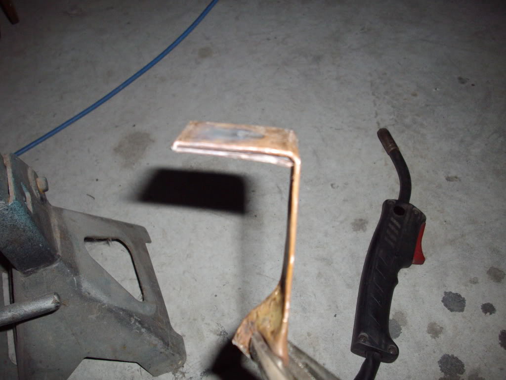

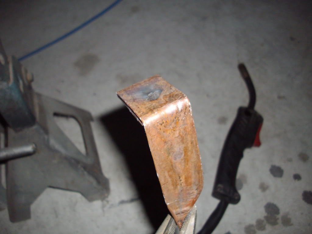

yeah i like that little thingo too, after my chores this morning, mowing etc :nopity: i dug out a piece of 3/4 copper pipe and heated it and made it nice and flat then folded one end over on it self to make it a bit thicker and then bent it at a 90 degree angle and then it should hold in place with one of my C clamps, its just going to be a long pain in the rectum :wedgie: of a job but someones gotta do it :rolleyes:

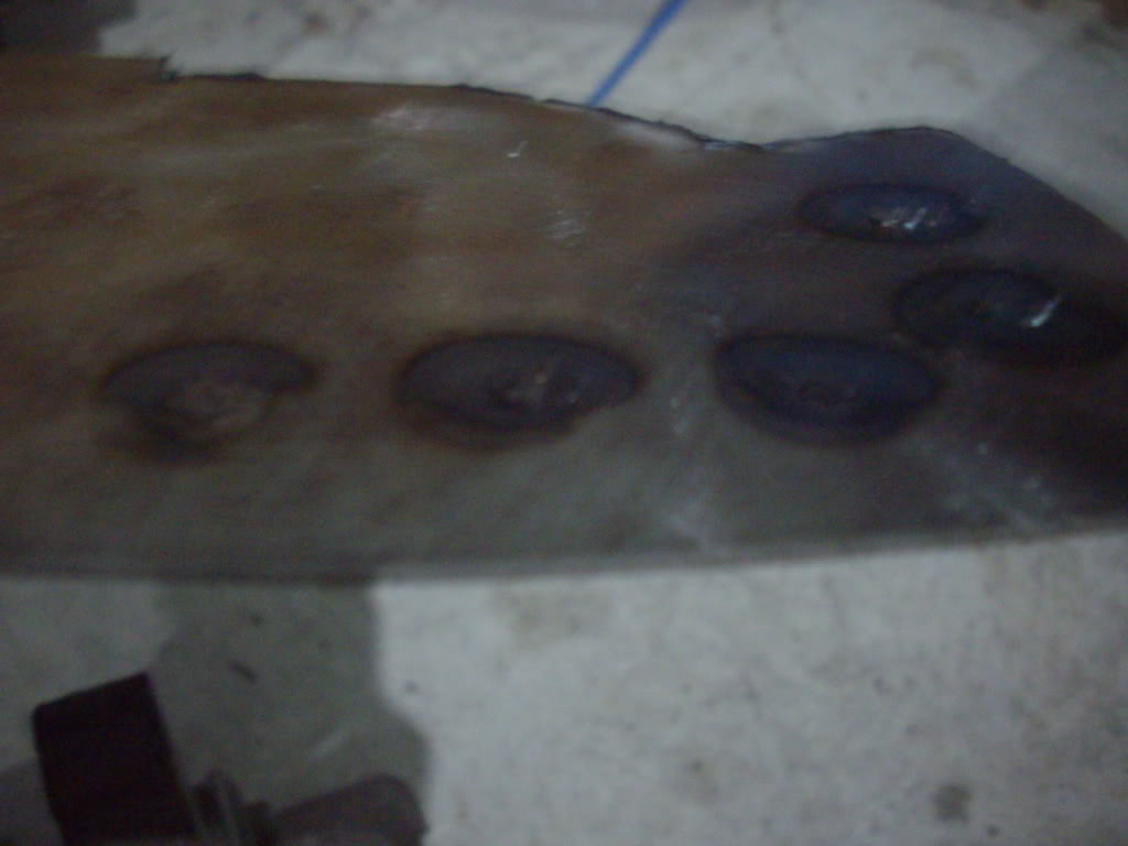

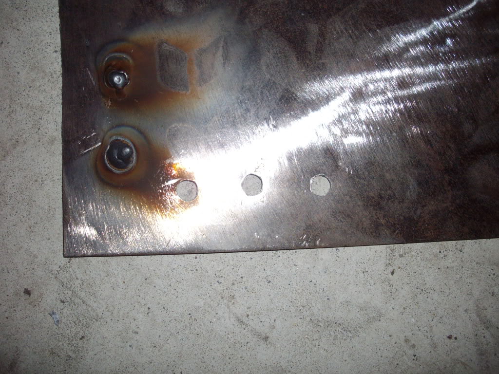

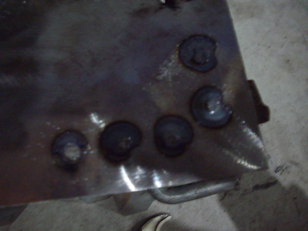

well i gave my little copper backing thingo a whirl this arvo and it works a treat and its not as slow as i 1st thought it would be, here some pic's
had 2 goes but i anted more :lol: so i drilled some more holes in a off cut and filled 3 more
clamped on with the 1st 2 vice grips i could find
and wal'a so much easyer and cleaner too
