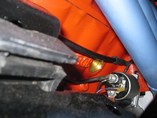

Using a factory GHM LH Torana workshop manual as a guide, i've tried to route the engine harness on my 1974 LH with 304 V8 as close as possible to how they were originaly. The harness runs along the top rear of the engine down to the starter motor. A metal clip that bolts on with the bell housing to engine block prevents the harness from touching the L/H/S exhaust manifold. The harness continues toward the front of the engine enclosed in a plastic sheath & exits just above the L/H engine mount where it is secured with another metal clip that bolts just beneath the engine number pad. It is then routed along the top of the timing cover to the temp sensor & alternator. The alternator charge wire runs parralel with it, secured to the cylinder head by a metal clip that also serves to mount the negative battery cable. My computer skills are limited so i can't scan the factory diagram but i can post pics of my engine with the harness in place.
#7 _LH SLR 3300_
_LH SLR 3300_
Posted 17 July 2011 - 10:13 AM

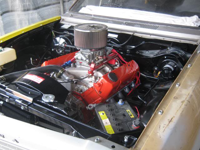

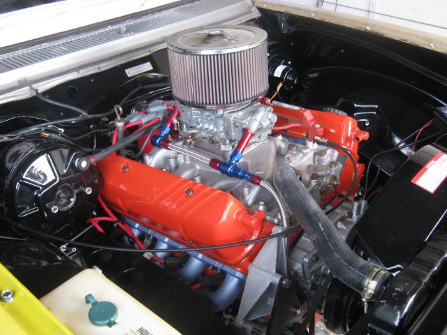

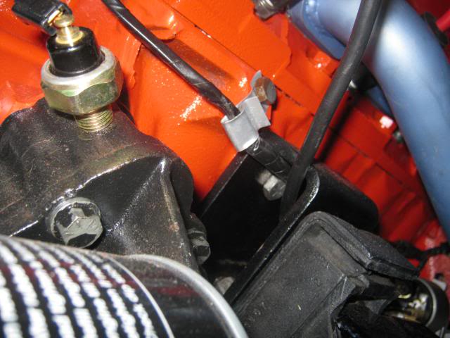

This is the engine bay of my 1974 LH.

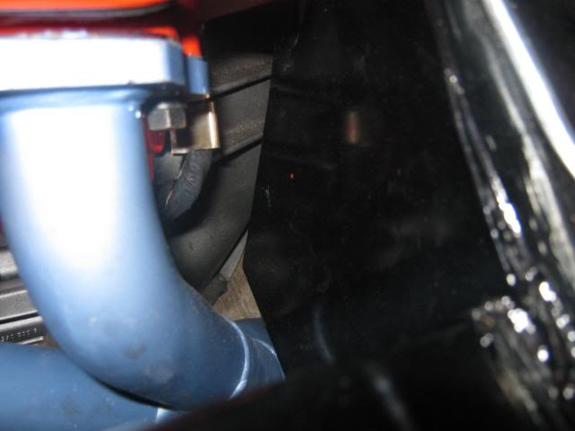

As you can see i'm still in the final process of hooking it all up. I'm running an MSD ignition, so i had to slightly modify the ignition side of the wiring but the engine harness still follows it's original route. Here a pic of where the harness runs to the starter motor & the metal clip that retains it.
Using the original plastic sheath, it runs along the L/H/S of the engine block.

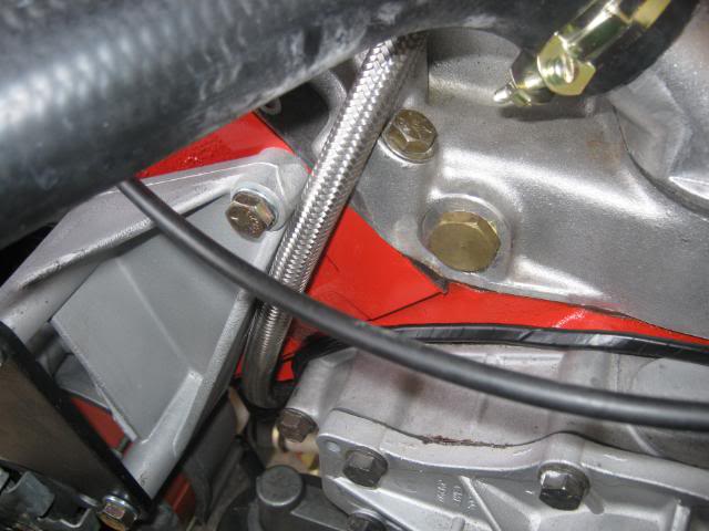

I've run the harness through the engine mount, but it runs above it originally, but still held in place by the metal clip just below the engine number pad.

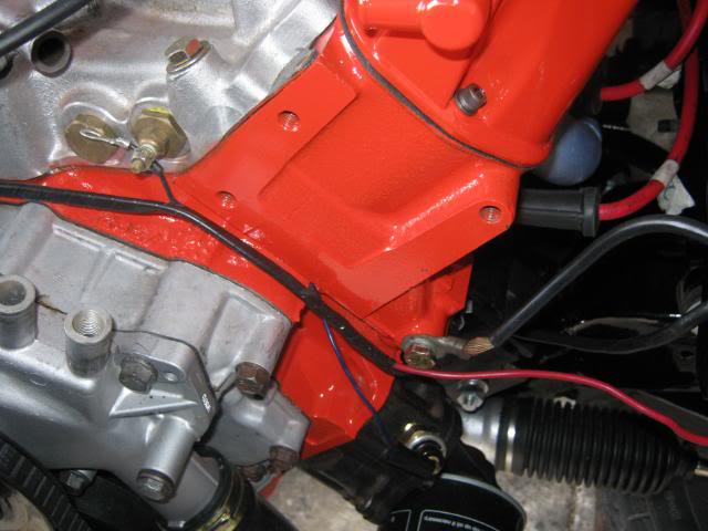

It then runs up along the top of the timing cover. Originaly the B- bolts to the very top outter hole on the face of the cylinder head (the basic bolt hole configuration is the same for both early & VN type heads) & also attaches a metal clip that holds the alternator charge wire, which then runs along the top of the timing cover with the engine harness. As you can see i attached it to the lower bolt hole without the metal clip.

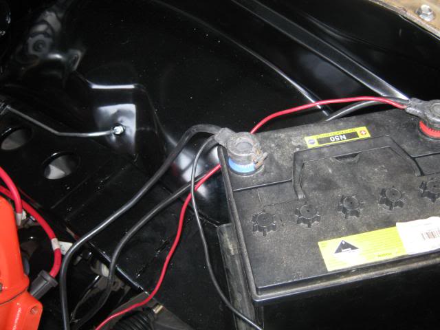

The B+ & alternator charge wires are originaly secured to the chassis rail just rear of the battery tray by the same type of plastic clip that holds the fuel & brake line to the R/H/S chassis near the steering column. I haven't got that far with mine, but i can post a pic once it's done.
