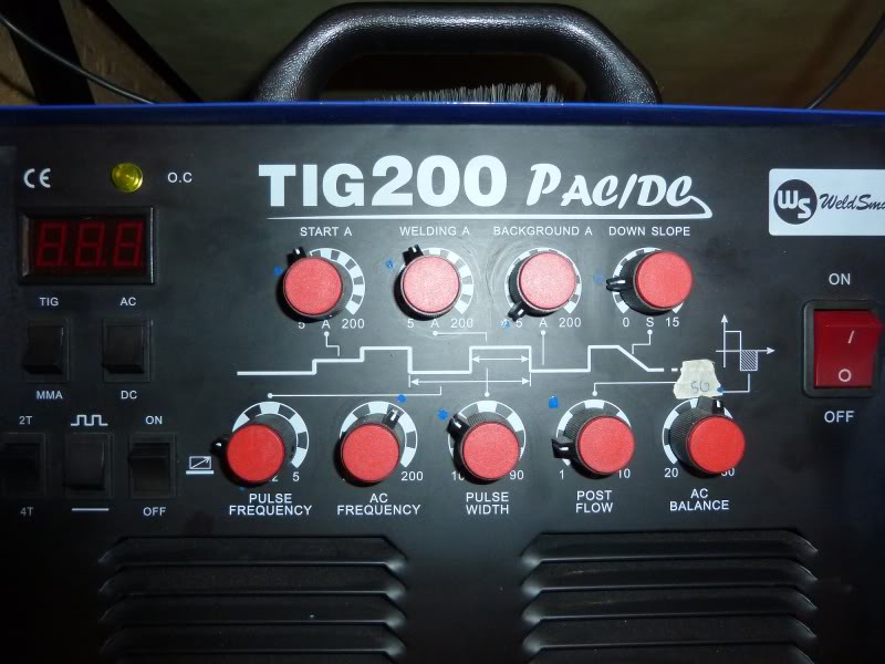

These are my settings on my TIG200P for laying runs down on 2mm alloy using pulse without a foot pedal. These days for all materials im all about the foot pedal.
These are my cheat notes that i took off weldingtipsandtricks.

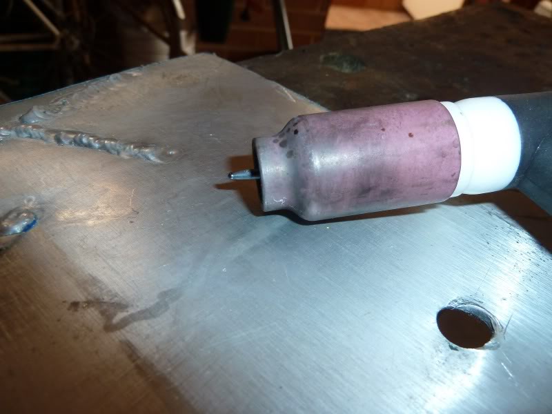

This is how much i have my tungsten sticking out.

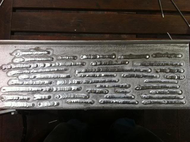

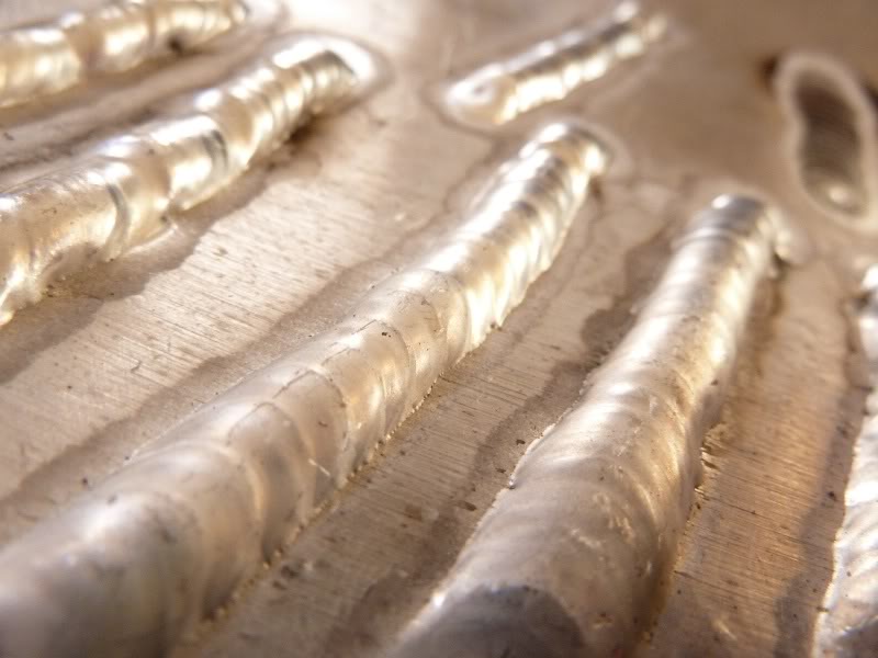

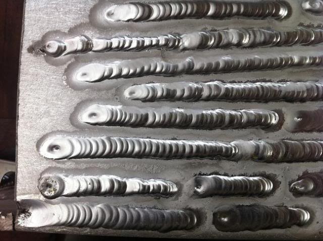

Some of my welds. The size of the caps can be changed by how much filler rod you dip in.
Its all about seat time, Just lots of practice. It get heaps harder when you have to join bits of alloy together.

i usually just up start and welding amps about 20.
flick it over to 2T and flick on the controller switch.
Ev.

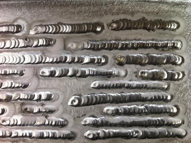

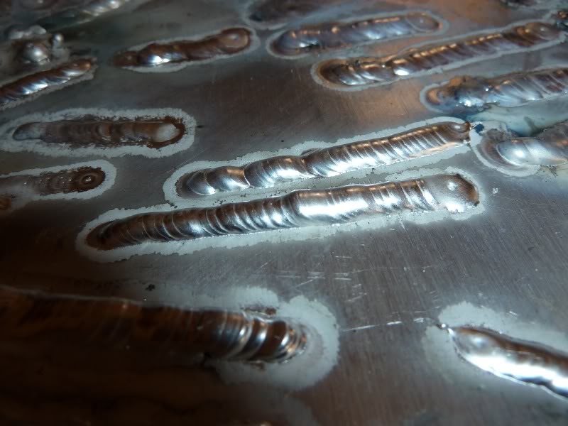

Posted 30 July 2011 - 03:53 PM

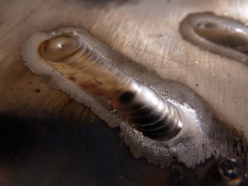

Well had abit of a play this morning... This thread has been very helpful. Especially Evan. Managed to start laying some... ok... Runs, But alot better then I was doing before. I think now its just as you say.... seat time and getting my hands to move automatically without me actually thinking about it... I don't have steady hands at the best of times (I actually shake, have for as long as I remember) so its a little tricky to get them perfect but some runs it all seems to just fall in to place and off it goes by itself and ya know your doing a good one.
Might have a go at some Joints later on.
How do you know when to regrind the tungsten? or do you only have to if ya overheat it or dip it into the puddle? they didnt seem to wear away much during normal use... just formed a ball on the end.

Posted 30 July 2011 - 04:25 PM
Your tungsten should be back level with the shroud when welding ally.
It should also be sharpened to a radius not a point.When it has a nice shiny ball on the end (as you describe),you've got it right..
Looking at the end of your weld bead,I would increase the downslope time setting and also the postflow setting to stop that cratering.
When Im welding 3mm ally,I use a 2.5 tungsten and work around 100 amps,a bit more (110-120) for an inside fillet using a narrow arc width,or a bit less (90-100) doing an outside corner to corner weld using a wide arc width.
Experiment with the arc width on an outside corner to corner to see what happens when you alter it.
Narrow arc width focuses the arc a lot narrower and gives deeper penetration,wide arc with gives that nice broad radius on an outside corner.

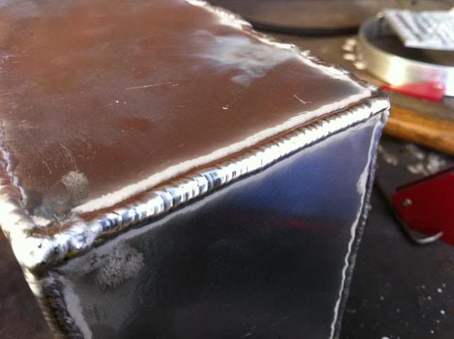

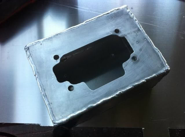

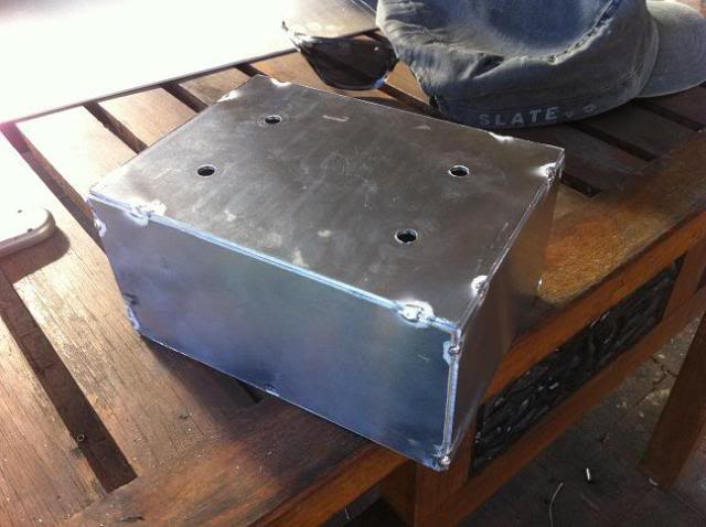

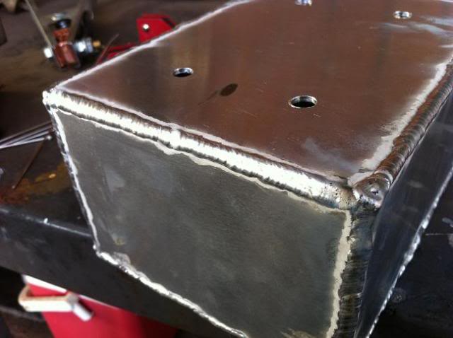

Well had my first attempt of making something with alloy today... A friend wanted a little carby hat for his 32/36 Weber so he could plumb up a cold air intake for now and turbo in the future.
Managed a few decent welds

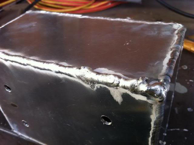

Also a few shit ones
This one in particular, not sure why but all of a sudden it was like the puddle just didnt want to travel, and then all these black specs formed like there was some sort of contamination?

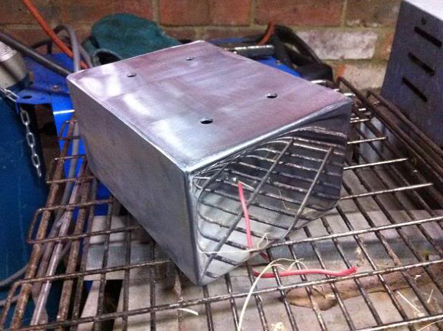

Because there was too many ugly welds I ground them flat and started to polish it up
Just need to get some 3" pipe from somewhere on monday and weld on the inlet.
Im not sure if just using bolts from top to bottom will seal, probly wont be a problem for the cold air intake but once he starts boosting it, it may leak? maybe just a dab of sealant under the bolt head... otherwise ill have to weld in a full length tube from top to bottom
