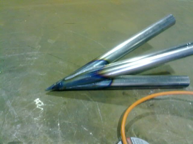

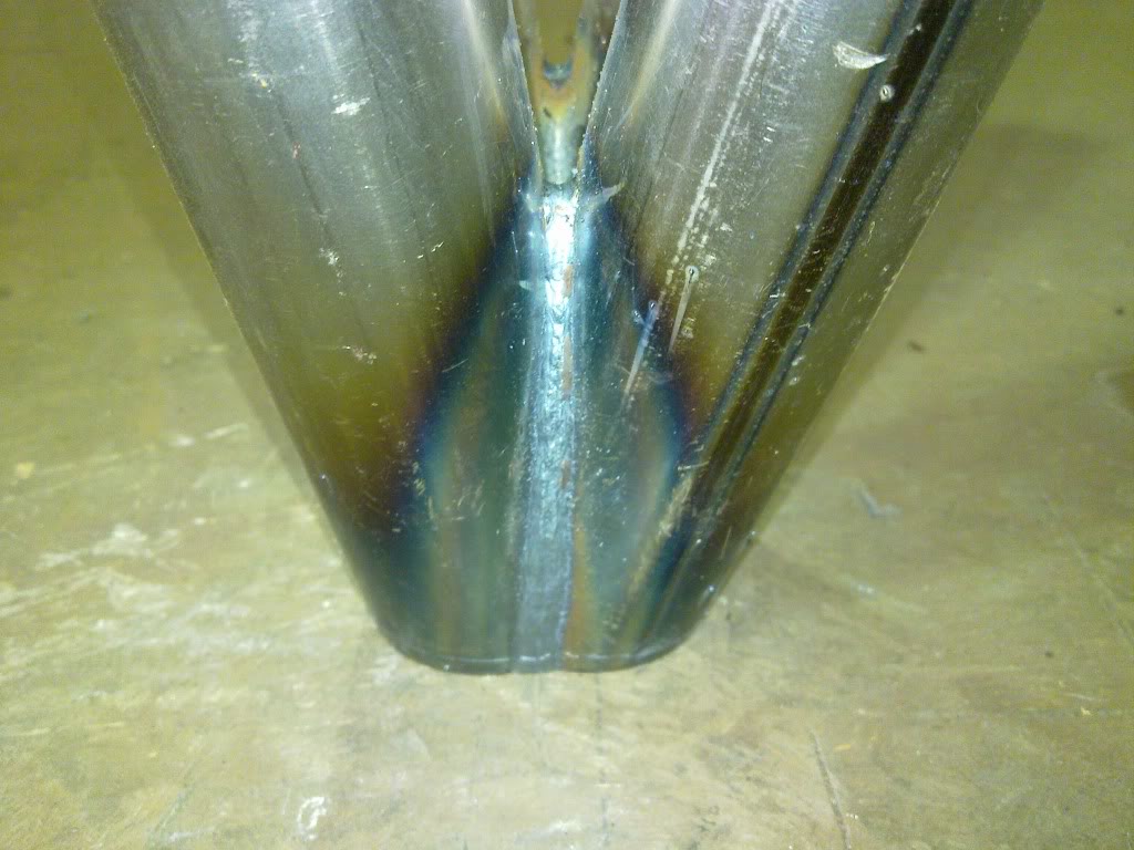

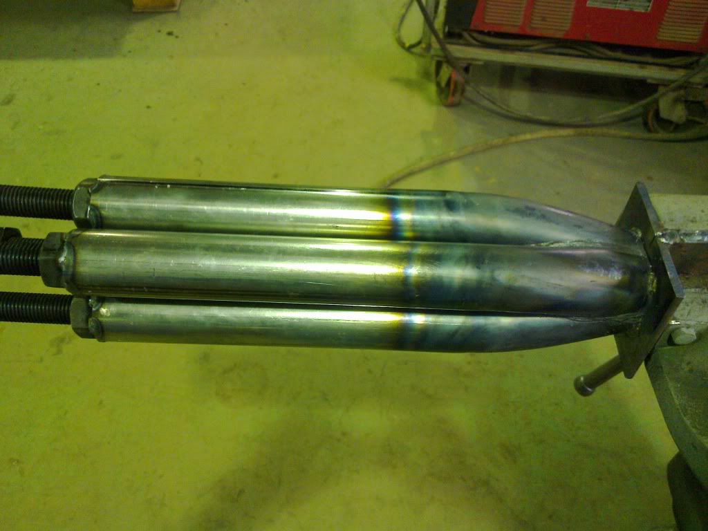

I started to make my extractors. First up was the collector.
I cut all 4 pipes at 12 degrees. Then rotated the pipe 90 degrees and made another 12 degrees cut. Placed all 4 pipes together and welded them.

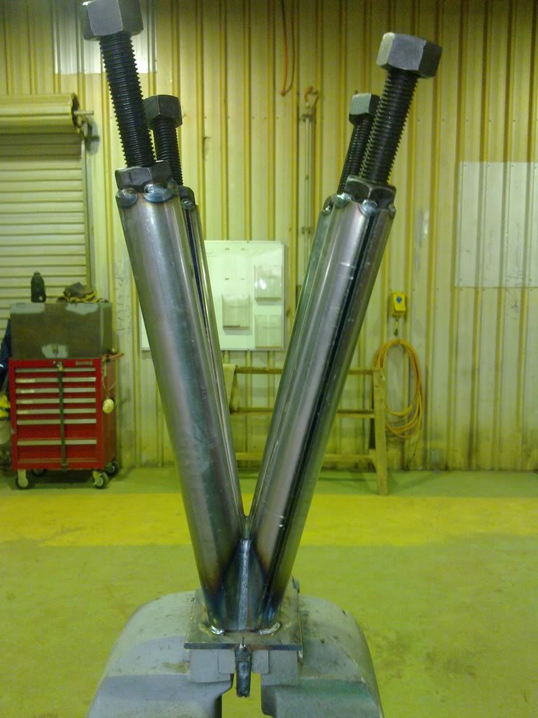

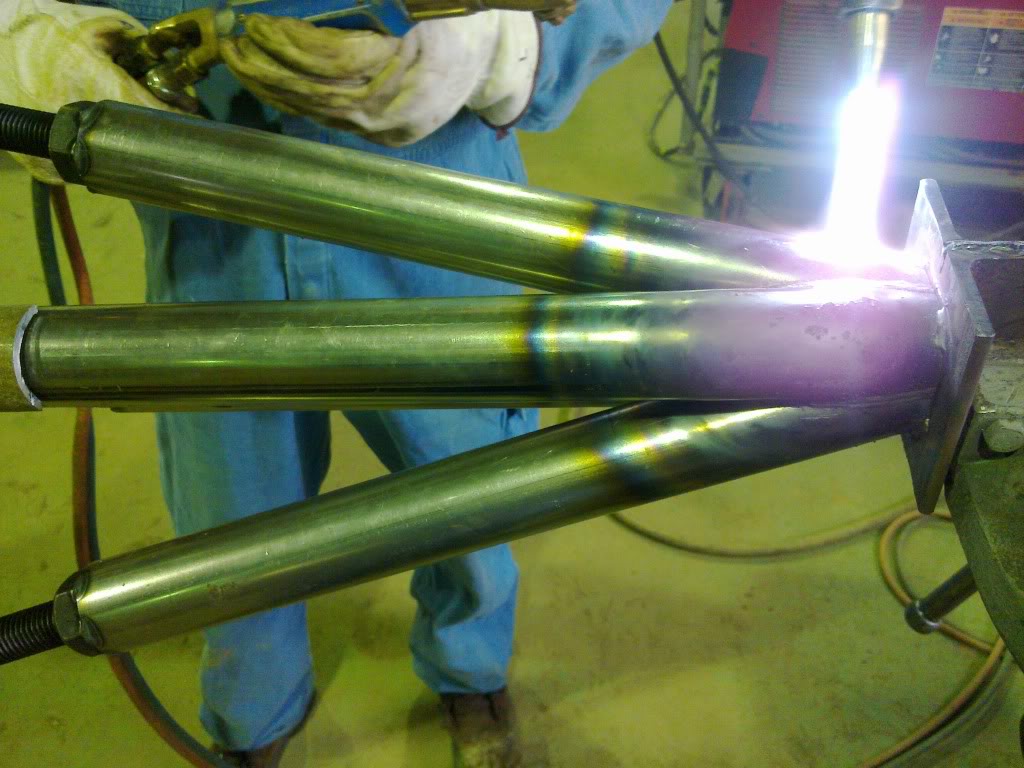

Welded a plate to the bottom of the collector, filled with sand and welded 4 nuts to the top then put the bolts in to hold presser on the sand. Heated and bent them.
End result is a mega collector with 12 degrees convergent angle and mandrel bends. Still in a ruff state but will clean up OK

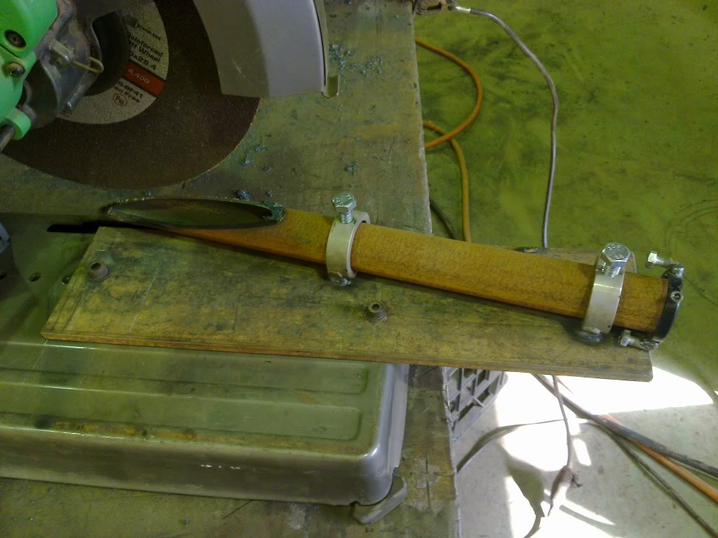

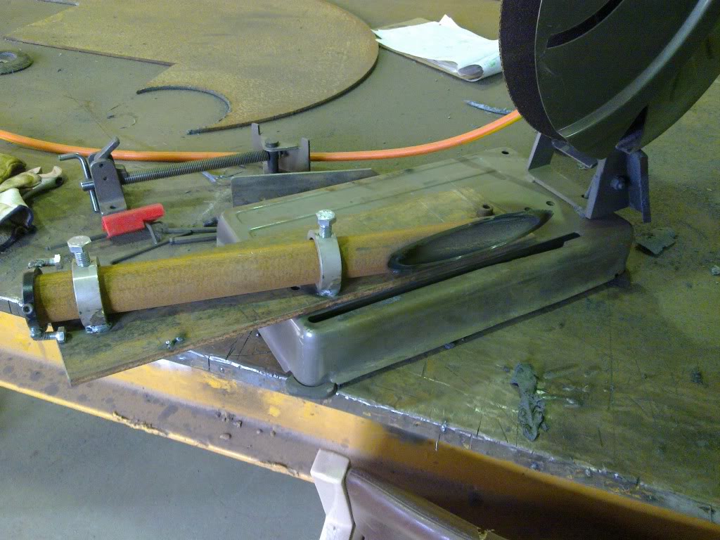

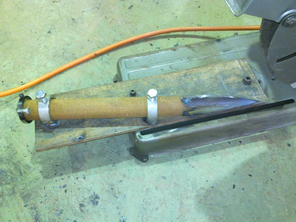

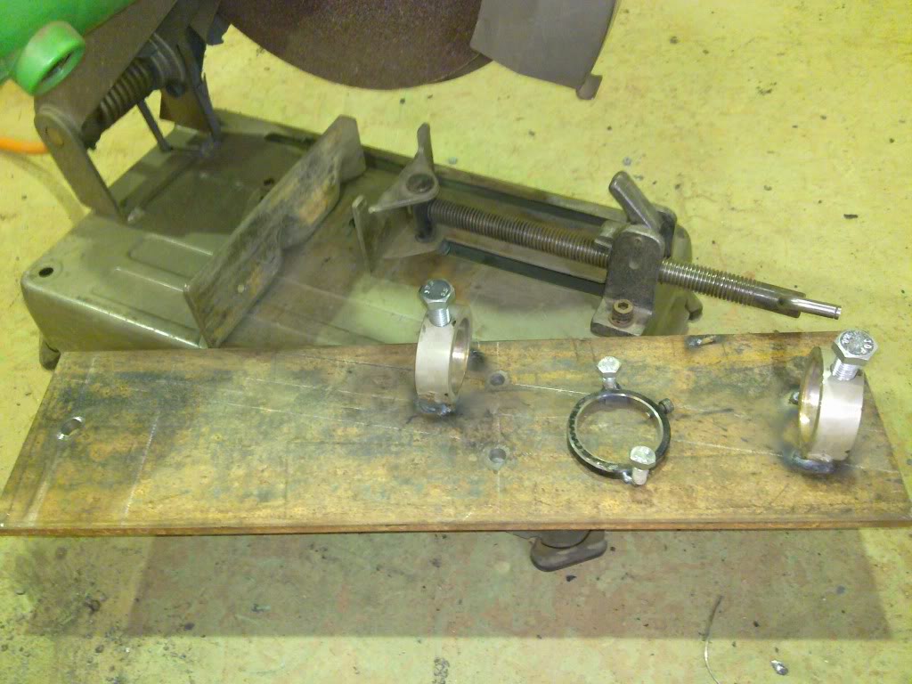

This is my very expensive collector jig. Its not even my drop sew. The plat bolts to the drop saw, the 2 rings are welded on at 12 degrees to the blade. The other ring fits over the tube and has 2 stopper (bolts welded on) set at 90 degrees.
Do one cut then rotate the pipe 90 degrees (to the other stopper). This is not exhaust pipe tube just some old pipe I had.
This is what it should look like.

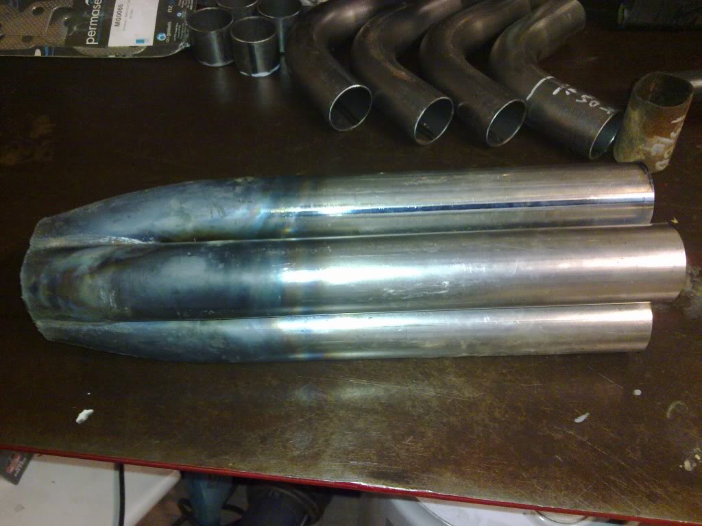

Finniest off other collector today.
I got my tubing from midalia steel 1 ¾ 6 meters long, 1.6mm thick for $39
My next plan is to cut black poly pipe to the length I need for the primaries. Heat and bend them for templates. I have mandrel bends only for the first bend out of the head. So I will sand bend the rest of the primaries.

why do u fill the pipes with sand???
#10 Struggler
Struggler
  • 2,426 posts
  • Name:Andrew or AJ
  • Location:Canberra A.C.T.
  • Car:UC Sedan
Posted 14 August 2011 - 07:36 PM
That is what everyone did before they invented mandrel bending.
It stops the pipe collapsing while you heat and bend it.

Yeas it minimizes distortion to the pipe. A good sand bend will look just like a mandrel bend.

Yes, sand bending is just about dead. But why ? for me it is much easier to get a very smooth and good flowing pipe with sand than cutting and welding.
Yes, there is a special sand I think its only fond deep in the Amazon jungle ? But a old timer that is very good with sand bending said yellow brickys sand is the next best thing. More important is that it is very dry “VERY DRY” I sit it on top of the potbelly stove for 24 hour or in the welding rod stove a work for 24 hour just to be sure.
If you are doing a long bend you may have to stop and tap the pipe some more to tighten the sand then tighten the end caps some more. Heat up a good 2 or 3 inches of pipe cheery red more on the out side of the bend. Bend slowly if it start to wrinkle on the in side edge try more sand pressure or more heat on the out side edge.
Have fun.
