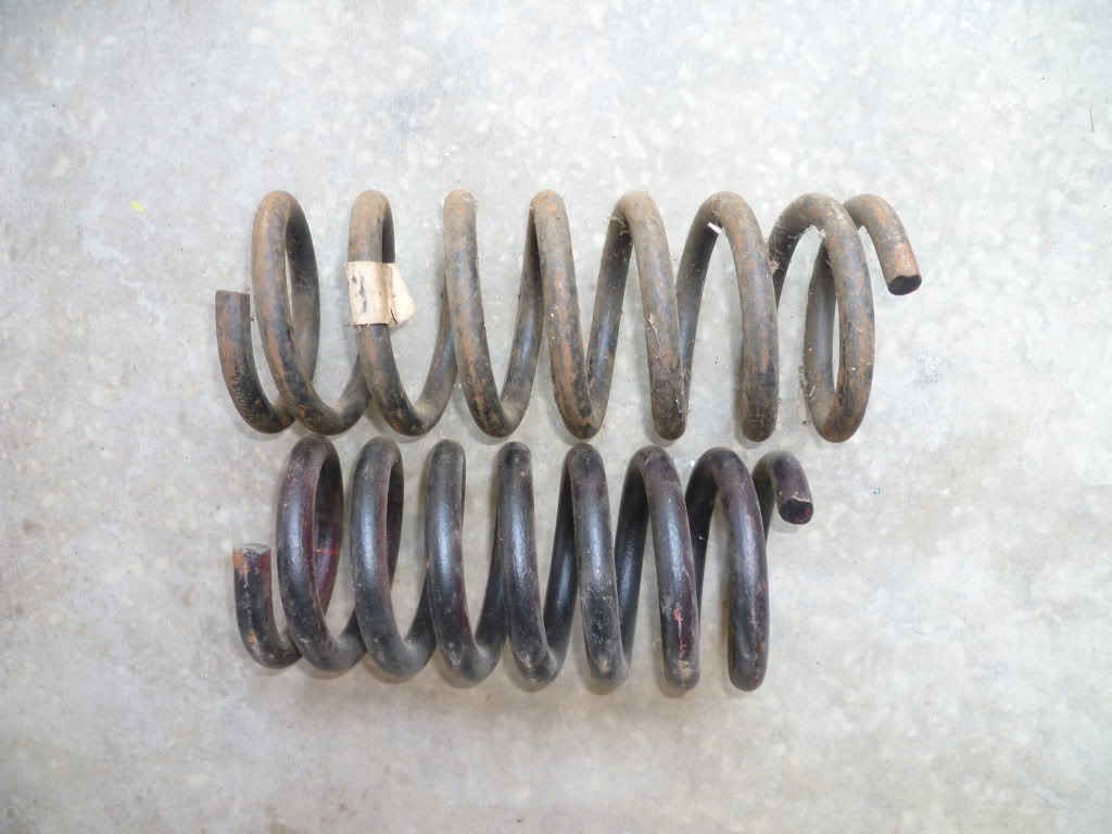

Funny you should ask that, yes they do.
In the following pic you can see a NOS LC XU1 front spring (top of pic) and a used Pedders 1" lowered H/Duty spring.
The left hand end of both springs are the top and the right hand end is the bottom.
The end tip of the coil at the top of the spring sits closer to the next coil when compared to the bottom of the spring.
I sat the Pedders spring onto a LCA and found there is a free height difference of 6mm (higher) if you install the spring upside down.
However when installed and at kerb weight the difference will probably be negligible.

The springs are the same top and bottom,so there is no wrong way they go in,as long as the fit up into the tower at the top,there is a lip that locates them,and the cut end is located into the lower wishbone [ you will see a indentation were the cut end of the coil is supposed to sit ]
Hope that all makes sense ??
