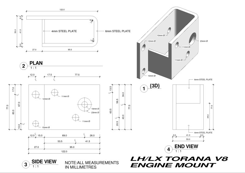

Posted ImageI've been going to do this for a while.
I'm tired of seeing fellow forumers being ripped off when trying to buy these mounts.
Print this out, make them yourselves, or take the plans to any engineering shop & have them made.
Disclaimer: I didn't draw this up. The measurements have been converted from imperial to metric. The measurements were taken [ unfortunately] after the items were painted with 2K.

Can you turn it on its side for us please ?
#3 Statler
Posted 09 November 2011 - 05:55 PM
Amendment:1

thankyou copied,
and i will make them for myself at work.

Any chance you could get drawings of the HQ ones as well?
