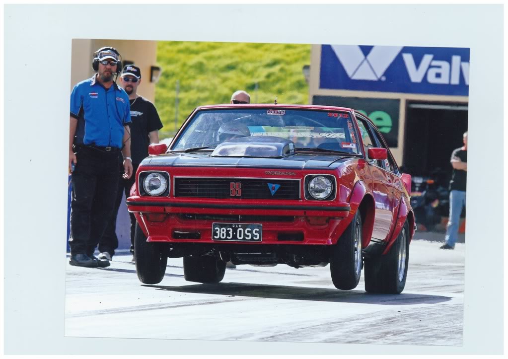

Posted 30 December 2011 - 02:09 PM
<p>
a pic of our car with a rear bar, leaves pretty flat.Posted Image
