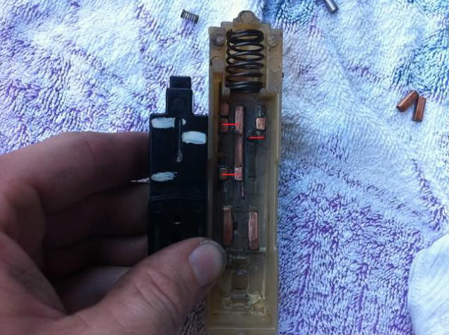

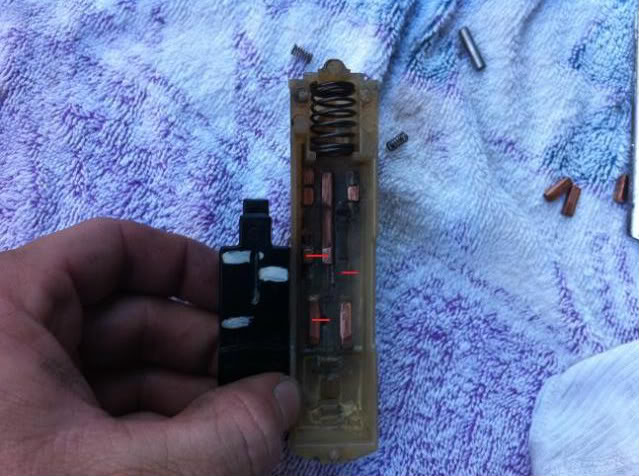

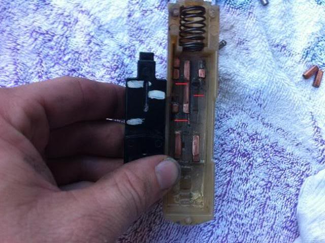

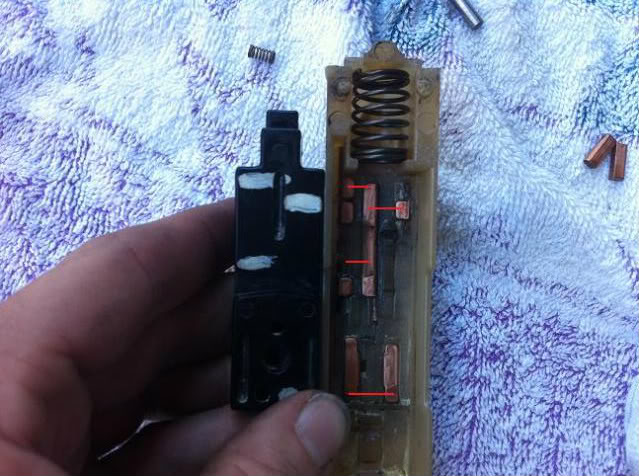

Ok well seems I spent the last couple hours trying to fix something that wasn't broken?
Pulled the switch apart and it looks like its supposed to be as I described above, and that with the Key turned all that way back is infact not "lock" but "Acc" I assumed it would be like other cars and the order would go, Off/Lock -> Acc -> On -> Start, but it seems it is Acc/Lock -> Lock/Off -> Nothing -> On -> Start. Can someone with a Stock wiring confirm this is how there car is?
Anyway once I pulled the ignition switch this is what I found... The white-out marks on the black section on the left show where the contacts are on the bottom that would be touching the Terminals... I also drew a red line on the terminals to show where they would be too. The middle vertical terminal is power, so anytime a contact bridges the power terminal and another it gets power.
In order from the key turned all the way towards the driver to being turned all the way forward (clockwise)
Locked/Accessories
Only the accessory terminal has power
Locked/Off
Nothing has power but the Steering lock is activated
On
Accessories and Ignition have power
Start
Starter and Ignition have power, The 2 bottom terminals also get ground to the chassis... Looking at a wiring diagram these are connected to the water/oil senders and also a light on the dash.

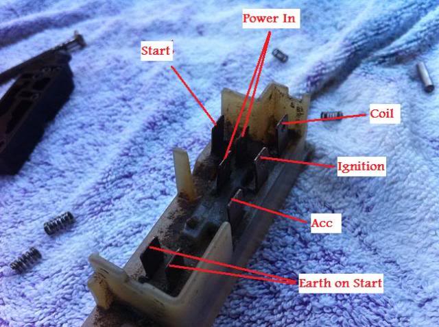

And for anyone who wants to know which Spade Terminal is which...
So yea, all seems well. Just can someone confirm that that is also how their stock ignition works?
