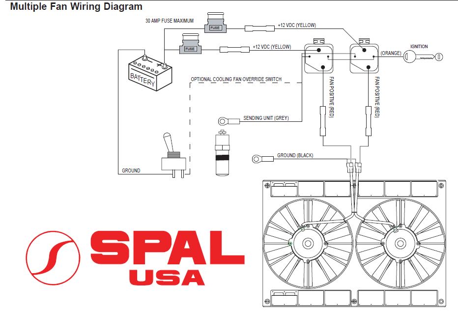

#15 _LS1 Hatch_
_LS1 Hatch_
Posted 30 December 2011 - 01:49 AM
For what ever it's worth by the way...I use that Spal controller myself, and it works perfectly. I use it to control a pair of high output Spal fans and it will control the engine temperature right where you want it.
I also use the input on the control from my trianary A/C switch so it ramps up the fans to high when needed as well...so even while standing still there is more than enough air movement across the condensor as well to keep the temps cool.
The second fan is only on or off the though, the spal controller only regulates the primary fan with a variable speed. I just use a high amp relay controlled by the Spal unit to trigger the 2nd fan on or off.

#17 Tiny
Posted 30 December 2011 - 12:40 PM
2elcs is using one of those dual temp switches and they are a good thing.
Shame it just doesn't screw in, could you get a block off bung, then drill and tap through the bung to the correct size?
I'm using the SPAL system in the HQ, to control the au thermos.
I had a single sensor triggering both fans and it was killing 40a fuses instantly.
Turned out when I put the SPAL controller on it warned me of a motor drawing over current. Turned out I had a dud motor!
The fans were brand spanking new and nit seems I had this fault from new!
No headaches now though :)
