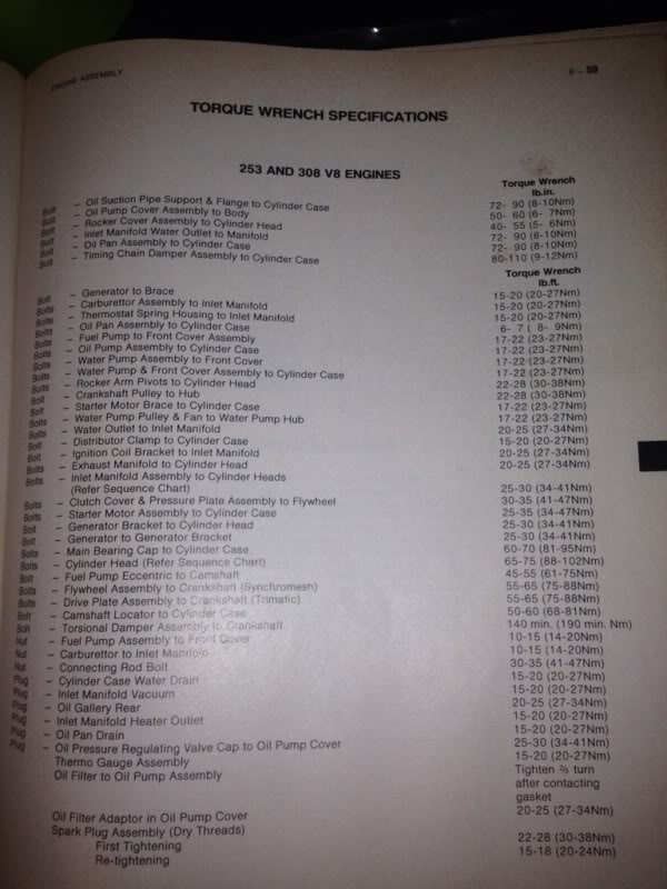

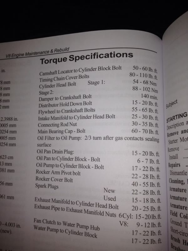

#3 hanra
Posted 16 February 2012 - 09:18 PM
That's a good idea... Look in the manual!!! Hahahaha
