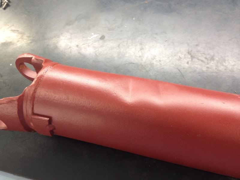

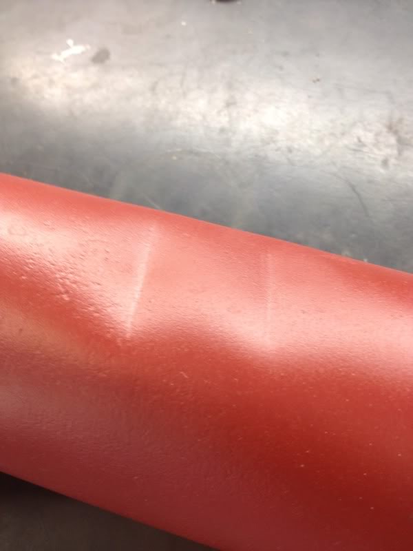

What's an expected price to pay for this??? Just got my Tailshaft and K frame back from the blasters and noticed two grooved kinks in it.... Dunno if it's going to have a twist in it now... Rough pricks... Cowboys.

Ill get some pics of it tomorrow as its at work in primer awaiting spraying.. which may not happen if its rooted....

What do you experts reckon... Is it rooted... Im going to go back and let the yobbo's know... but they wont to shit about it..

Just looking at the kinks i would say she's rooted mate.
You could try hitting whoever did that on the head with it
but then you would have 2 round dents opposite the kinks.
looks like someone dropped something on it.
Rough them priks,,they owe you a tailshaft,,name and shame.

it's frOcked..frOcken monkeys..i wouldnt be happy at all..it would be out of round :angry:

This is f*cking bullshit.... Ill take it into the tailshaft balancing shop first and get there opinion then go back to the blasters... Im sure the bloke will just shrug his sholders and go "oh well"...

As your's Brad....time to retube it I would reckon. A "good" tailshaft shop should be able to handle it pretty simply.

The shaft needs a retube , I wouldn't recommend it going back in a vehicle , if you send it to driveline they will do a great job ! If you were down this way I could have looked after you !

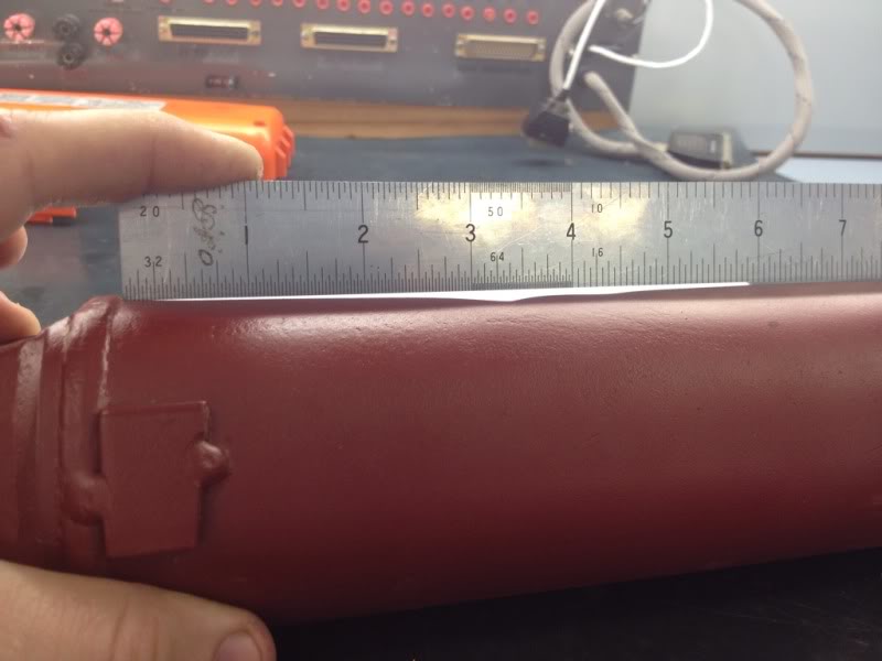

I was thinking perhaps it would fit in our lathe at work and I could check it for run out with a dial gauge?
