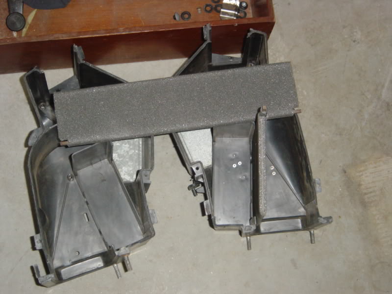

i dont know what mine were covered in.i gave the flaps to my trimmer,after i pulled the heater box appart,and he covered them.i dont think its anything to special.so far so good no problems at all

ass308, the grey foam you have on the flaps is the same stuff i have, got it from the local air cond guy, still trying to get some foam for the heater core but.

That grey foam looks like what I used also. No dramas in the hatch, yet. I've also just used it on the XU1.
It's about 5mm thick.

mika03au,i used 2 boxes to make one,because i broke things pulling it apart.. i confess to useing vice grips,to remove the crank arms
ill speak to my trimmer in the next few days,ill let u know what it is.
mort,i didnt use foam for the heater seal,i couldnt find anything decent.i used i strip of aluminium and a couple of grommets.worked out great
