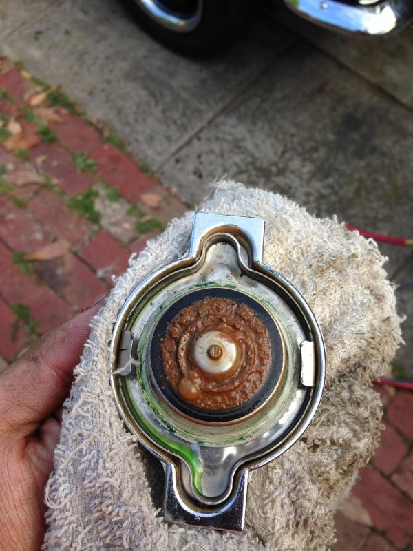

Also noticed this, ideas?

I don't think there's a quick fix for M/C apart from putting a container under drip.
Could that be oil and water mixed gunk on radiator cap? Hope not!

it looks like a disese

Oooh bit of gunk in that radiator time for an engine flush maybe
Brand new radiator and motor was flushed.
Hoping it's nothing sinister, but it's only on the top of the water level.
Oil floats on water remember.
Oil in the coolant normally presents as a creamy sludge on the radiator cap.

Correct, although i thought it would be more of a film than brown crud. Could this be corrosion?

If it is not oily in consistency then I would hazard a guess it is the mud that settles at the bottom of the block.
I have seen blocks with over 25mm/1 inch of it.
I presume it is from rust scale broken down with heavy minerals and non filtered/distilled tap water (dirt/mud).

That's what i was thinking. Didnt seem like oil to me more like the crud that sits in the block.

Knock a welsh plug out and have a look.
In the past I have removed the plugs and got the garden hose in there and flushed the crud out from the block.

take the oil cap off and see if there is any there as well.
If you have been getting some heat cycles through the motor then will move on the crud on the bock.
Is the temp still OK?

Cleaned as much of the corrosion out as i could when i had the motor in pieces and welsh plugs out. Could just be a build of metal particles.
Temp seems ok'ish. A little higher than i would like but doesnt spike.
