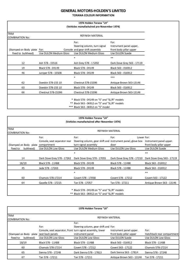

Hi All
I found these in a book I rec'd yesterday.. I thought they might be of use to people here.

Yeah, me for one!
Would you believe that I found it in Fiv's book on the History of the Holden V8?? :spoton:
Some other interesting stuff in there like the CAMS paperworwork for the A9X too...

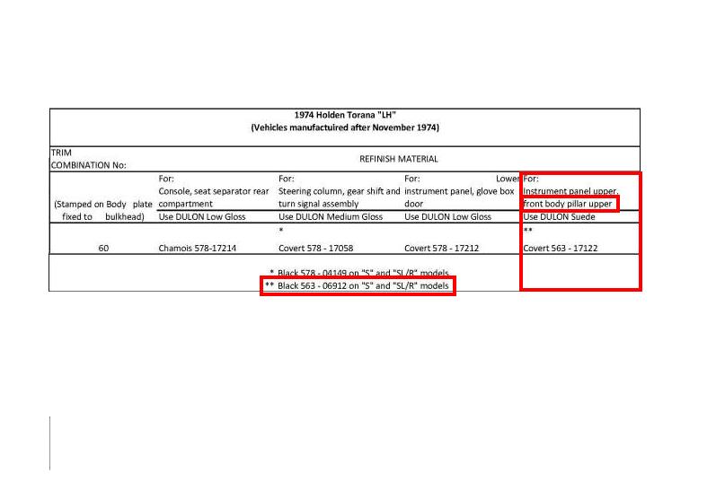

Am I reading this right.....?
For an SLR with -60 Trim built after Nov 74 the A pillar is trimed black???? Dulon Suede??? Is that paint or material?
#7 _sstorana_
_sstorana_
Posted 18 July 2012 - 01:34 PM
Hi Brad,
Dulon Suede is a paint and yes, your's should be Black.
Mick

They are painted Brad-563(suede) is the paint finish.

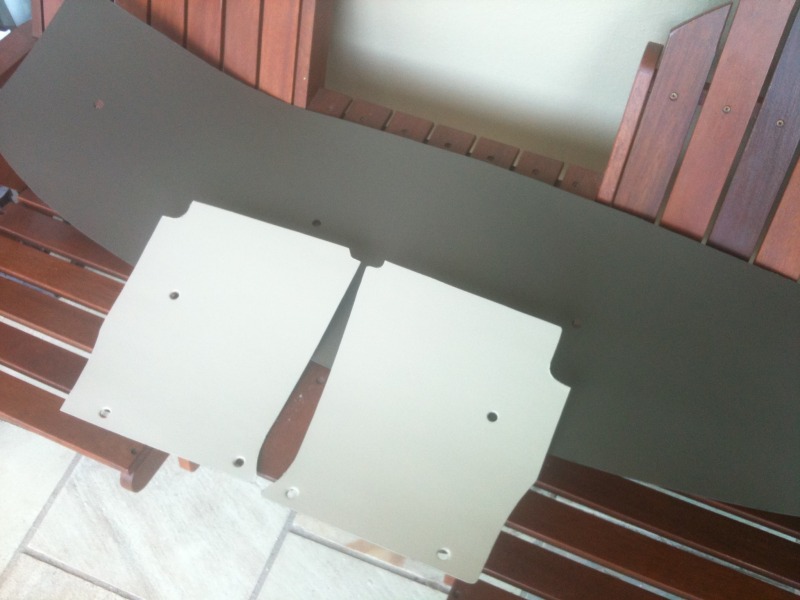

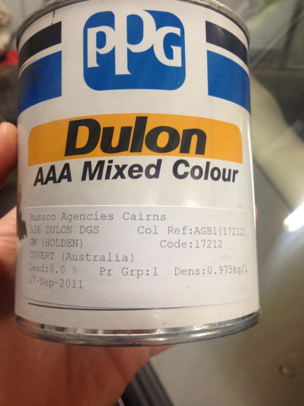

My carpet was meant to be covert. My parcel shelf is painted covert. The local paint shop mixed it up for me, they had it listed in acrylic. You want a picture?

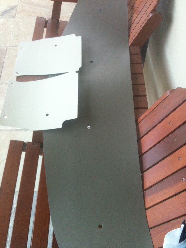

It's kinda dark green, This is the parcel tray and chamois kick panels. I don feel these pics give a true representation of the colour. I'll have the code somewhere

Haven't had anything to do with Covert but that looks nice with the Chamois.

I just checked the Parts Catalogue (illustrations) that have the Trim Colour Charts and the Covert is used in 60V, 60X, and 60Y. Not in 60A and 60B.. :rockon:
60A and 60B are Black and Black!! Whoo hoo!!

That is because 60A is Chamois/Black on a Kingswood or SL. Rather than Covert it has black, so black carpet, instrument pad etc. Probably the nicest trim of the lot. For some reason it was only used in late HJ, carried on into HX and also used on LX. Reverted back to 60V (Chamois/Covert) in HZ. 60B is from memory just a seat insert in Chamois/Black, just like 60Y is in Chamois/Covert. I can't remember if 60A on late HJ and HX Belmont, Holden and S (called Beige on these luxury levels) has black as well, or if it is all beige.
