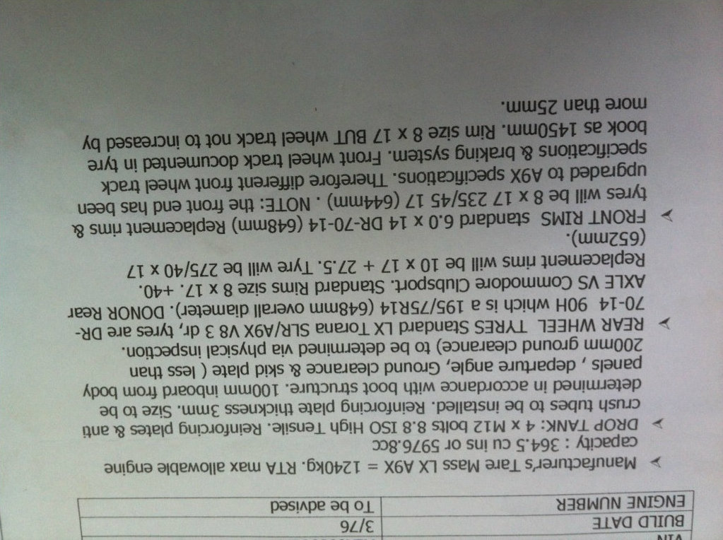

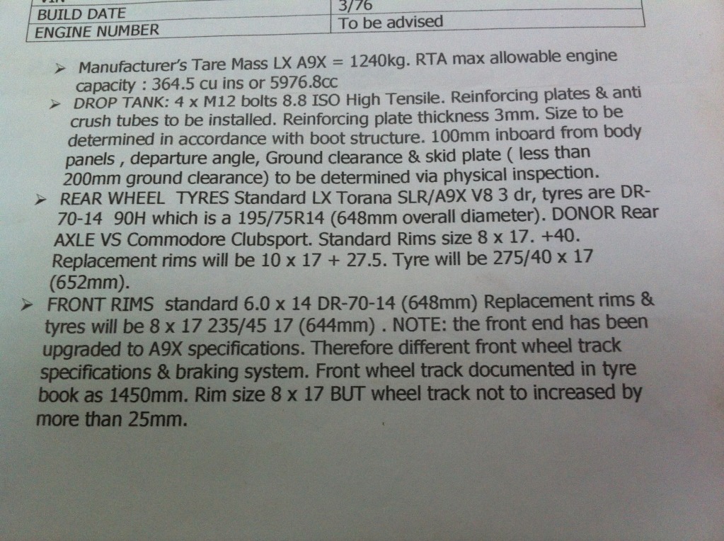

Hi Chopper. I was just looking at some other forums and i seen this one. http://www.gmh-toran...7862-a9x-specs/ you said that a A9X and L34 had 1443.2mm track on the rear. Is this correct and what is you source.
Thanks Mate.
Thanks Mate.
It is correct, I used figues from GMH. The track change is due to the difference in rim offset, nothing else.

i Dont know how the recent law changes,have affected this issue
but i can say the new wheel track,rim offset,did go off the replacement AXLE and not the OEM axle.
here it is writing,allowing me to use a commodore diff,and modify that.u cannot change the offset of the donner wheel buy more than 12.5 each side though
Edited by ass308, 11 September 2012 - 08:42 AM.

the right way up

Well they got the tyre specs wrong, but that's better for you. A DR70H14 is the equivelant of a 195/70R14 with a diameter of 625mm. I'd rather run a slightly taller tyre if it would pass.
