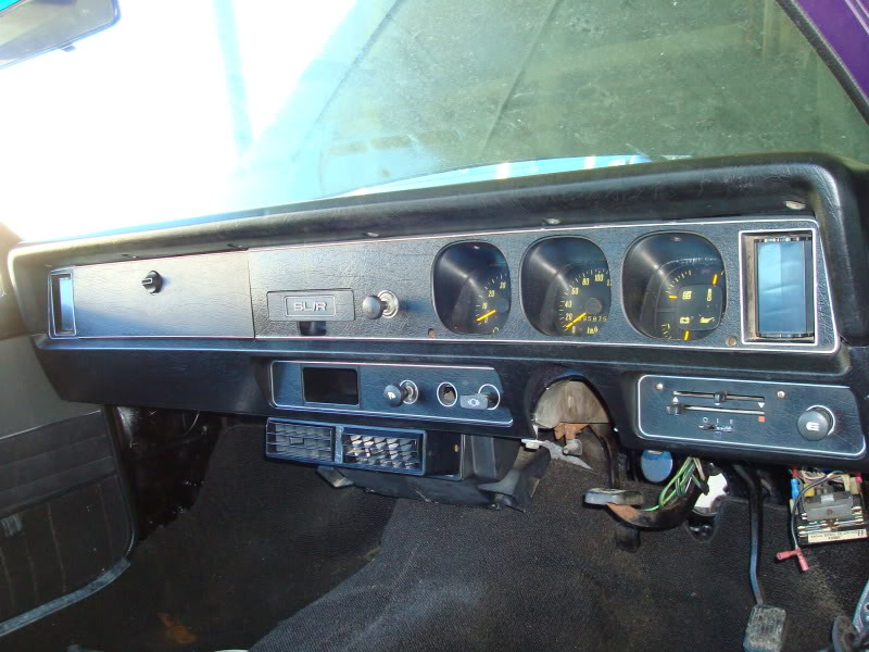

Attached File  SLR dash1.jpg   93.69K   28 downloads
Attached File  SLR dash2.jpg   79.4K   21 downloads
Talk to Zig Nelson at Dash Original 08 83963000 www.dashoriginal.com.au

LH SL/R 5000s got black crinkle finish dash fascias and black crash pads.

Maybe this one should be made into a sticky.
For LH.
S: Black 'Caribou' grain facia & Torana ashtray.
SL: Dark 'Black Walnut' timber-tone facia & SL ashtray.
SL/R: Dark 'Black Walnut' timber-tone facia & SL/R ashtray.
SL/R5000: Black 'Caribou' grain facia & SL/R ashtray.
For LX.
SL: Lighter 'Teak' timber-tone facia & SL ashtray.
Sunbird: Lighter 'Teak' timber-tone facia & Sunbird ashtray.
SL/R & SL/R5000: Silver (Portland Grey) facia & SL/R ashtray.
SS: Silver (Portland Grey) facia & SS ashtray.
