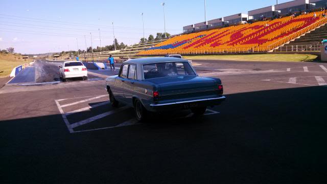

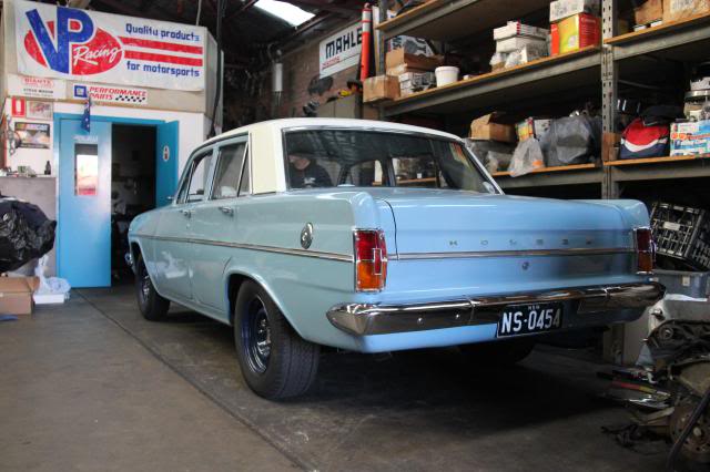

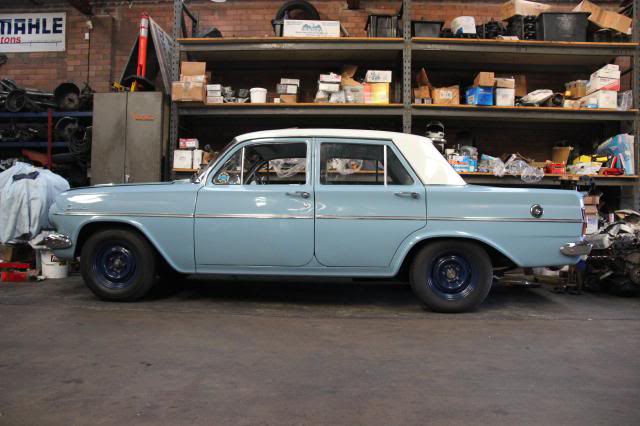

Here are some pics of the car.

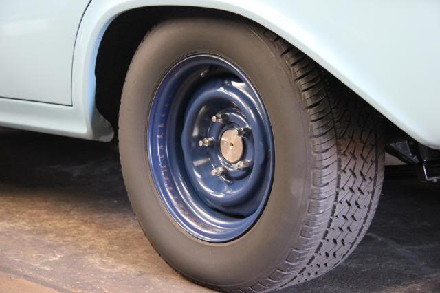

These are the tyres it run the strip on, 14" street radials.

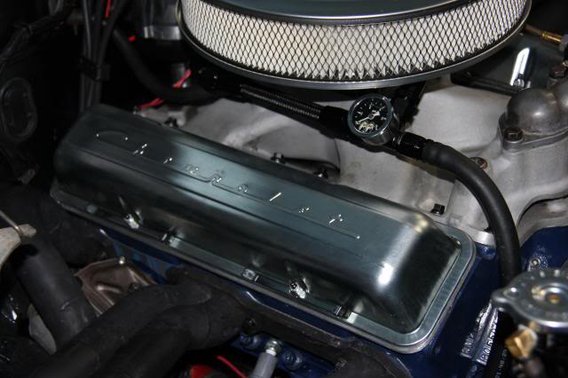

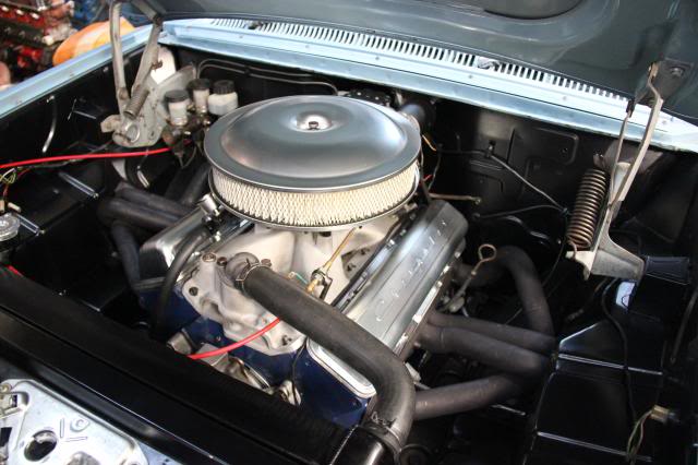

The only part of the build not done in-house is the fender pipes & exhaust. Note the factory early Corvette pressed steel rocker covers.

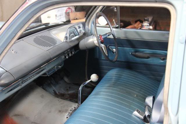

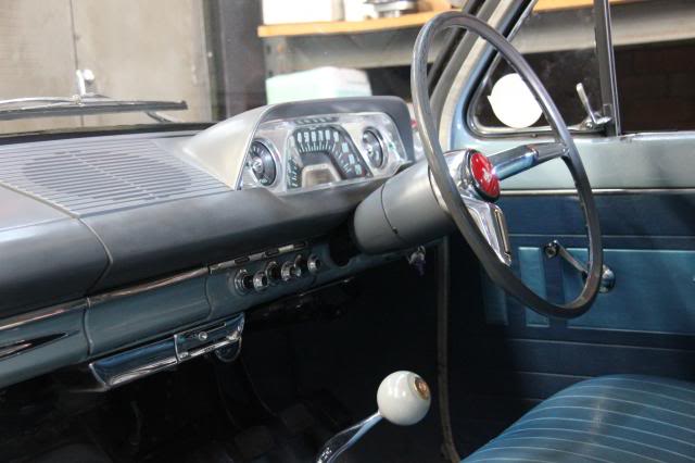

Stock 1964 spec EH interior apart from the floor shifter. Doesn't even have a radio.

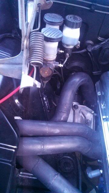

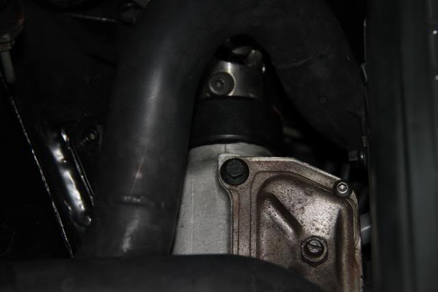

Some examples of the engineering behind this car, parts either hand made or sourced over the counter & adapted to fit the car like the dual circuit brake master cylinder that bolts straight up to the firewall & it operated by an unmodified stock EH pedal.
Standard EH steering box with modified HK steering column.

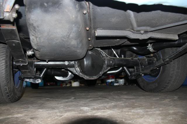

Ned wanted to keep the car GM spec, so that meant choosing a diff other than a Ford 9" but would be up to the task at hand. Chev 12 bolt out of a Camaro.
