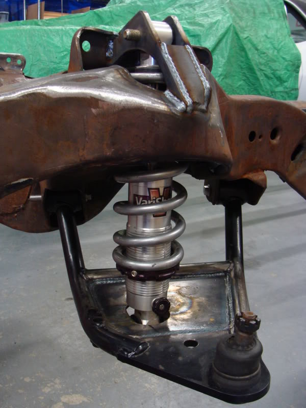

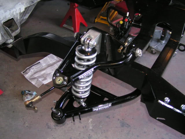

Depends on what the racing class laws allows. The stock arm mounting points and lengths/ratio are not ideal. The lower arm is too short and the pivot, shock, spring relationship is very poor. Coil over is the way to go. The whole caster, camber adjustment also needs a total re-think. In the standard components the up-sprung weight vs strength is seriously compromised.
Take a good look at some of the many ways other people have used to get an idea of what might work on a torana and see what fits in the rules either cams or licensing.

I am very interrested in what you get going here - I have wanted to do the coil overs over up front for ages by chopping off the top spring tower and using tubular arms.
Notice all those aftermarket arms use bushes for the inner arm pivots not rose joints - rose joints are not really ieal for that application.
I use the Del-Sphere's which work well on the street and track. These use Delrin bushing cups.
