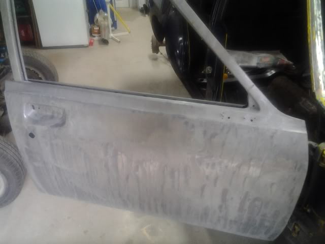

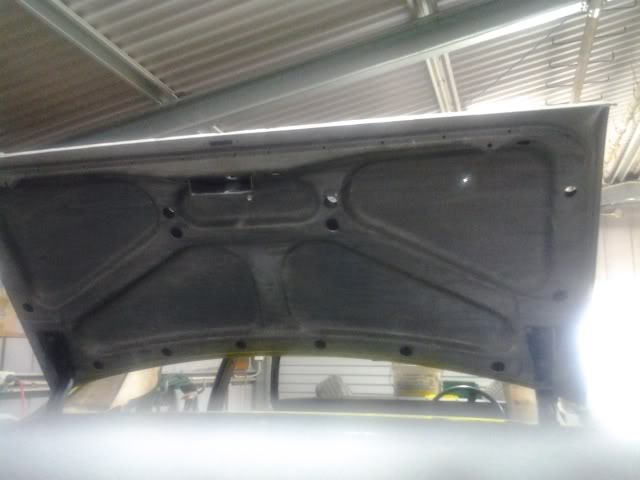

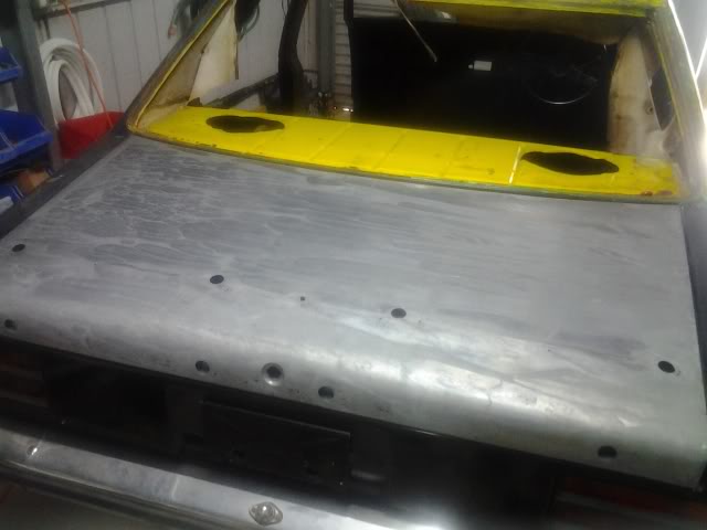

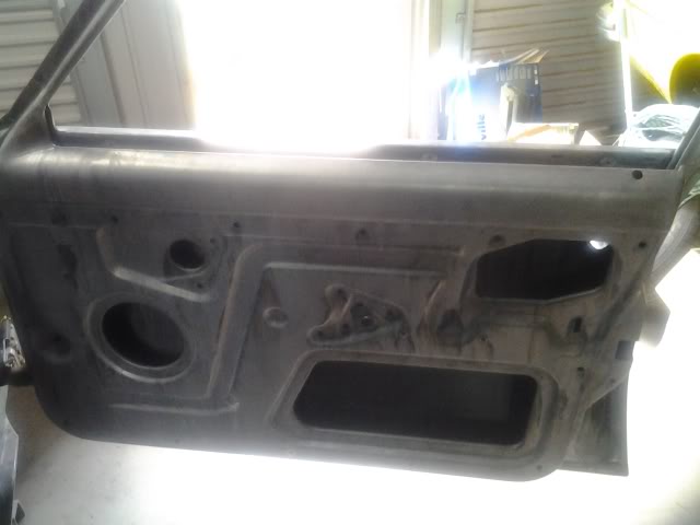

Posted 25 August 2013 - 01:04 PM
A few pics of door and boot I had done
all clean with any rust stopped
these panels have been dipped in a solution to neutralise chemical and give them a coating which gives you about 12-18 months from surface
rust starting depending how you store them of course

Did they drill the holes in the boot skin?
#23 _sloffador_
_sloffador_
Posted 25 August 2013 - 11:19 PM
No they are the original bobtail mounting holes
