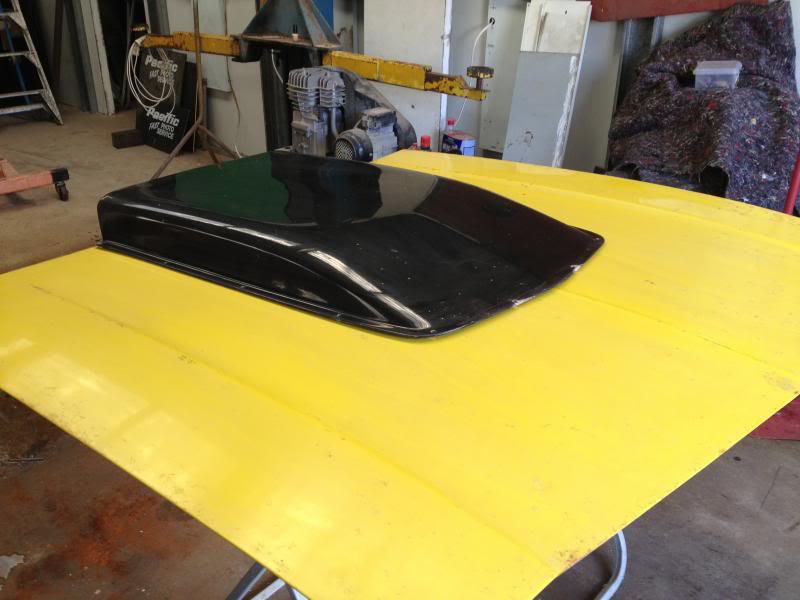

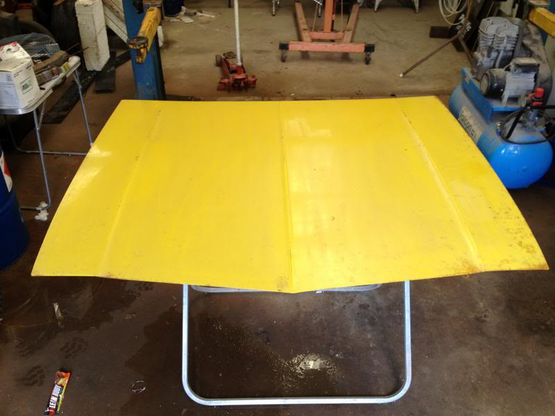

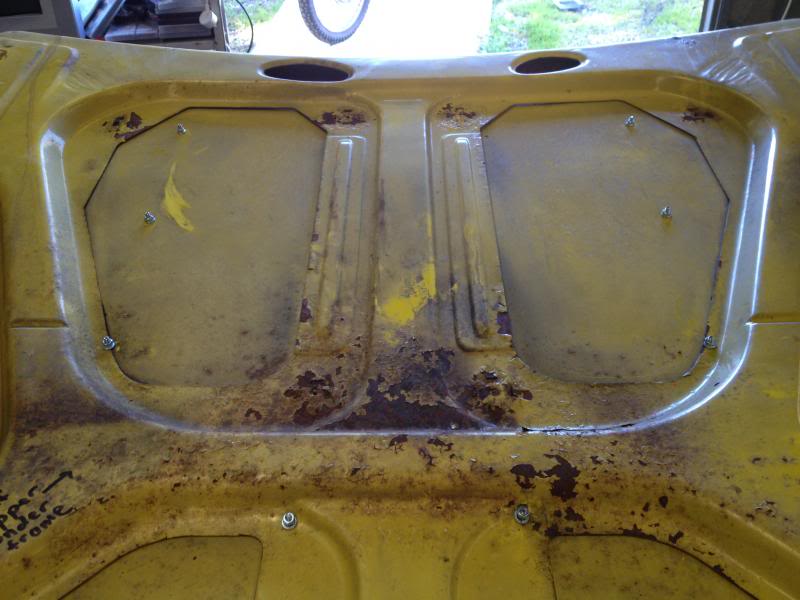

As I'm building an A9X replica I thought that I would do the bonnet now so what I start with is a standard bonnet.

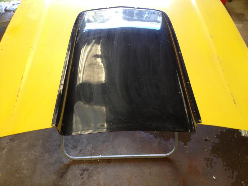

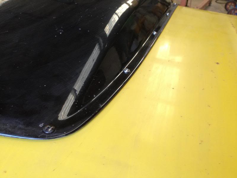

This is the scoop that I want to fit and I want to replicate how they did it on the A9X.

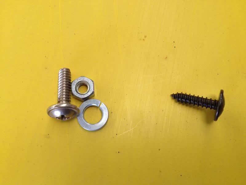

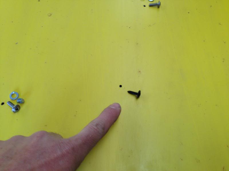

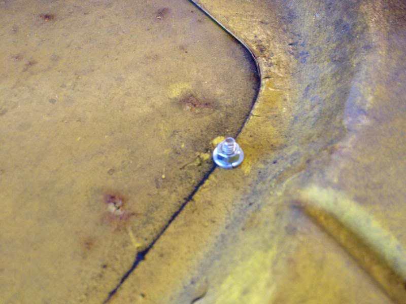

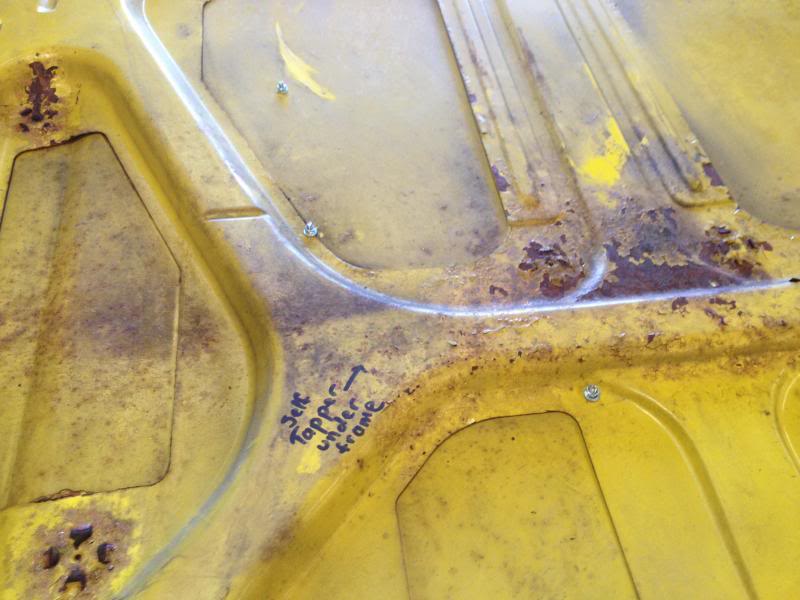

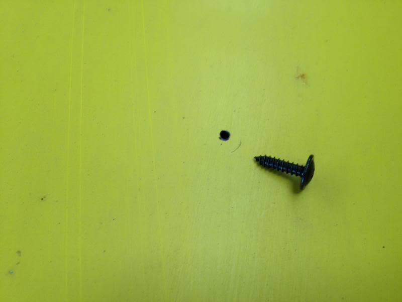

I've read a lot about people asking which screws to use to hold the scoop on as they did on the A9X. I had an idea which screws were used but I asked a few forum members to confirm which ones and they put me onto these from Rare Spares. They are same screw heads which were used to hold a Torana dash / ash tray bracket.

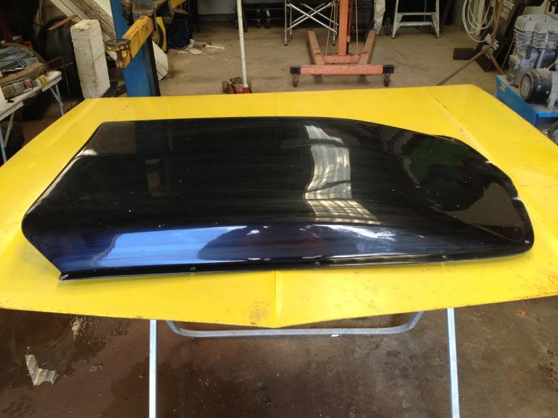

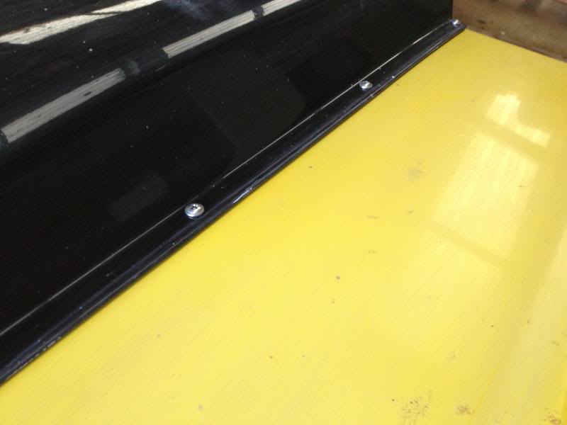

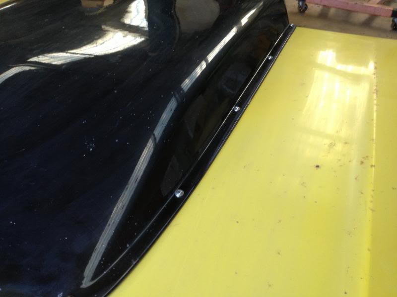

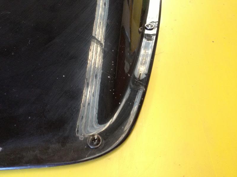

So the first this I do is position the scoop on the bonnet.

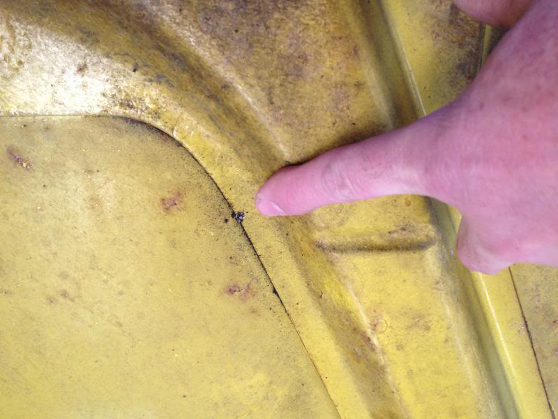

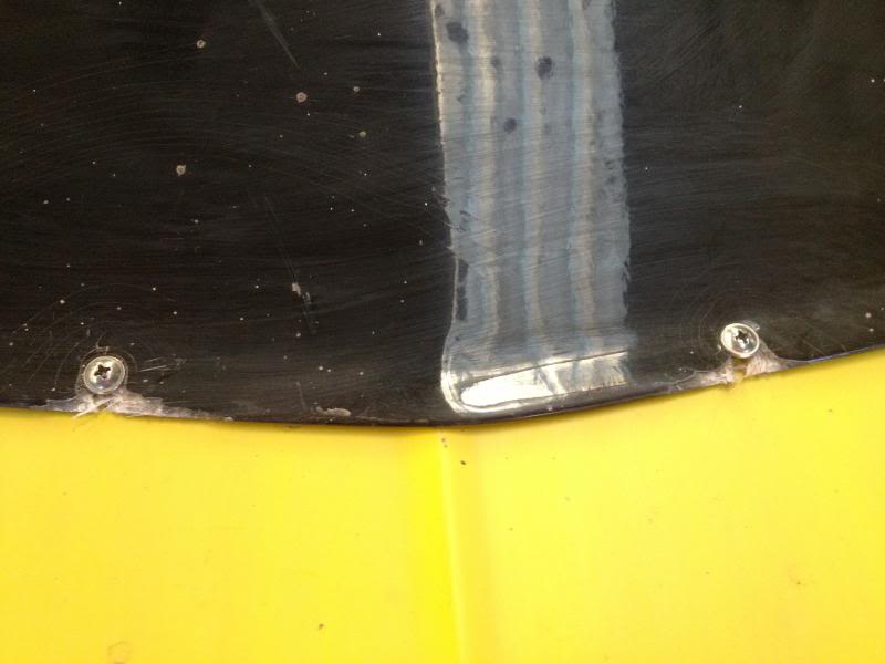

The way that they are set is the rear of the scoop is on the back edge of the bonnet and the front is positioned in the centre on the bonnet centre line.

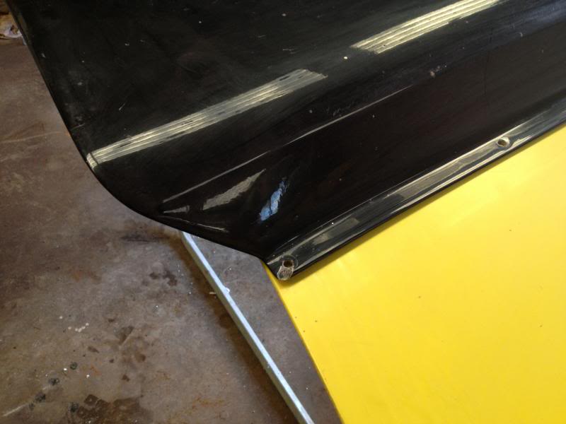

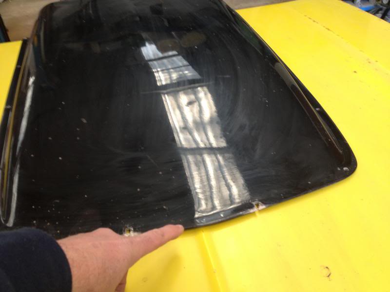

Rear edge

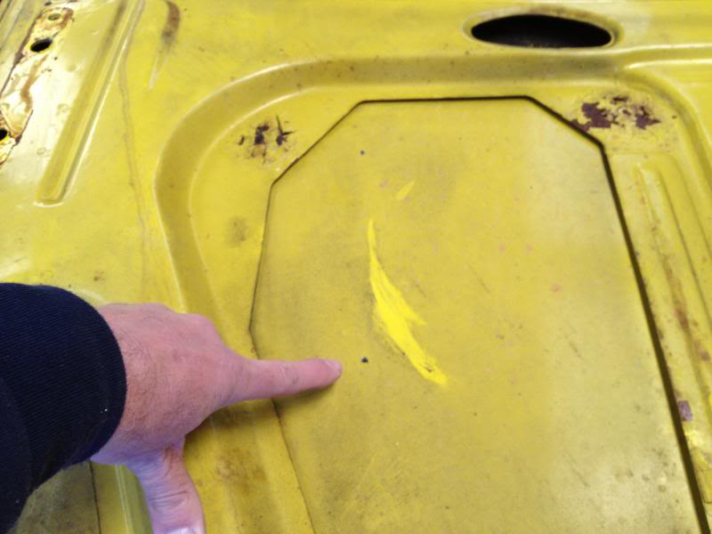

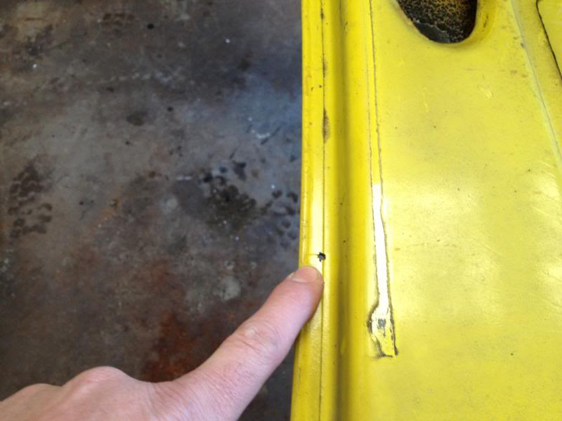

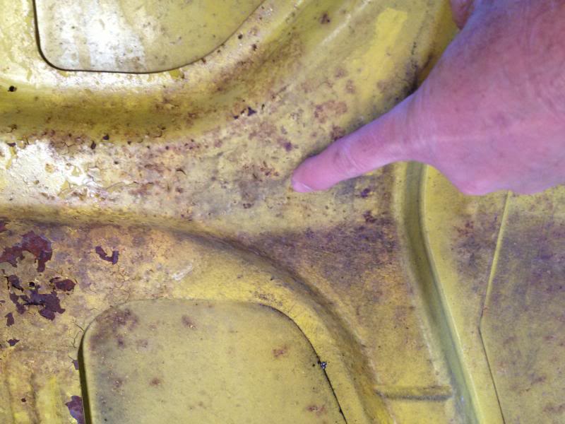

Front of scoop sitting on centre rib. When you buy a scoop they should have a slight raised bit in the centre to line up with the centre line.

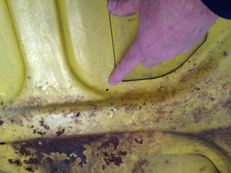

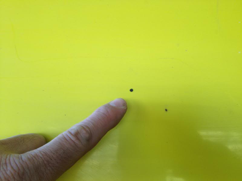

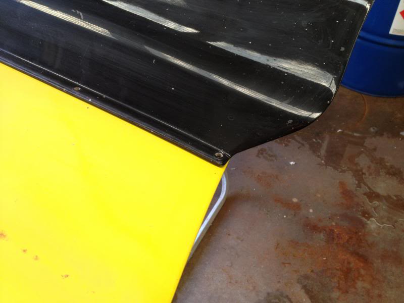

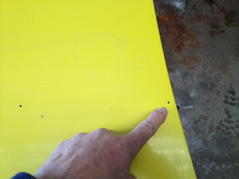

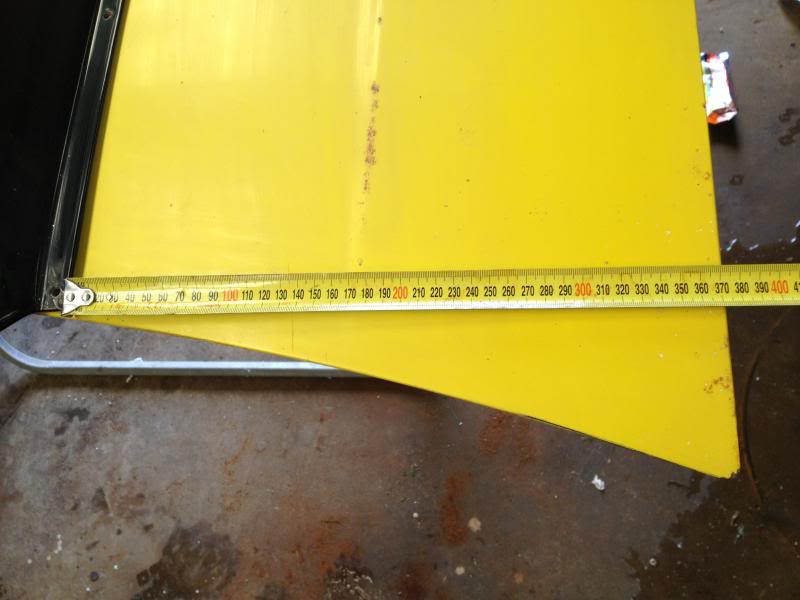

To make sure the scoop is sitting in the centre I use a tap measure to check that it is centre by measuring from the edge of the rear corner straight out to the side edge of the bonnet.

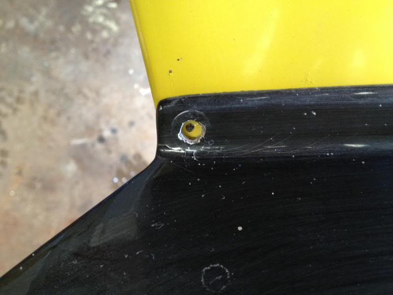

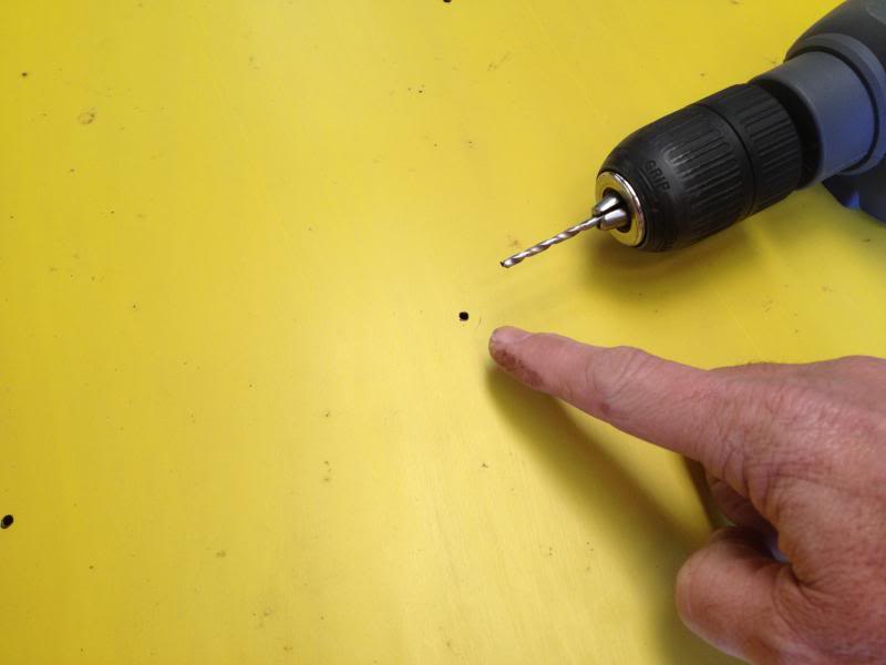

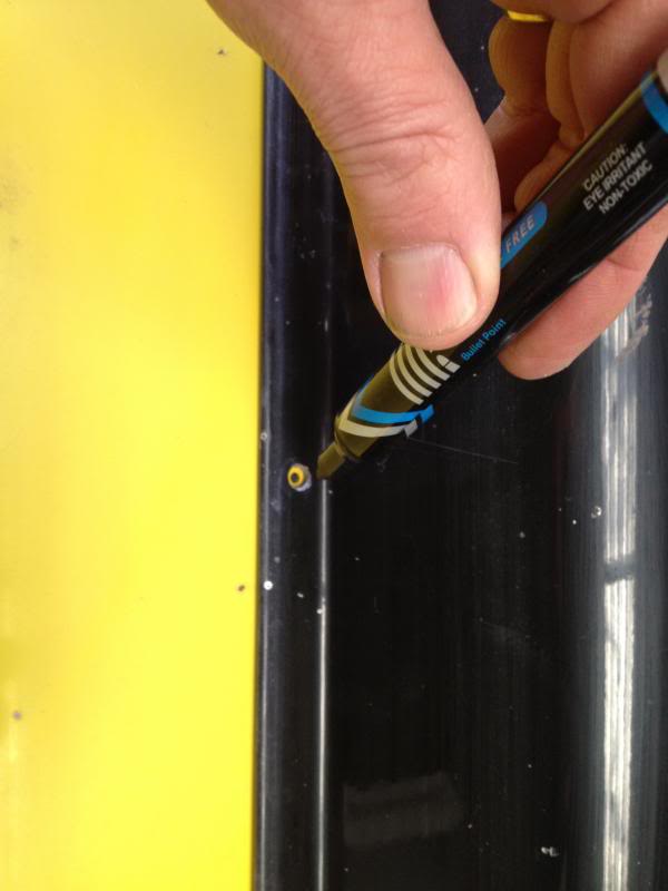

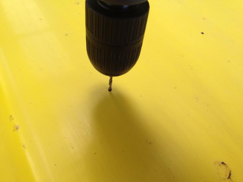

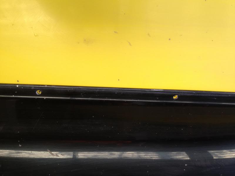

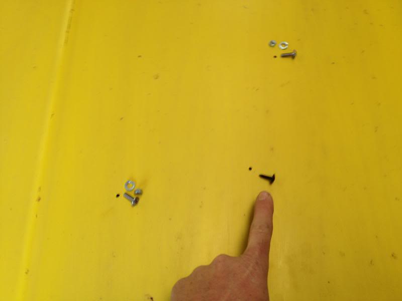

Now the scoop I am using here is a second hand one I've used before so it already has holes drilled on it. When I was happy where the scoop sitting I used a texta to mark the holes.
