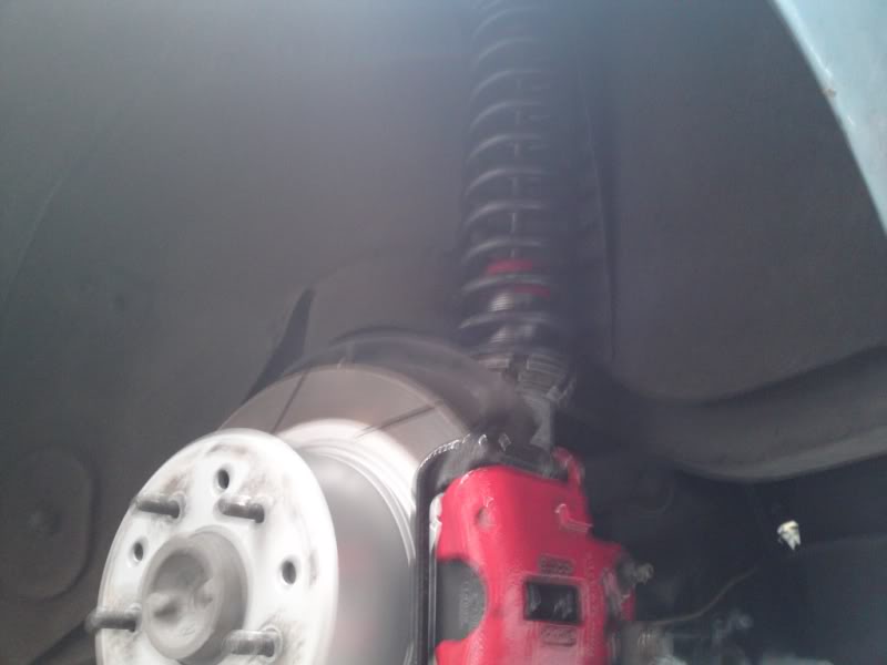

Pictures from this thread.
2wild4u
From this thread, tyre clearance could be an issue with this setup.

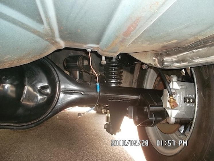

A few pics of mine fitted to a non torana diff housing.
Attached File  SAM_1492.JPG   122.19K   21 downloads
Attached File  SAM_1493.JPG   78K   16 downloads
Attached File  SAM_1496.JPG   131.04K   19 downloads
Attached File  SAM_1497.JPG   144.16K   17 downloads

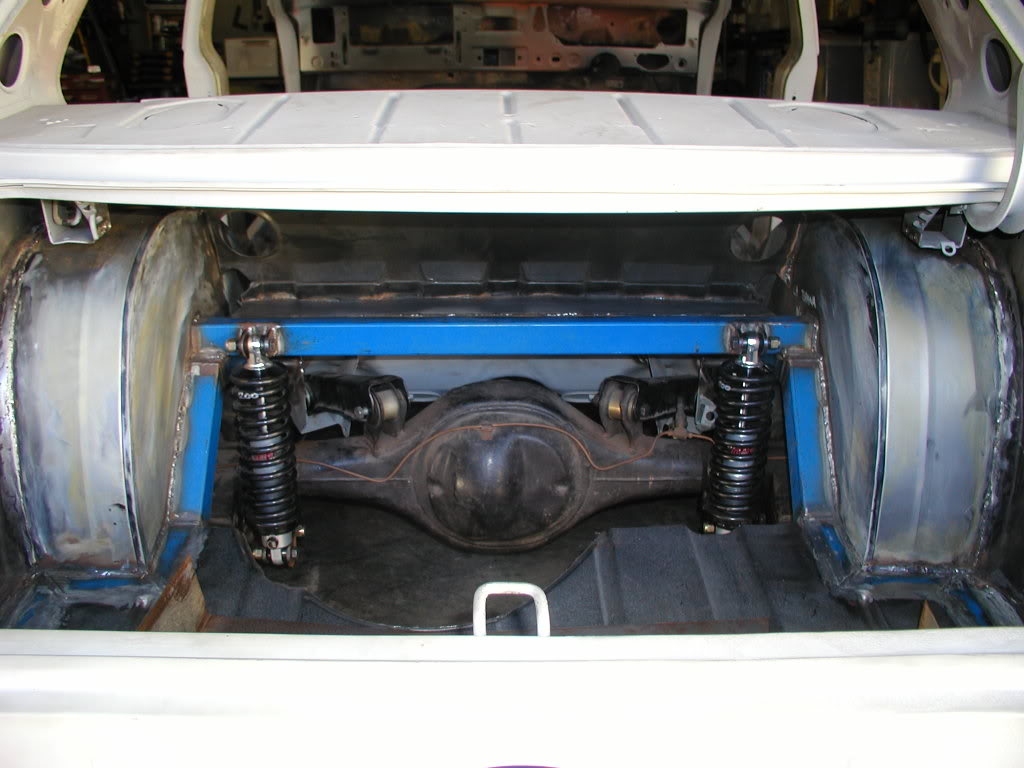

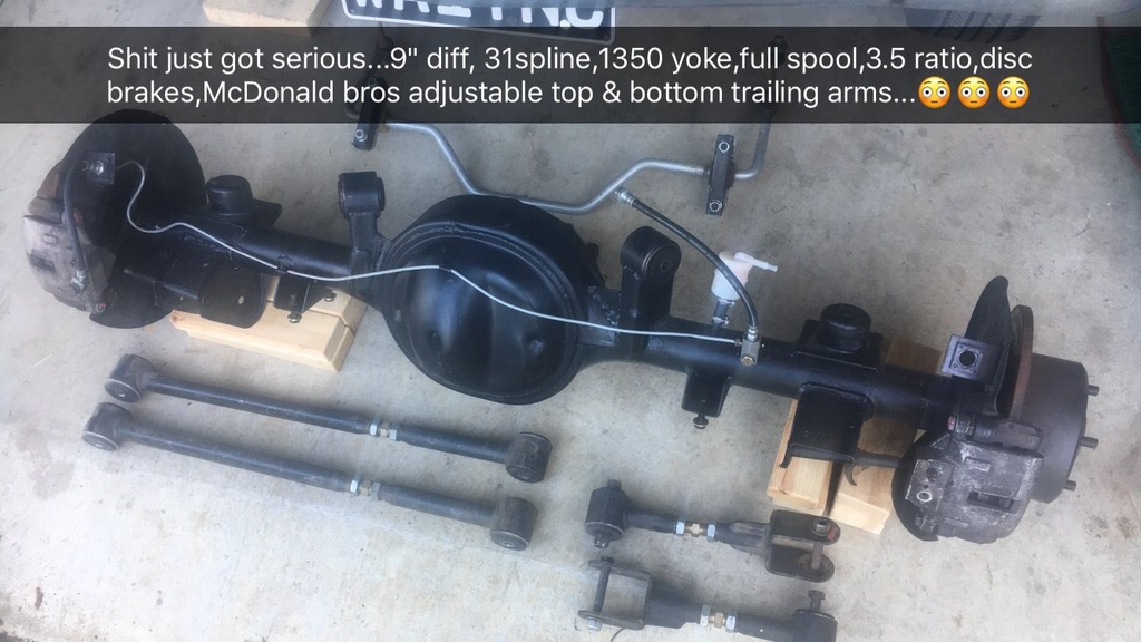

This is my boot now so that's why I ask...

As iv got all this going in next as soon as I figured out how I'm going to do the shocks & springs.
I still have the top of the spring tower but it's been flattened where the tub goes past.

Yeah as I said I got them to throw a cross bar in over the top of the diff to mount the coil overs to but was after a few different options to see which way would suit me best.
Cheers, Nig
