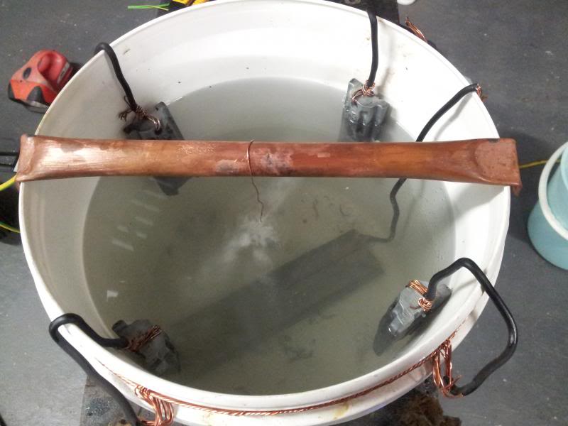

Hi Just wondering if any one has tried home zinc plating of your hard to get bits and pieces.
I gave it a go on the weekend with exceptional results, I started with my K frame to chassis rail bolts and was very happy with the outcome so I decided to try the rear trailing arm bolts and hand brake bits and pieces.
This is what I call the zinc bucket.

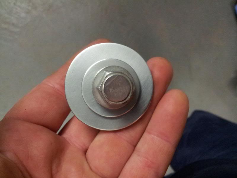

Before and after

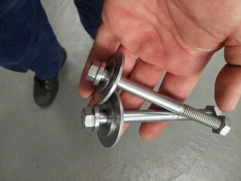

And finally the rear trailing arm bolts and handbrake parts, clips
What do you reckon, worth it or not

Things you will need to get started.
9 Litre plastic bucket
Zinc anodes... enough to surround the bucket and at least one large piece in the bottom of the bucket...you can buy this from a boat shop or chandlery very cheap $15.00 for what you see in the bucket and that's enough zinc to plate about 200 Toranas
1kg of Epsom salts
8 litres of white vinegar...coles cheap stuff $1.98/2ltrs
1.2kg of white sugar.... used as a brightener.
Some decent gauge copper wire for the anodes
A few strands of light guage copper wire for hanging parts.
1 piece of copper water pipe for the cathode hanger
1 6v power supply rated at 500Ma to 1 amp
200ml of muraic acid (hydrochloric acid) to be used as an acid dip before plating... buy this at any hardware shop.
And aluminium cleaner ( chemtech BLITZ) as this contains a small amount of phosphoric acid... for cleaning the plated parts to a bright shine.
Small stainless parts cleaning brush....supercheap autos
And a little fine grade steel wool.
Method
Electrolyte
Mix Vinegar, Epsom salts and sugar together until dissolved in the bucket.
Cut your anodes into equal sizes and drill a 6 mm hole in each piece, then attach reasonable lengths of the heavier gauge copper wire to them and place them in the bucket at equal spacing.... bend the wire over the edge of the bucket to support them in place and wire them in such a way that they are all connected, refer to the first picture.
You now have Zinc anodes ready to go.
Next get your copper pipe and flatten the ends the same width as the bucket so it doesn't roll and while doing this squash a piece of heavy gauge wire in one end... this will be your cathode hanger.
Place this on top of the bucket and make sure it is not touching any of your anode wiring or it will short out.
Grab your power supply and cut the pin plug off the end and strip each wire back about 40mm and twist up tight.....the wire with the white strip on it is the positive+ and the plain black one is the Negative-.
Attach the positive to the anode (Zinc) wiring and the negative to the cathode wire (copper pipe).... turn on power and your almost ready to start.
Now before plating your good parts you need to plate out the electrolyte... this sets up the solution for complete surface coating.... this means you have to get zinc ions in the solution for it to plate quickly and evenly.
To do this you need roughly a square piece of say body metal about 50mm square that has been wire brushed of all contaminates and dipped in the hydrochloric solution (will get that in a minute) and hang this submerged in your electrolyte with the power on. You should see a slight fizzing going on....this needs to run like this overnight if possible.
Hydrochloric solution.
1 litre of water to 200ml of acid mixed well.....wear gloves and glasses as this stuff burns like nothing else and will blind you if you get it in your eyes. :furious:
This will be your parts dip..... keep another bucket of plain water handy to rinse parts after dipping.
Parts cleaning and plating
I clean all dirt and grease of the parts before doing anything else....use a water soluble degreaser in a spray can... cheap stuff will do the trick.
Then hang your parts in the hydrochloric solution... you may see some fizzing going on, this will be the previous zinc coating being dissolved by the acid and this will also remove surface rust.
After the fizzing has stopped rinse the part thoroughly and dry off with a rag.
Next you need to wire wheel the part back to bright steel.
Once that is done dip your part into the hydrochloric acid quickly and then rinse quickly then hang in the zinc bucket submerged, if you wait to long to hang it, it will flash rust and you will have to start again.
Now that it is in the zinc bucket you can let the system do its stuff, you see some fizzing and that's good, it is now being plated with zinc. Leave it in the zinc bucket for 30  minutes or until completely plated evenly
When you pull the part out it will have a blueish grey appearance however it should be completely coated in zinc.
Brightening up the part.
I use a week solution of aluminium cleaner (chemtech BLITZ) available at auto stores mixed with water
Dip your parts in this one at a time and using a stainless parts cleaning brush brush the parts to a bright shine then finish of with fine steel wool.... when satisfied rinse off with water and dry. ( wear gloves and glasses when doing this.) :furious:
You can replate at this stage if you want a heavier coating of zinc then repeat the cleaning procedure.
There you have it, very long winded instructions but it sounds more complicated than it really is.
Once your set up and going its really simple and very satisfying to plate your own parts back to new.
The total cost of all the above was $35.00 and this set up will do all your parts, all your friends parts with heaps left over.
I done all those bolts on Saturday in between working on the torry.
Its not hard and does a good job and saves you running around to the platers with small parts that tend to get lost.
I just like doing all my own stuff on the car if I can cause I find it enjoyable when some one asks who done that, I can say I did lol.
If you haven't got the patience stick with your local plater... no worries.
Al :clappin:
Just an addition... don't use any power supply over 1amp max for doing small parts as this will burn the plating black and that's not good, 500ma is great for small parts but if using a 1amp supply you can plate several parts at once as the amperage is balanced out by the surface area of the parts.
Ie 500ma will plate 2 bolts and 2 washers and 2 nuts at once or 1amp will plate 4 bolts 4 washers and 4 nuts.
Edited by slar, 03 September 2013 - 09:32 PM.
