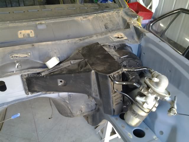

I have a genuine a/c unit that im putting in my lh
#8 _Gunmetal LH_
_Gunmetal LH_
Posted 03 November 2013 - 05:33 PM
rodomo what model is it from and does it 'look' like it will fit?
#9 _sloffador_
_sloffador_
Posted 03 November 2013 - 05:37 PM
It will fit you replace the existing fan unit under the bonnet with this one and it ducts into
the car via the heater box but I have the vacuum operated box with the correct a/c controls
ill post some photo's if you want

Original a/c unit replaces existing blower
Ducted into car but the internal heater box is fitted with vacuum controls to change from heat to a/c
But it is still a genuine torana box inside
Just don't know how good its going to work am having all the internal plumbing upgraded and hidden a bit better
Oh and relocating the ugly dryer cylinder

Your proberly right and I think you've given me the incentive to construct a system under the dash
While getting other stuff done
Ill most likely lose glove box
Any ideas would be appreciated
