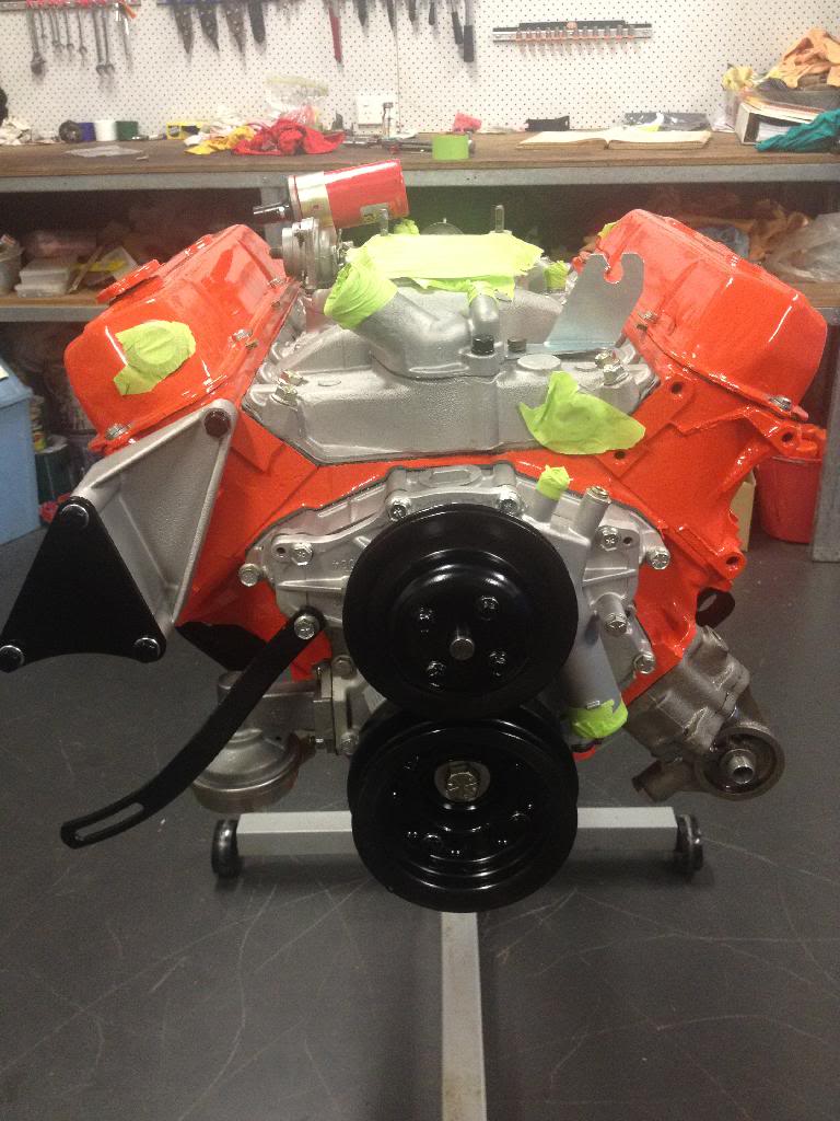

Have I got the wrong bracket? Trying to attach the alternator to a 75 LH Torana with a 308. The chassis rail/panel is stopping me from putting the alternator in the correct position for mounting. Have the Toranas got a different mounting bracket to other 308's? My bracket has got 2811891 HOLDEN 203 2 stamped on it. Thanks in advance for any help.
  • Attached File  1.jpeg   213.75K   8 downloads
  • Attached File  2.jpeg   202.14K   4 downloads
  • Attached File  3.jpeg   197.16K   3 downloads

That's wrong alternator bracket...lh/x go other side of engine run down beside engine fit inside chassis rail.
You'll probably have to buy new one..look up on rare spares site or ebay.

I may have one laying around, i'll let you know if i can find it. Or yeah rares sell them TMK.

Lower bracket mounted in the incorrect location.
Where is the correct position?
