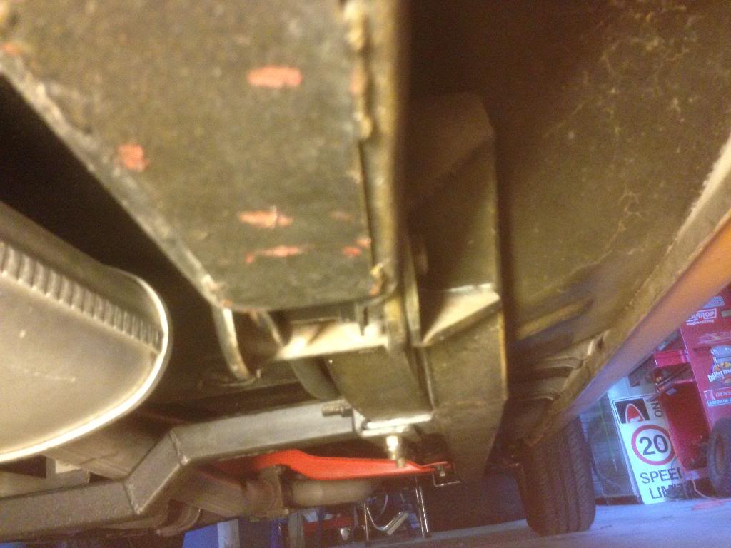

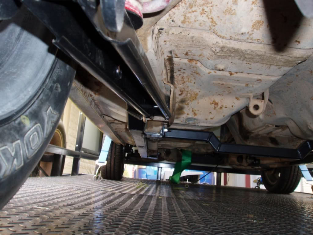

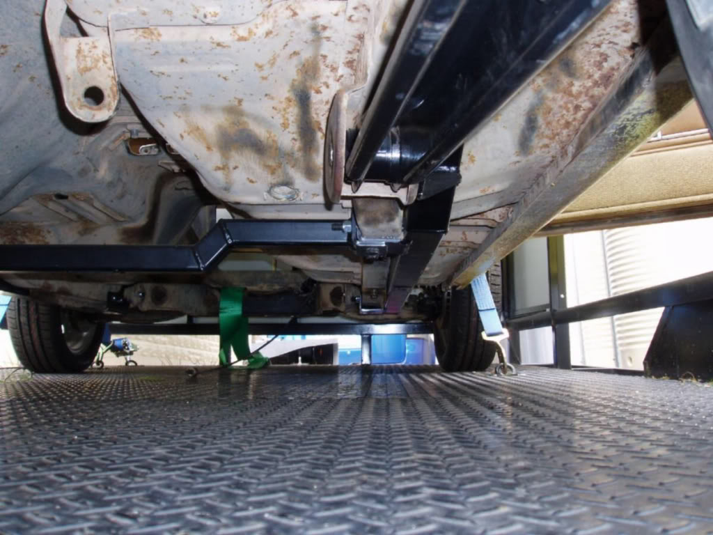

As the title suggests I was wondering if anyone has pictures (or is willing to take some) of a fitted lj chassis strengthening kit.
I've found someone that is willing to fabricate one for me but wanted to see photos of it on the car so he knows exactly what he is making and can then measure it up on my car.
Thanks!

I could take a few with my phone and send too you if that helps?

They run next to the factory rails with 1 brace between the 2 rails under the rear foot well.

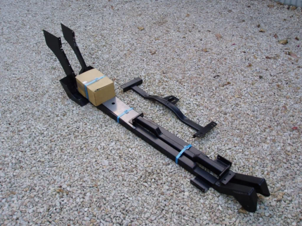

I've got some pics off google.
The last pic is what I'm making. It's much cheaper to make your own and it will fit better
Cheers tubo

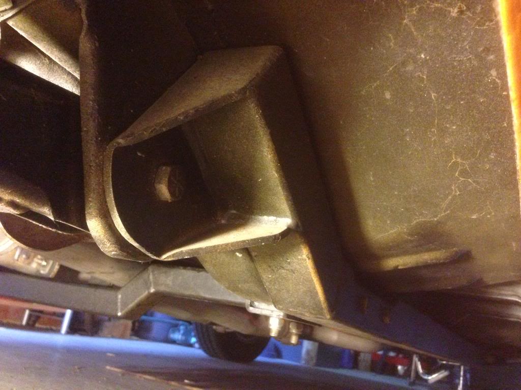

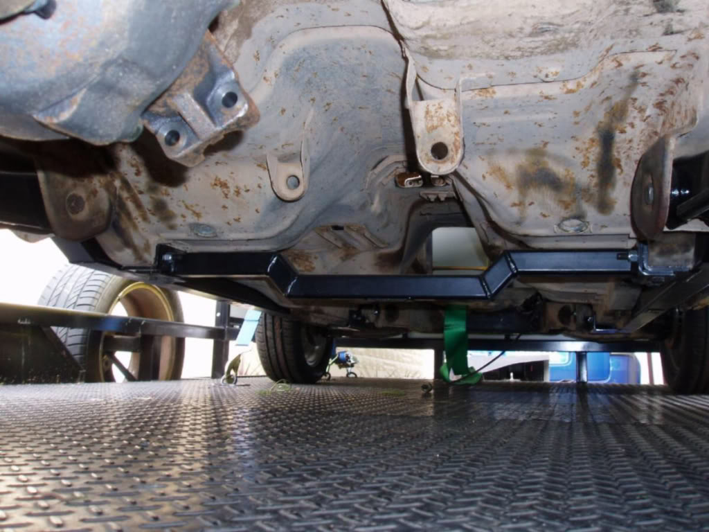

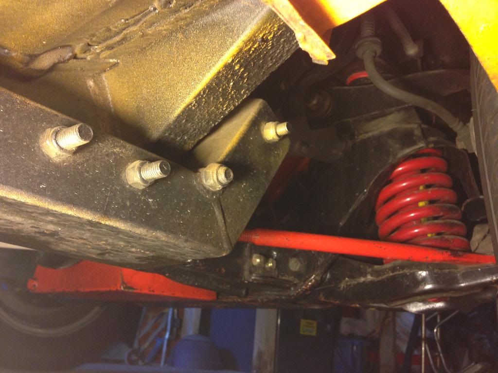

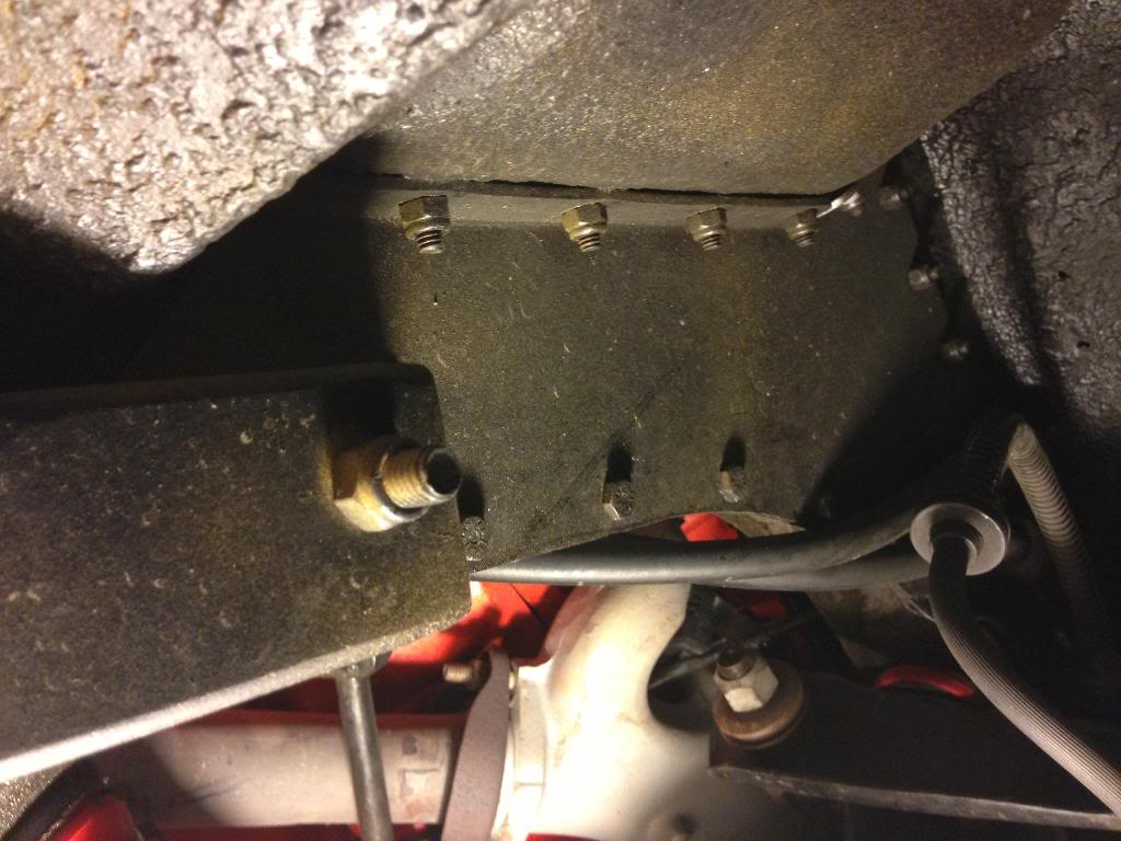

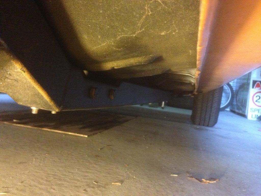

348881A4-8657-4E2D-8EDA-FB8ABA67D27F_zps
034ABA40-8640-4203-8741-9DEB1705AC11_zps
CC19553B-1F04-44FF-B350-6D35BA083E5C_zps
616C1645-71C1-490D-AA91-9E37D2E74D3D_zps
862A1031-EF6A-46BF-8EA5-936FE527E5B9_zps
076FF331-6B6A-4690-B1EB-F605096E13A6_zps

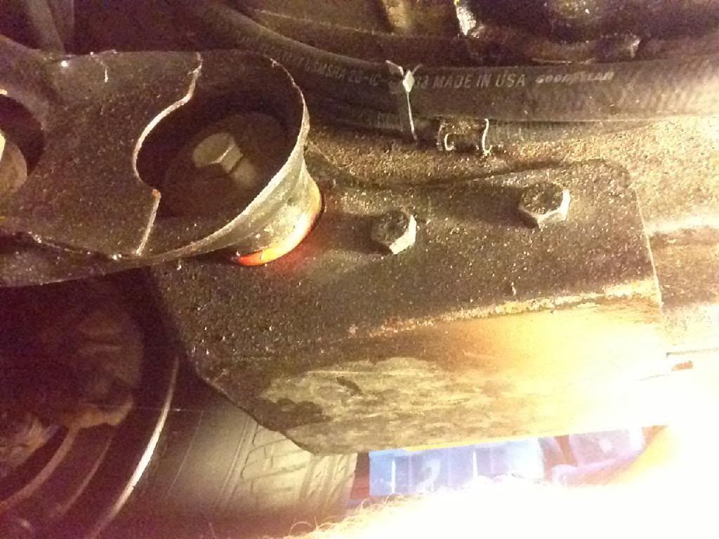

Thanks Jason for the pictures.
In the first picture,is that plate cut around the bush or is it just a shadow?

I couldn't tell you mate, these are the photos that lj Dave sent me.
I found some more pictures to on an old build thread so I'll post them up to.

That bolt is not cut for that rubber. It goes behind that's how you support the chassie when you do the front end up. The picture is just a shadow.
