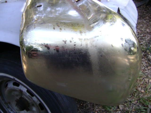

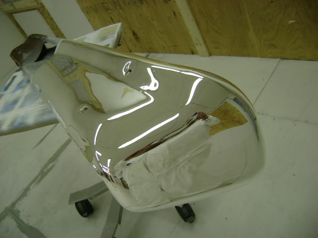

Dave at Gas 78 Industries in Malaga has an expensive set-up for spray chrome but like everyone I have seen its fine if you keep your car in the dark and out of the sun  ........ or else you have to re-do them often.
After bumpers get new spray on chrome.
Once they get 6 months of sun the above bar ends up like this with chrome paint.
I have looked at all the Chrome paint systems in the world and this stuff doesn't like prolonged sunlight which is why they use Vinyl Wrap for those Chrome Cars like the Lexus LFA they did in QLD.
Edited by LXSS350, 02 June 2014 - 11:06 PM.

Dave's actually in Wangara and im pretty sure he is using Spectra-Chrome, Nah had not thought about getting the gear for it Neil... too much on our plate already. If thats really how it looks after 6months in the sun tho (as in the above pics) I think ill be avoiding it.
