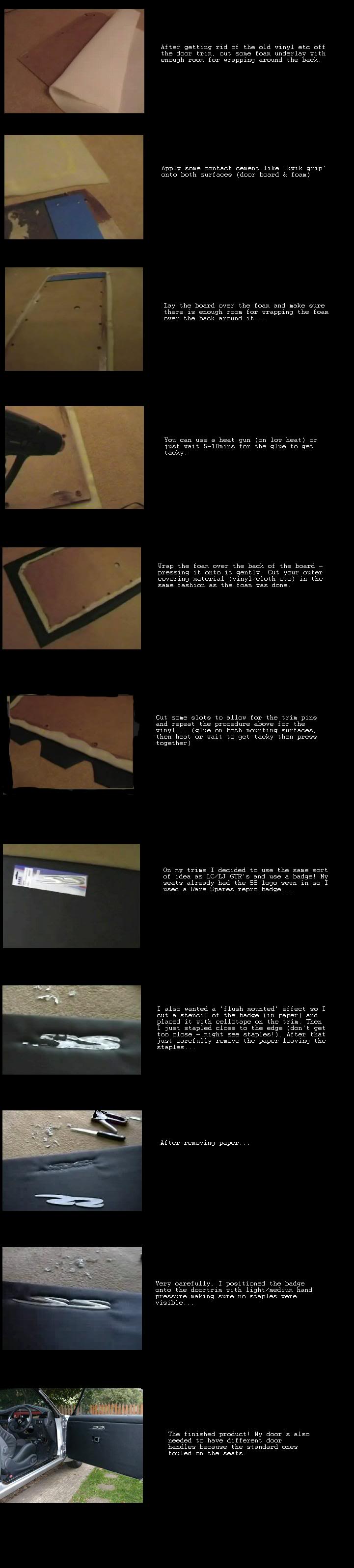

I have made numberous trims for my cars over the years! being a cabinetmaker it is a relatively easy task but not that hard for someone handy. All you need to do is trace the outline of the trims you have and drill holes where you need to for both handles, winders and also the fixing clips.
I always have used MDF to make my trims out of rather than the masonite which was commonly used back then. The mdf is far stronger.
If you need anymore help send me a PM
