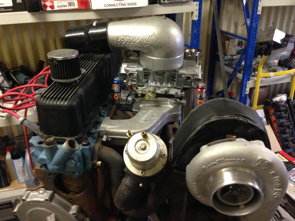

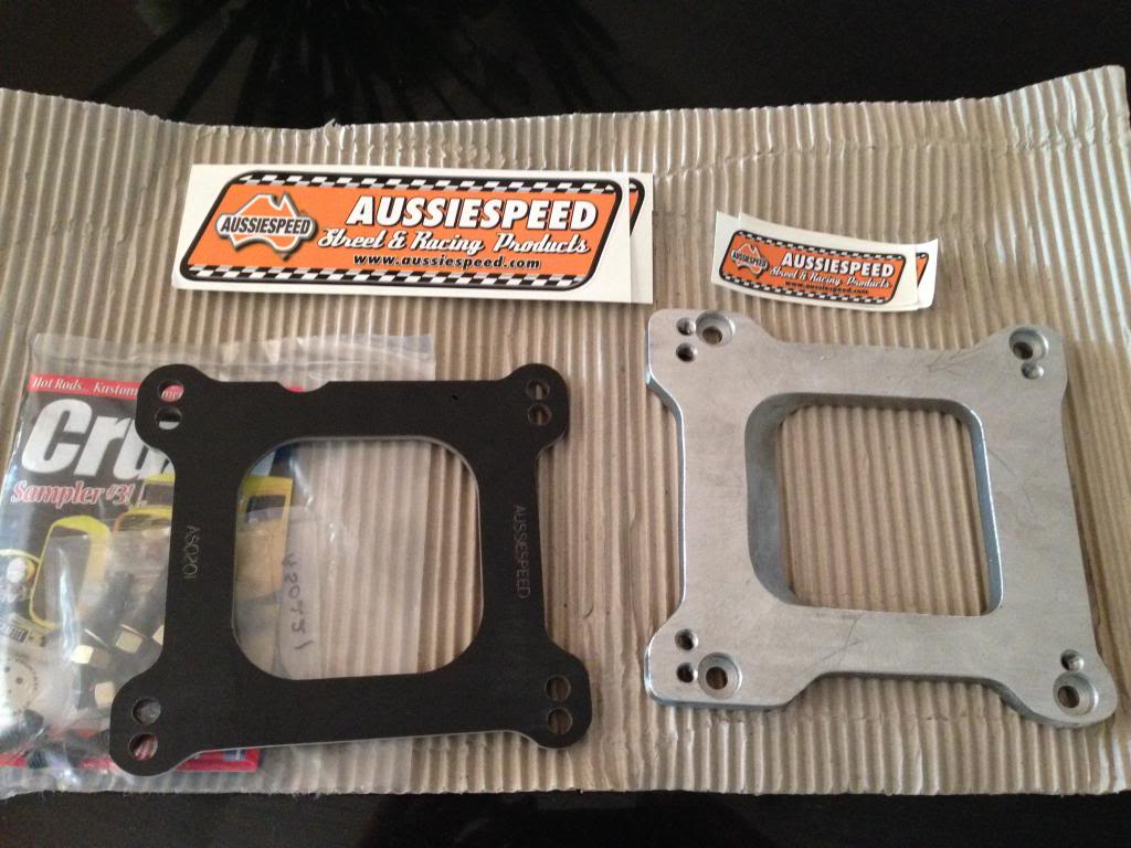

Aussiespeed have just made an adapter that bolts to the existing 4 barrell mounting plate and converts the flange to accept a Holley spun 90 degrees...I think Stinga just got one actually!!
#7 Stinga
Stinga
  • 2,114 posts
  • Name:Stinga
  • Location:Wollongong, NSW
  • Joined: 05-December 05
Posted 17 July 2014 - 08:59 PM
indeed he did.....
4E1F0AA9-B5AC-4786-8BEA-8F17369135F7_zps
D842B36C-7FEB-48EC-A6D4-3BBA242898E7_zps
#8 _stretchlc_
_stretchlc_
Posted 17 July 2014 - 09:02 PM
Look at that pretty blow thru booster would ya!!.....cheers for the prompt upload champ!
#9 _Bomber Watson_
Yes but im not fond of the aussiespeed manifolds.
Suppose its an improvement, but they should have designed the frOcking things properly in the first place, there shoudl be no reason for you to spend money on a seperate adapter to get it how it should have been from day dot.
#10 _stretchlc_
_stretchlc_
Posted 17 July 2014 - 09:10 PM
Was just to let those know that theres an adapter available to save re drilling and adding alloy to your aftermarket manifold in order to spin a Holley sideways. True........Mark should have cast a heap to give those the option to run their carb in either configuration.
