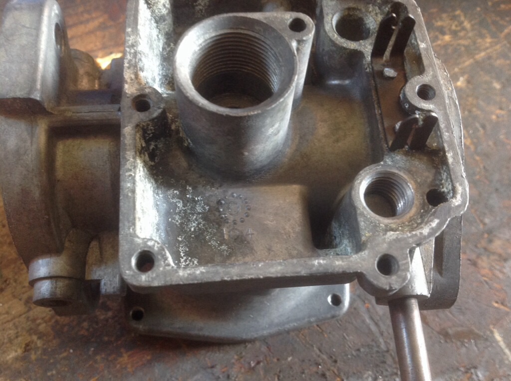

#7 S pack
  • 15,795 posts
Posted 25 July 2014 - 05:57 PM
Ken, this one is 1970 vintage. The 0 inside the circle of dots is the year and the dots represent the months of the year.
Is this one a 128, 128A or 128B?
Edited by S pack, 25 July 2014 - 05:58 PM.

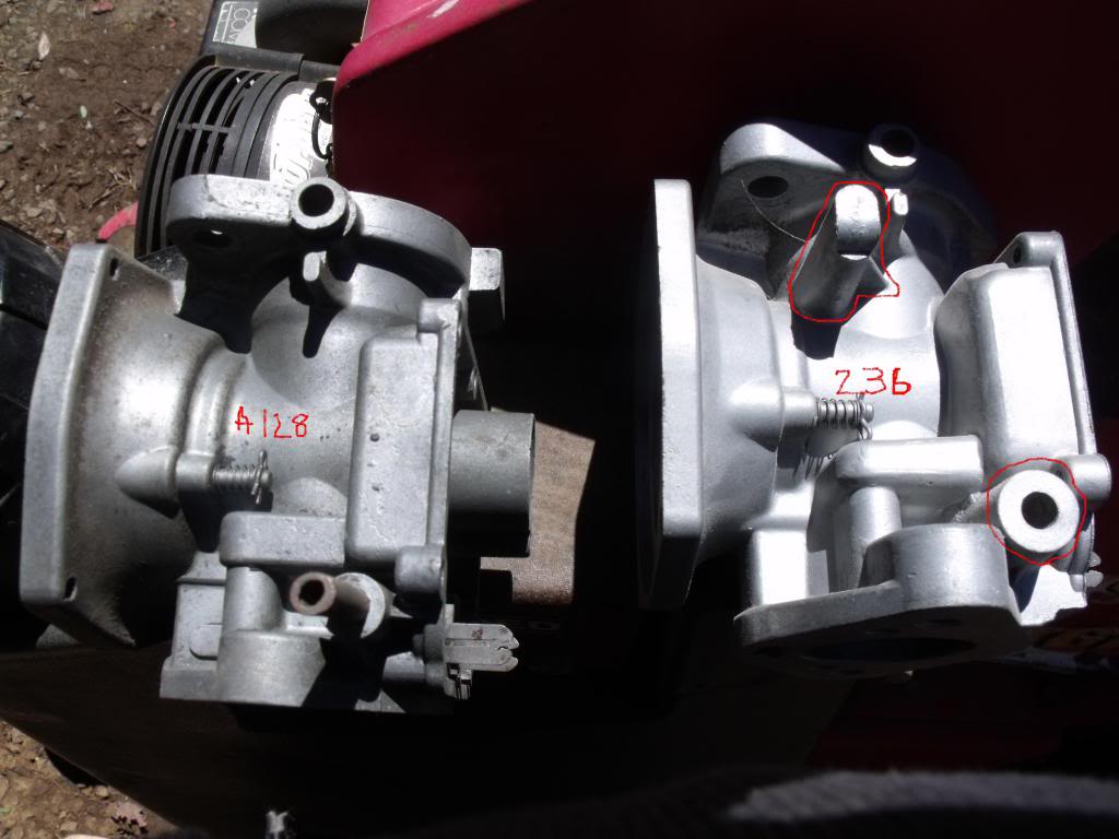

#9 _LONA-CK_
_LONA-CK_
Posted 25 July 2014 - 07:11 PM

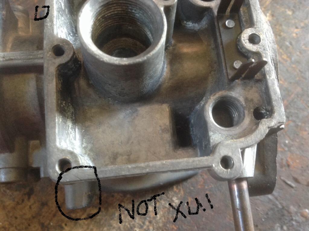

here is a lesson in the 150cd carby.
sometimes they at the carby body factory forgot to put down the A-OR-B and sometimes they did not put the A OR B next to the 128. it could be somewhere else on the face of the carby
in this pic of the 1970 cast date the dots are a clock from 1 to 12 you will notice that the big number 8 dot as a small tiny dot inside the clock next to it and then the next small tiny dot is number 11 so that carby would suit any lc xu1 built between the 8th and 11th month of 1970
post-24095-0-98295300-1406264031_zpsc908
you will also notice in that pic that i put a black mark on this part that a xu1 carby should not have but it will have the small bit at the back of the carby,,,that also means that this carby is no good for a xu1
now to the 6E and 6N NEEDLES someone at some stage has changed the 6E needle out of the 128B carby and replaced it with a 6N needle witch where used on the earlier cars
cheers gong

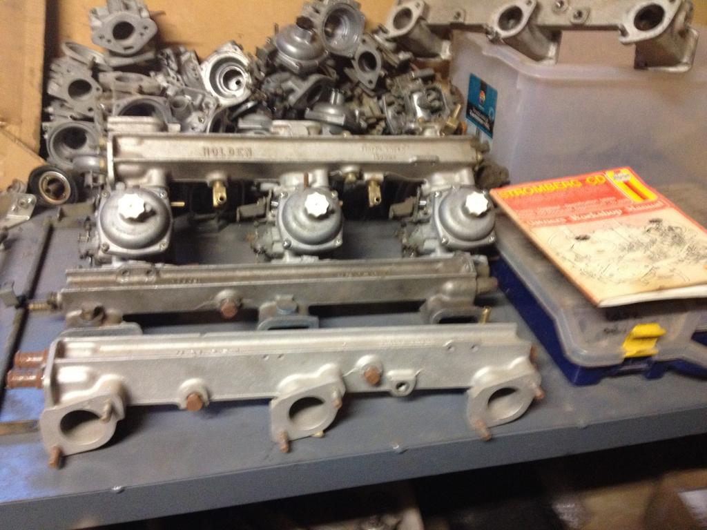

#16 _LONA-CK_
_LONA-CK_
Posted 30 July 2014 - 05:34 PM
plenty

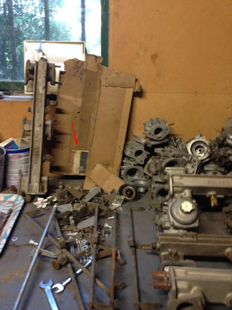

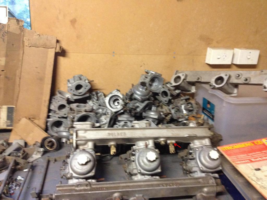

here with the red arrow is a nos box
and the nos part that came from the box, you will notice with this arrow the original holden goo around that brass fittings

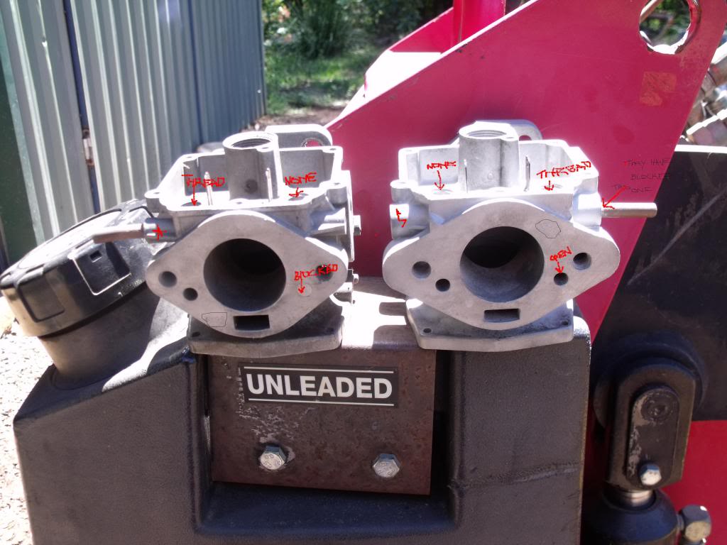

here is some pics of markings i done on original lc xu1 carbys and none original xu1 carbys
cheers gong
