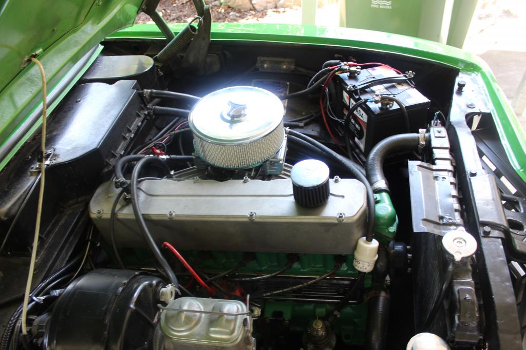

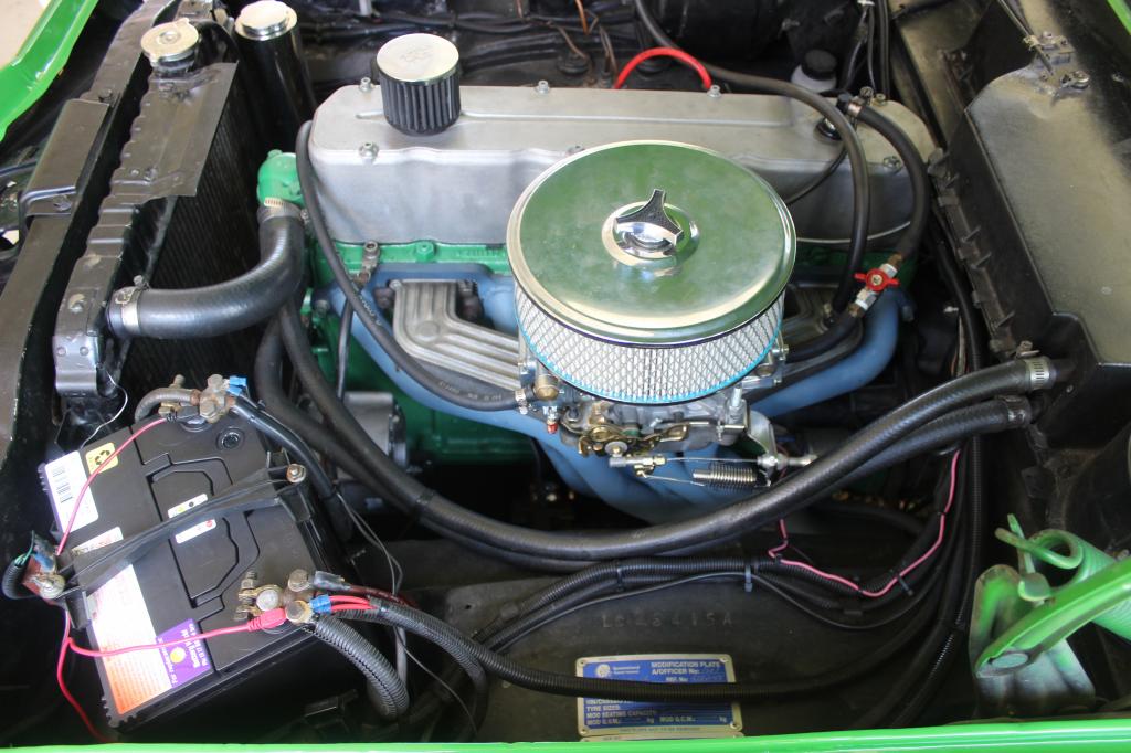

I know there are several types of manifolds, but I'm not completely sure on the differences between them.  I also want to make sure that they'll fit in my engine bay, I've included some photos of the current setup below.

The battery is in the way for triple set up
DazM

Got any dimensions I can use to relocate the battery tray so that it's out of the way?
#18 Ice
Posted 13 February 2015 - 06:41 PM
Whip that tray out and buy an XU1 tray from Rares and battery to suit easy fix

I just got a new battery! Arrrgh
#20 _Bomber Watson_
Posted 13 February 2015 - 07:10 PM
THen put it in the boot.
Edited by Agent 34, 13 February 2015 - 07:49 PM.
#22 _Agent 34_
_Agent 34_
Posted 13 February 2015 - 07:52 PM
sorry spastic post - but thats how much i needed to cut out of the standard battery tray to clear the fuel bowl on a 1.75 su on a lynx.
I dont have another photo but you can get the drift of what needs to be removed by the bolt and lug to hold the battery in
