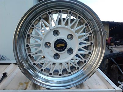

#16 Bigfella237
Bigfella237
    Socially Distant
  • 4,396 posts
  • Name:Andrew
  • Joined: 31-October 14
Posted 09 April 2015 - 09:10 PM
Attached File  DSC02965-X2.jpg   408.7K   6 downloads

#22 Bigfella237
Bigfella237
    Socially Distant
  • 4,396 posts
  • Name:Andrew
Posted 12 April 2015 - 08:09 PM
big fella what was the rim you posted!?
About three thousand bucks I suspect...
Dunno what it's off, just a picture I found somewhere on the interweb.
#23 _LS1 Hatch_
_LS1 Hatch_
Posted 13 April 2015 - 01:27 AM
HRE's are not bargin priced normally, that is for sure!
