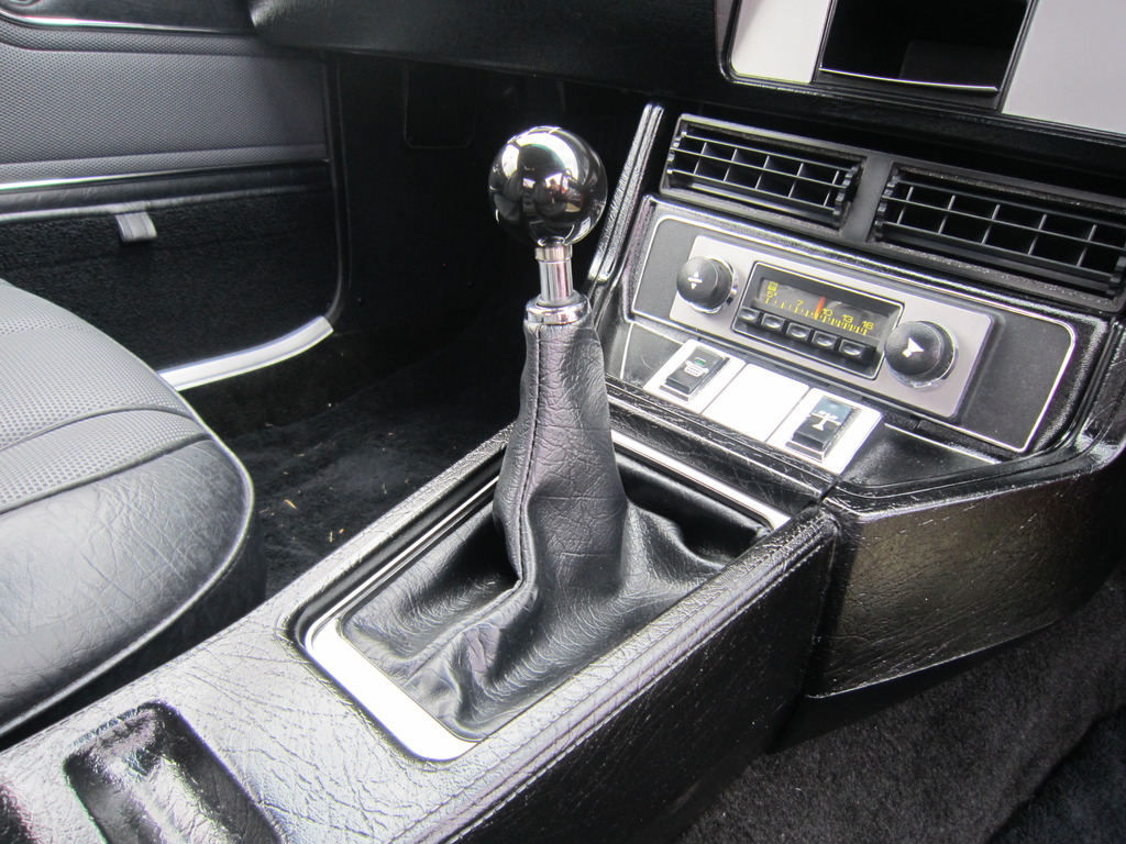

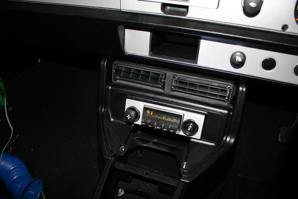

Here is a photo in-situ at its natural position before needing to be pushed forward under the vents and funny thing is that even then it sits a tad high at the back where it bolts in:
It should slot this far per this exemplar from TF in 2013:
The console came out of another car (I bought it on Ebay) and so goodness know's its history - my car was a mess when it came to me - easier to write a list of what came with than not.
Having said that, it is a very tidy and intact console and so I do not expect anything to have been moved because of repairs and whatnot at some stage, but you make a valid point - maybe it is not the heater box and car but the console to start with.
And the heater box was put in ages ago before anything else by me - it had nothing to snag on but to be sure, my cursory look just now reflects the same.
Cheers, TB

In the pictures posted it looks like vent on yours is sitting a little low compared to the bottom of the dash as compared to
the second picture, but could be just camera angle/lighting?
