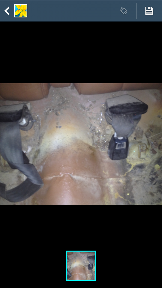

Hi all.
I have had a bloke who owns a hatch in Melbourne send me some pictures of his rear floor.
It won't take the banjo diff and is fitted with a small Salisbury diff.
I think the car may have been stolen at some point in time and rebithed as a 4 cylinder sunbird.
Can others who know look at the pictures he has sent me give me their thoughts please.
If you have negative bullshit I don't want to know so please kepp it to yourself.

Radious at edge of infill section. Looks close to a9x but its been a long time since I looked at one. Radious looks a bit small thought it was bigger from memory.
Current diff in the car is a uc small Salisbury diff.

May be wrong but Im thinking rear cut and shut with a couple of those pics

Would like to know what b8s is. Blister looks correct for a9x from what I can see in the pics. Is anyone in Melbourne who knows exactly what to look for with knowledge of a9x body shells interested in going to look at it?
Agree. This join in the floor under the rear seat doesn't look factory.

That would be typical of an insurance company back in the day.
Supply the back half of a rooted A9X to repair a sunbudgie.
