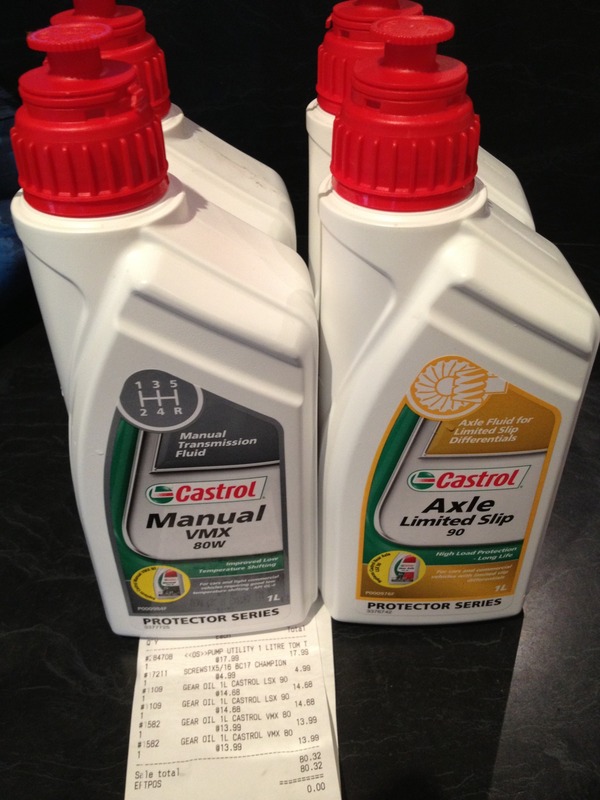

#6 hanra
Posted 24 December 2016 - 08:06 AM
Box n diff
C5A5142A-F09F-4DFB-B56C-F0BE60C6E362_zps

#9 LJ RB30
LJ RB30
  • 1,058 posts
  • Name:Trevor
  • Joined: 12-March 09
Posted 24 December 2016 - 12:42 PM
Box n diff
Reco'd the 3 speed in the Nanna Torana & put VMX in it cose i had some.
Was talking to an old mate a couple of days later about doin the box & using VMX.
His first comment was "GET THAT SHIT OUT OF IT!"
It will leak out of almost any gearbox! he said
Then i said that the box didnt leak before & its sealed up good so she"ll be right!
WRONG!! :cry: :cry:
It decided to leak out of the selector shafts & somewhere else that i cant remember now :banghead:
Old mate said he has seen many a good box leak with that shit in it but when you replace it with ANY oil other than VMX & of the same viscosity it magically cleared up!!
I put Castrol 80-90 in it now & shed floor is dry!
My 2 cent anyway

I have used the Castrol VMX for a long time in all the Toyota boxes in the various cars - steel case celica, w series supra and r series supra. None have ever leaked. Very nice shift feel too.
#11 LJ RB30
LJ RB30
  • 1,058 posts
  • Name:Trevor
Posted 24 December 2016 - 05:50 PM
Think its what i ran in the supra box too with no issue.
Aussie 3 spd didnt like it :angry:
Old mate hangs around vintage regularity guys & has seen issues with VMX
