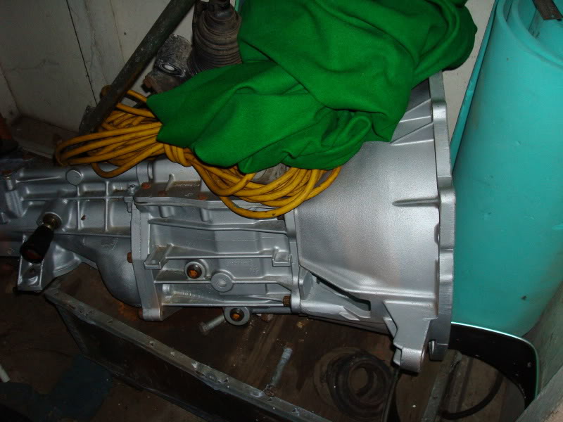

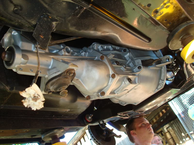

Quick trip to my gearbox guru for a complete rebuild & this is what returned.
We had to change the input shaft due to wear on the hard facing. Another stock Commodore input shaft was installed. I also sourced a rear extension housing from a XF Ford & had it fitted. It's a straight bolt on. This brought the gearshift about 40mm from the stock position & the speedo drive output is on the drivers side.
The main concern when fitting the T-5 is where the rear of the box ends up. It comes close to hitting on the floor x-member (under the front seat bolts) which is a structural member. Yes you can box this section in with steel plate but it is up to your engineer to pass the mod. By using the XF rear extension there is NO cutting of this x-member, which keeps even the most fussy engineer happy. :)
Here you can see where the rear extension sits. I had to fold down the lip slightly to get the threaded part through. Stupid short throw shifters!
Gearbox up & in.

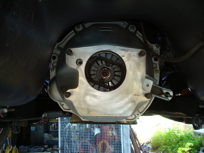

I should also mention that before i could fit the box, i Had to bolt the bell housing & clutch assembly in first.

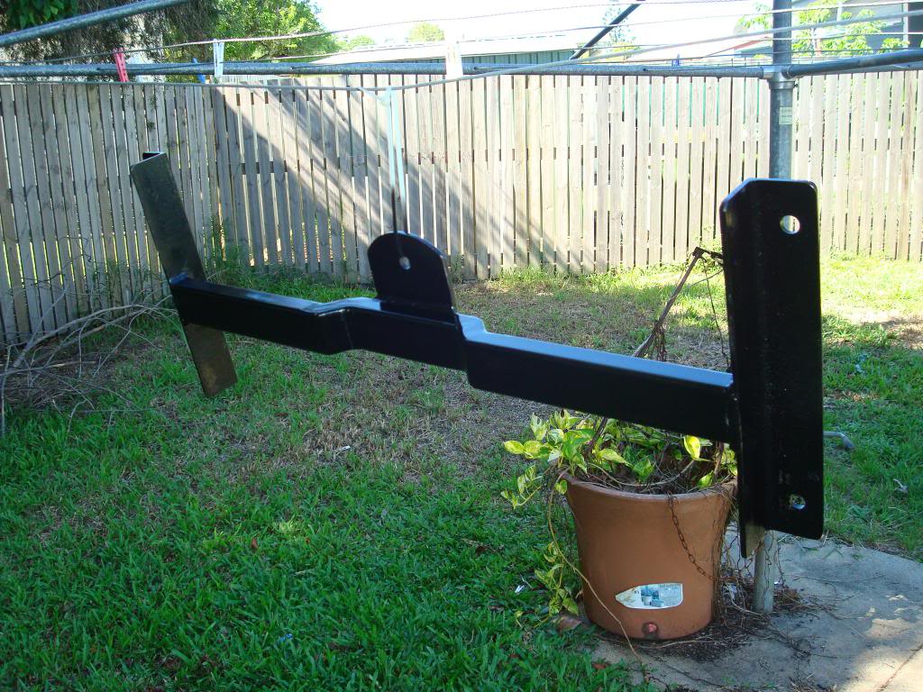

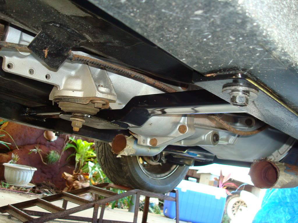

With the box in & bolted up it was time to move on to the the x-member.
A trip to the steel merchants & about $28 later i returned with some 40 x 40 x 4 angle & a meter of 50 x 25 RHS. Little bit of cutting, measuring, cutting, measuring, welding ....... did i say measuring? & a squirt with some black paint & ta da!
Using 40 x 4 angle i put the cross bar as high as i could. The 'drop' in the center worked out to 27mm. Because i am using the XF rear gearbox mount all that was required is a simple mount plate with 1 hole.

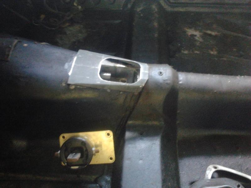

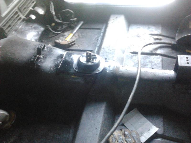

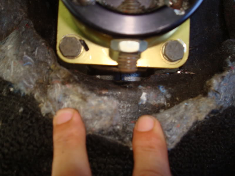

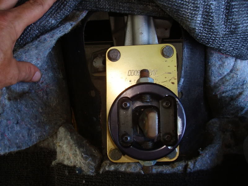

Now to fill the hole in the tunnel for the shifter.
Because i knew what seal i was using, i just made up a cover plate from 1.2mm zinc & welded it in. . It took maybe 3hrs from start to finish. I made certain that the console would still fit before welding anything.

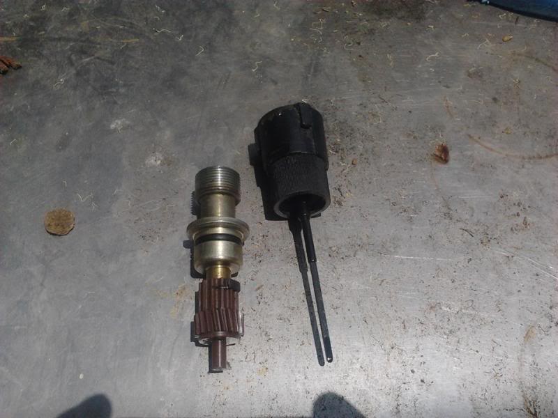

Next was the speedo.
The Commodore used an electronic speedo sensor at the gearbox end. I simply unscrewed the electronic bit but kept the mechanical drive parts.
Around $80 later & a brand new speedo cable arrived from Autocables. Screwed on 1 end & pushed on the other, the speedo works. You may need to play with the speedo gear to get your speedo reading accurately.
The only other 'modification' i made was a gearshift shaft which is 1" forward. I don't think this is necessary & i will swap it out for a straight shaft next time the console is out.
So there it is. Interior back in. 5 forward gears to play with & it didn't break the bank.
