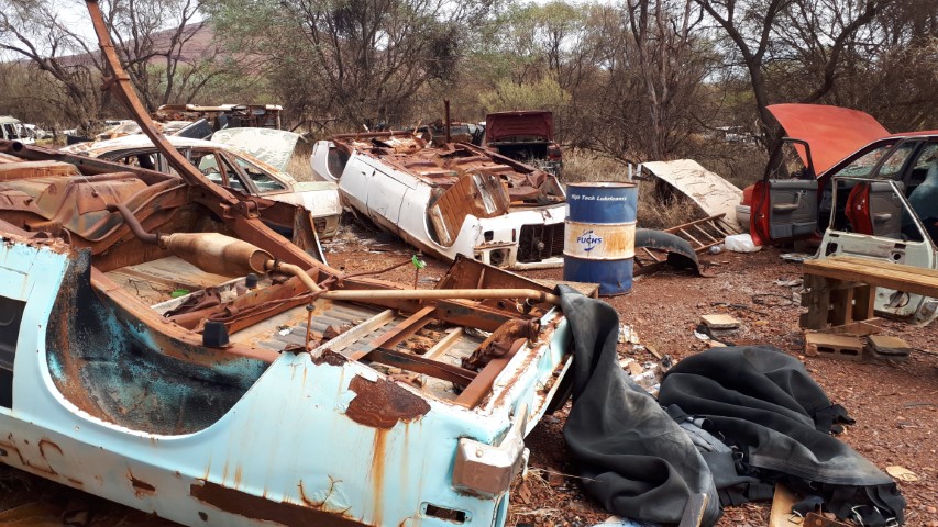

Where I work up north in Tom Price there was a spot just out of town that had a few old wrecks that was good for bits and pieces. Went out there the other day and after all these years the bloody Shire has decided to clean it up, NOOOOO!!!

Bugger, lots of good bits on those, even just nuts, bolts, clips etc. Or rust repair sections.

LOL... that muffler obviously saw a few "key-bangers" before it was retired...
