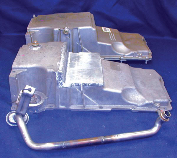

#22 ls2lxhatch
  • 5,335 posts
Posted 30 March 2007 - 10:01 PM
There are two options.
Sump from Castle Auto Elec, I have been waiting since Oct 06 for mine.
http://www.castleaut...igen3lhlxuc.php
https://cache.gmh-to...h/P1120585a.jpg
https://cache.gmh-to...h/P1120584a.jpg
https://cache.gmh-to...h/P1120580a.jpg
https://cache.gmh-to...h/P1120581a.jpg
Buy a Camaro sump and pickup for around $600 and modify it to suit Torana
http://www.eagleautoparts.com.au
This is a 2005 Camaro sump modified to suit a 68 Camaro. You would need to do something similar to this for the Torana.
https://cache.gmh-to.../CamaroSump.jpg
LS1LX modified a Camaro sump.
http://www.gmh-toran...showtopic=13315
