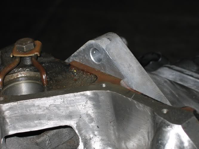

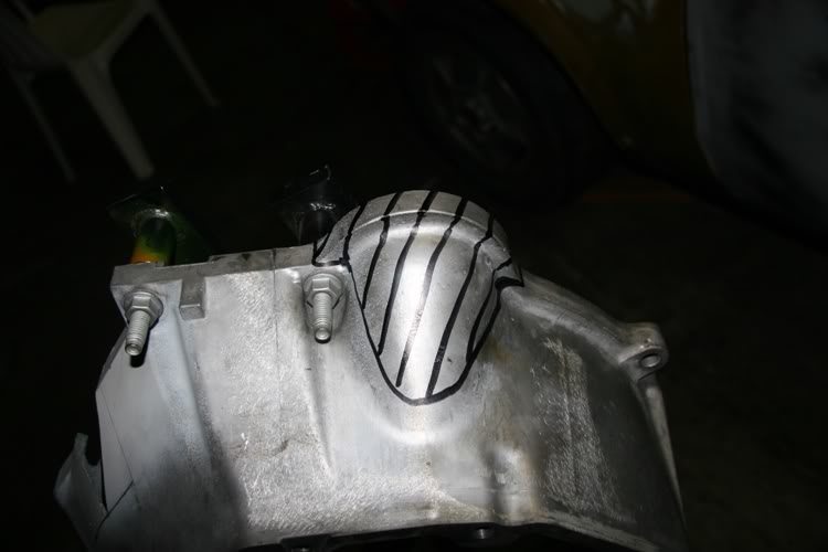

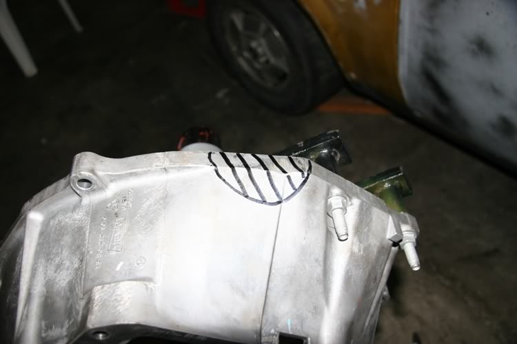

removed section of bell and replacement on the left (top rh hole)
bell sections from donor. these will be trimmed and used where other sections of the bell needs to be modified.
shaded sections which need mods. 1. the triangular wedge for the top rh hole, 2. removal of metal to accommodate the starter and 3, removal of existing starter 'hump', (this will allow more room for the exhaust)
1.
2.
3.
this is not a mod I would attempt if the bell was made of steel.

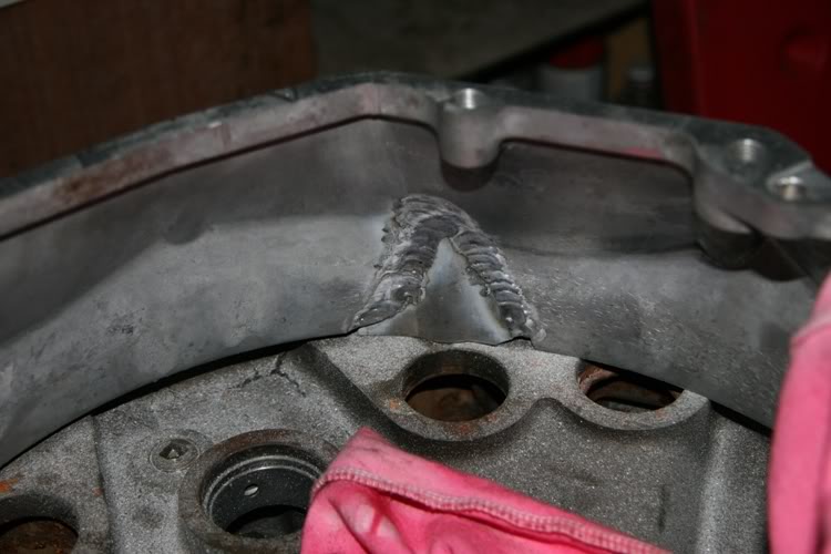

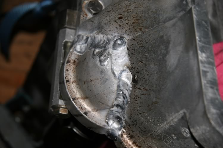

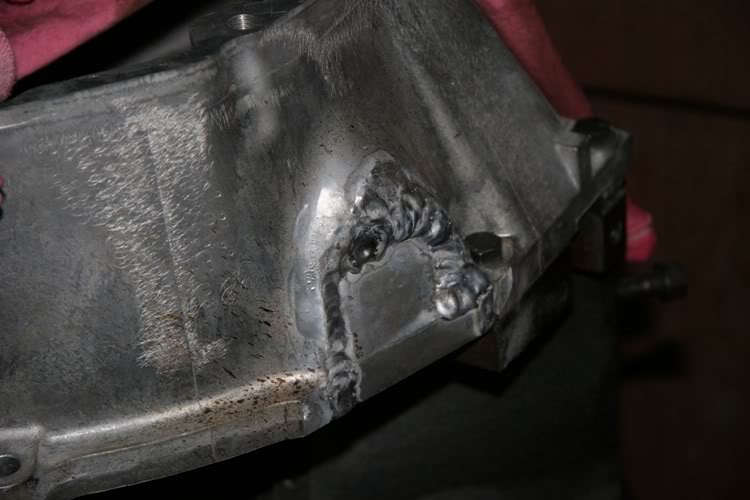

OK some more updates.
Here are the pics of the converted bell housing (90% done). Only need to 'clean' the welds, smooth the inside area around the starter and give the housing a lick of paint.
As you can see I have trial fitted to the block and it all lines up well.

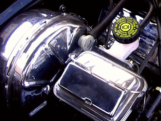

Unfortunately I don't have any detailed photos of the clutch setup in the cabin, just a few of the reservoir in the engine bay.
I'll try and get in contact with my mate who's looking after the car and see if he can take a few photos of the clutch setup.
