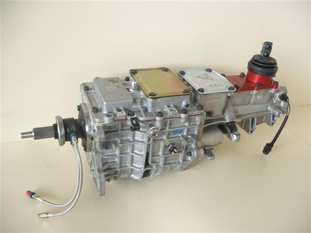

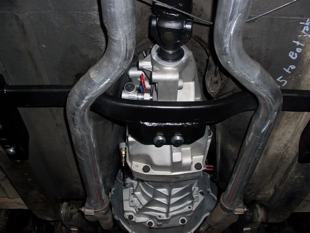

Maybe some pics of one installed courtesy of Mal Wood
Nothing to do with bellhousing though
Oh
And Mal has the correct bolt on bellhousing to suit too. If you haven't got a TIG and too much time on your hands
Those photos look familiar! That is my Torana that Mal Wood fitted the T56 to.

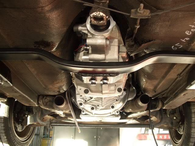

I like your pipes
Do they rub on the handbrake mechanism and cable ?
Good to see there not too much in the way of oil leaks and crap under there too
You need to keep a tidy underside. lol

I like your pipes
No, the handbrake mechanism & cable don't rub on the pipes. It does look a bit deceiving in the photo.
Yes, keeping a tidy underside is desirable! lol

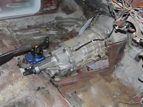

It won't fit without surgery
Infact... fet things will without surgery that will handle the LS1... cept maybe a TKO600 ... but thats a guess.. can't remember any behind a LS1
#37 _rob350hatch_
_rob350hatch_
Posted 18 July 2011 - 08:17 PM
surgery time.in fact you can just about make a canoe out of the amount of tunnel you will need to cut out.but it is possible and the replacement tunnel section wont look out of place.

#43 _LS1 Hatch_
_LS1 Hatch_
Posted 19 July 2011 - 01:12 AM
I raised the tunnel about an 1.5" (give or take, maybe less) and it's in there fine. I also still run the reverse lockout soleniod on the side (and the skip shift one too, all though I by-passed it in my wiring loom)
No rubbing or odd noises as well.
Just trying to get all these containers done and loaded now so I can get time to cruise around in the car some more, lol....
Oh, and forgot to say...I didn't raise the tunnel too much as in the fact I still run the factory console as well (slightly modified on the bottom is all)

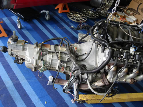

#47 _LS1 Hatch_
_LS1 Hatch_
Posted 22 July 2011 - 12:29 PM
Here is what mine looked like way back when...

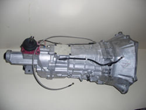

#48 ls2lxhatch
  • 5,335 posts
Posted 22 July 2011 - 04:40 PM
To make it easy to compare
Commodore T56
Posted Image Posted Image
Mal Wood modified T56
